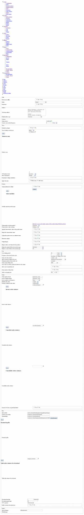

Sure, here it is. This is what I see when I open up Configuration - see the attachment.

I think that you have a PHP fatal error at the end of the page.
Please check your PHP error log.

I am sorry but you have a PHP error at the end of the page.
Your image does not contain anything of Joomla (the header, the menu, etc). So it means that something stop the processing of the page and the web server delivered what has been already processed.
So you see some incomplete content.
So, please check agin.
You can also change the "error reporting level" to "development" or "maximum" in your Joomla global configuration (tab "server").

Okay, solved, thanks! There was indeed a missing library.
