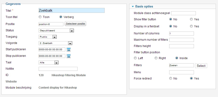

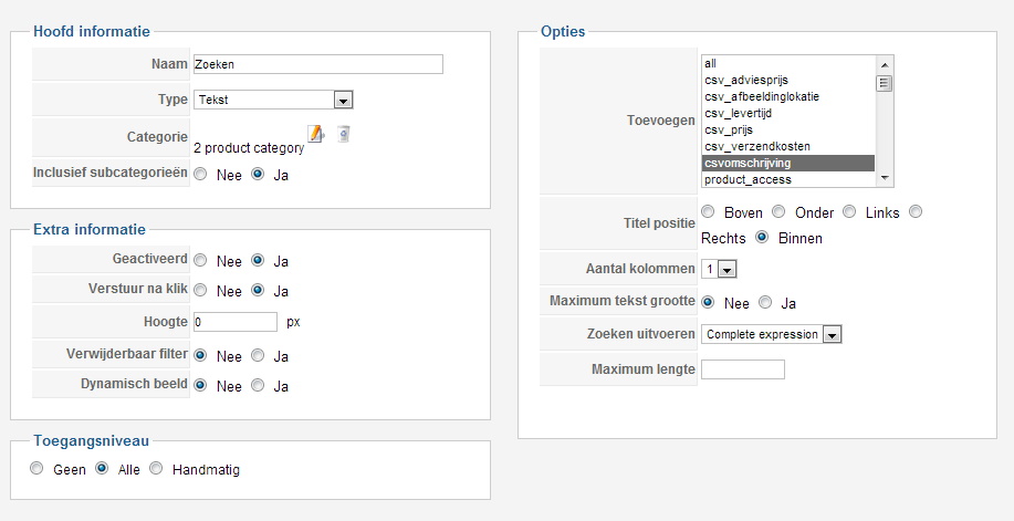

12 years 7 months ago #139809
Sure! One is the settings for the module and the other is the settings for the filter.

12 years 7 months ago #139848
Ok, and can you check that you have set some values through the "csvomschrijving" field of your products, and then use your filter by searching one of your "csvomschrijving"" product field value ?

  • Posts: 86095
  • Thank you received: 14199
12 years 7 months ago #139986
The issue is not with your filter but with the "menu" option of your filter module. On your first website, you have the id of a menu item of the type hikashop products listing which is configured to display all the products by default. On your second website, you have 0. So it goes to a products listing which doesn't display any products by default because it doesn't have any settings attached to it.
