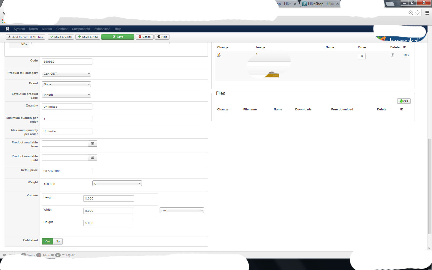

You need to add the weight and dimensions to your products of course and in the plugin options, you need to fill the information of your warehouse on top of the merchant id That's all.

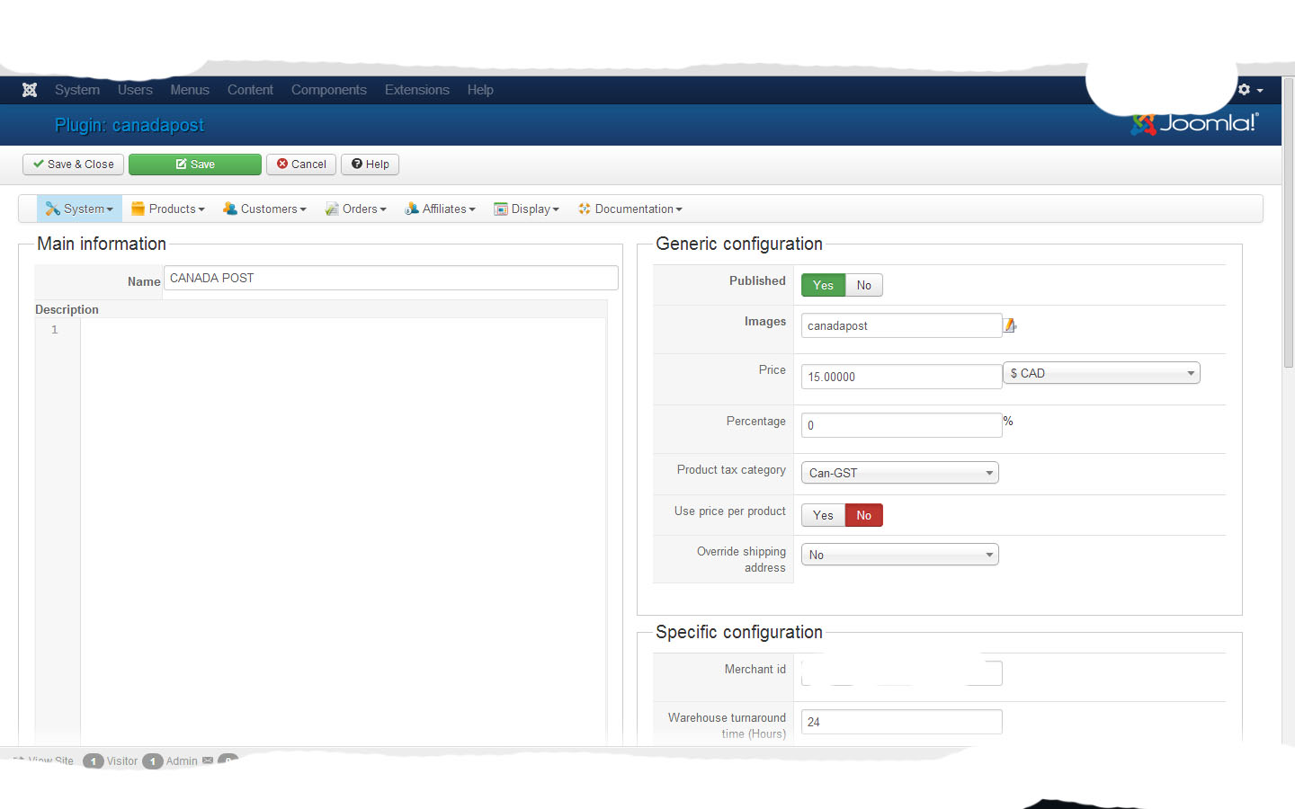

12 years 7 months ago #140768

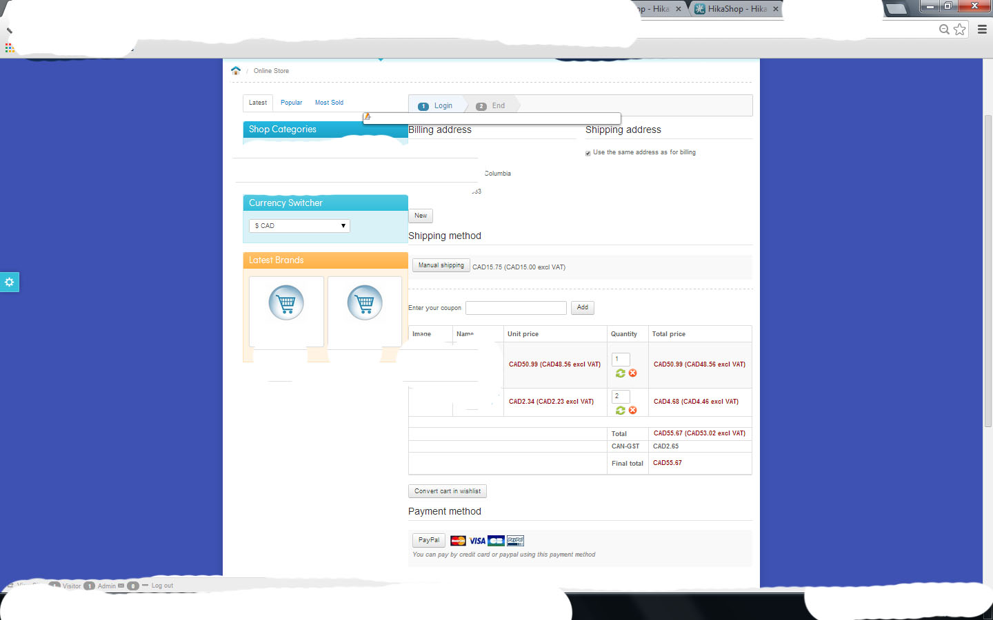

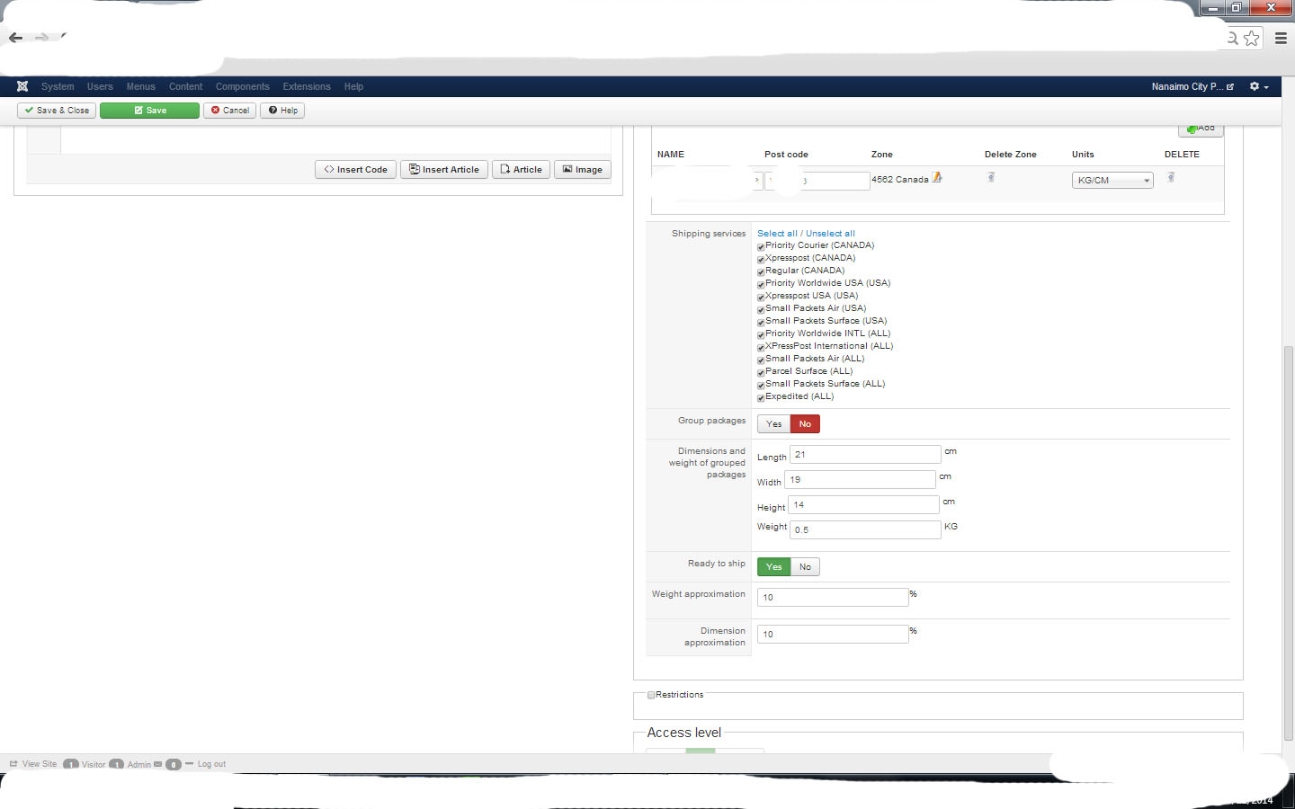

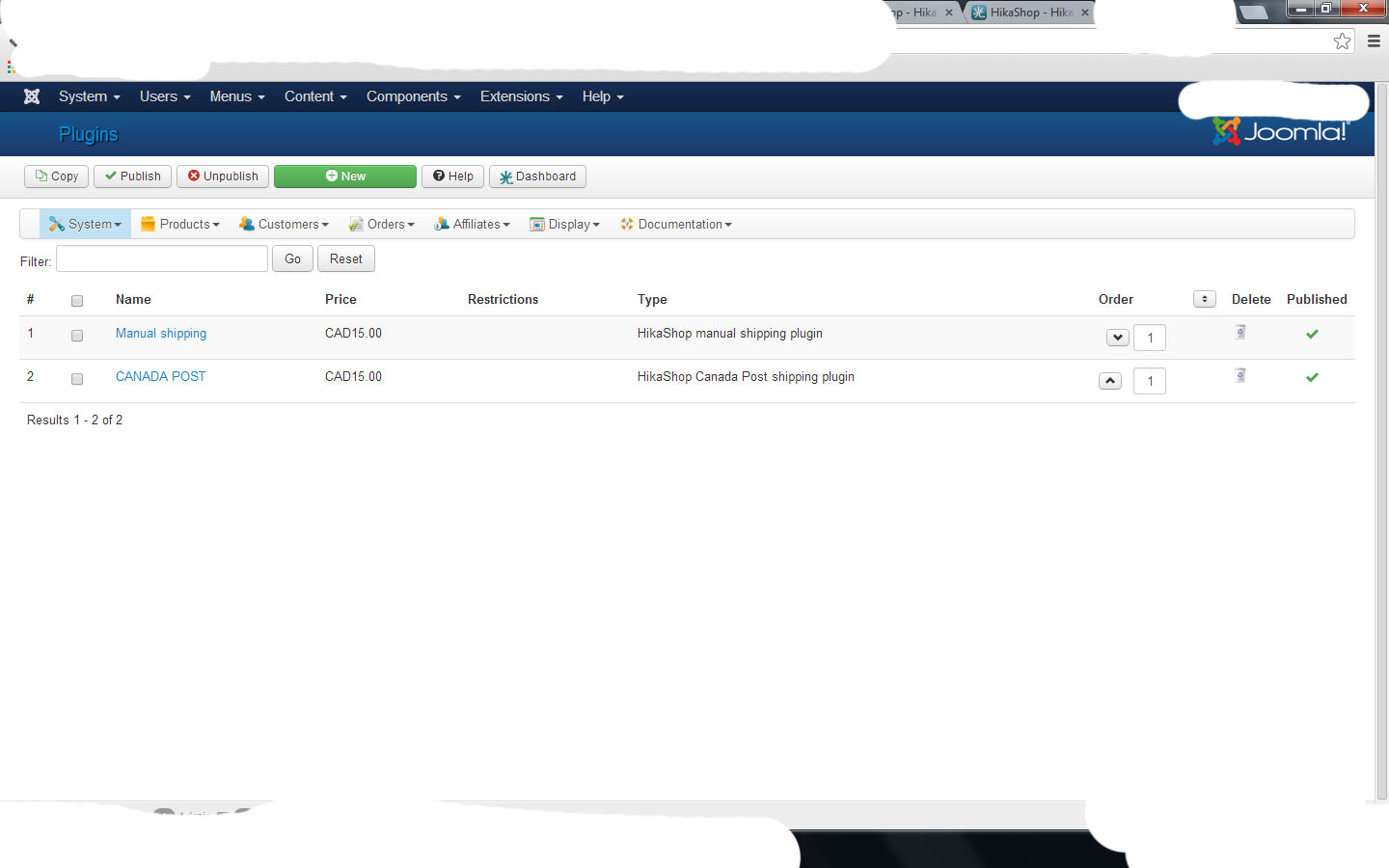

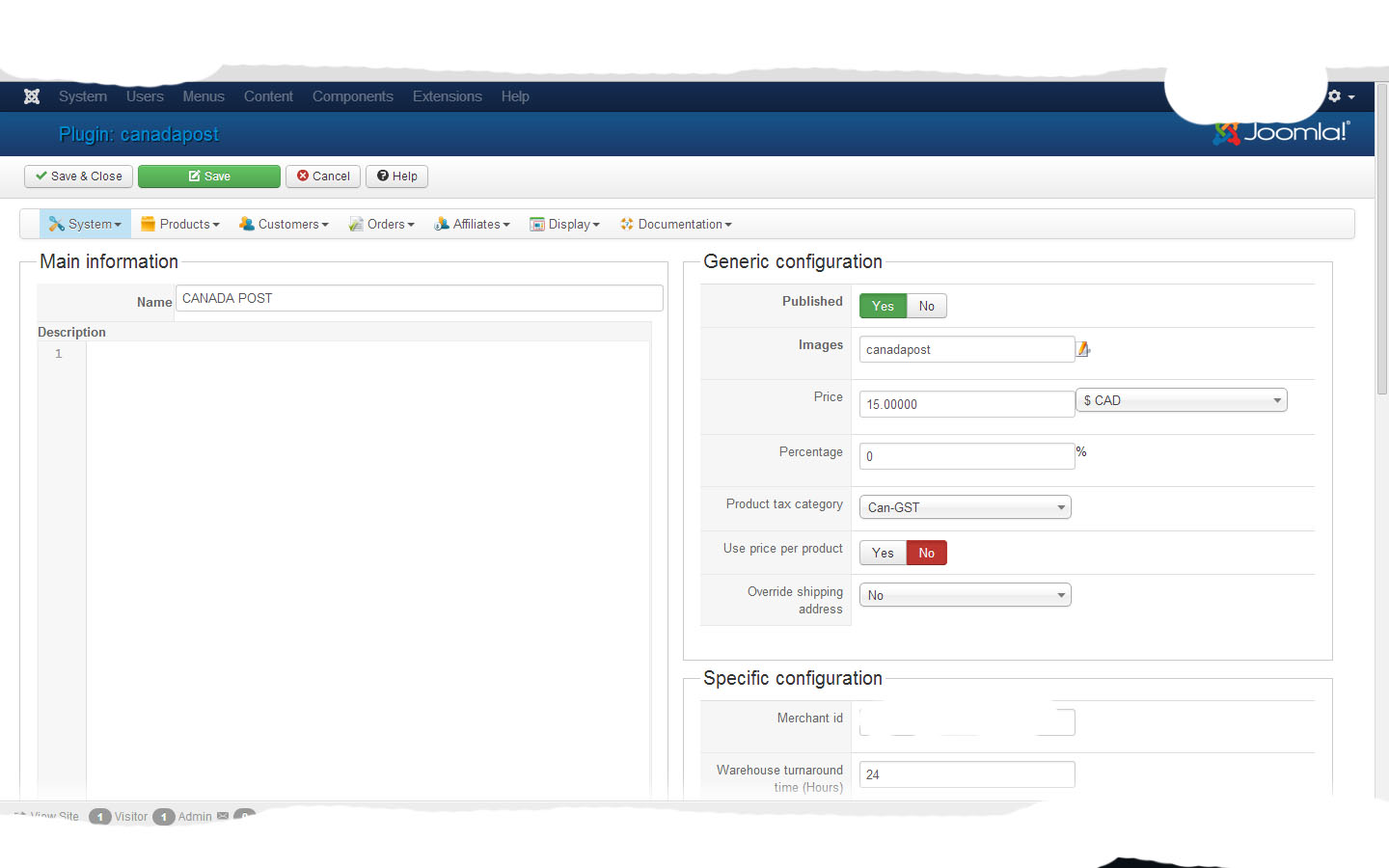

Ok, then can you look at these screenshots and help figure-out what i am doing wrong!! Non of your documentation is really helpful!! I have wasted lots of time with it.
  • Posts: 86095
  • Thank you received: 14199
12 years 7 months ago #140772
You settings look fine.
Disable the manual shipping method. That way you will see the error of the canada post plugin telling you why it can't get the canada post shipping methods on the checkout.
The following user(s) said Thank You: eliberts
  • Posts: 16
12 years 7 months ago #140778
It works like a charm!! :) Thanks. It wasn't recognizing my warehouse!
