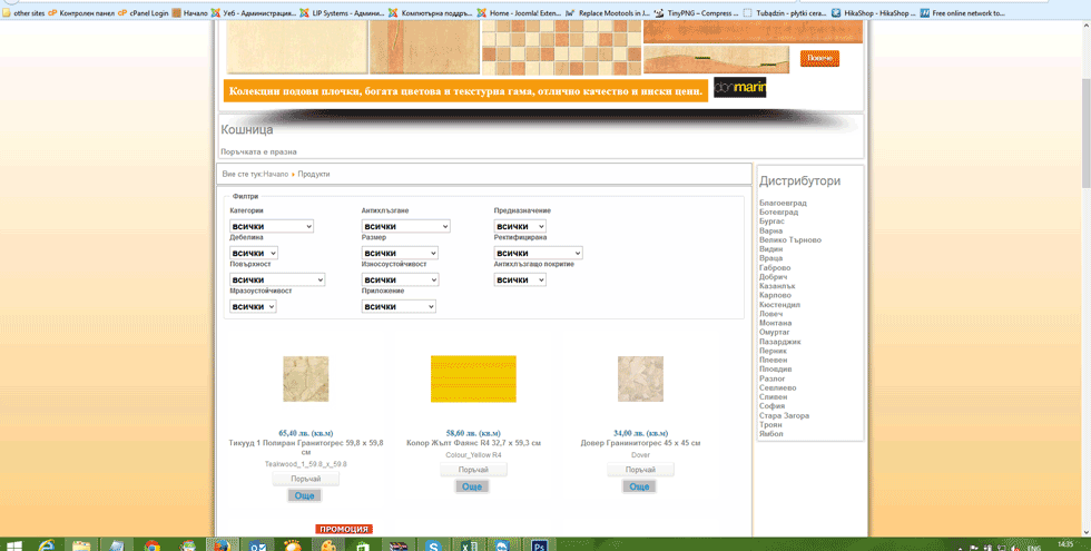

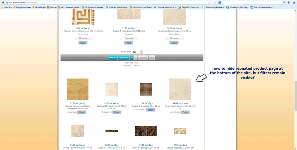

Hi, I have the following case: how to hide repeated product page at the bottom of the site, but filters remain visible?
test.donmarin.com/products.html
Last edit: 12 years 4 months ago by LIP Trade.
  • Posts: 86094
  • Thank you received: 14198
12 years 4 months ago #152700
This is a products listing module which is displayed at the bottom by Joomla. It has nothing to do with the filters. Go in the Joomla Modules manager and disable that module (id 99) and that should do it.
The following user(s) said Thank You: LIP Trade
