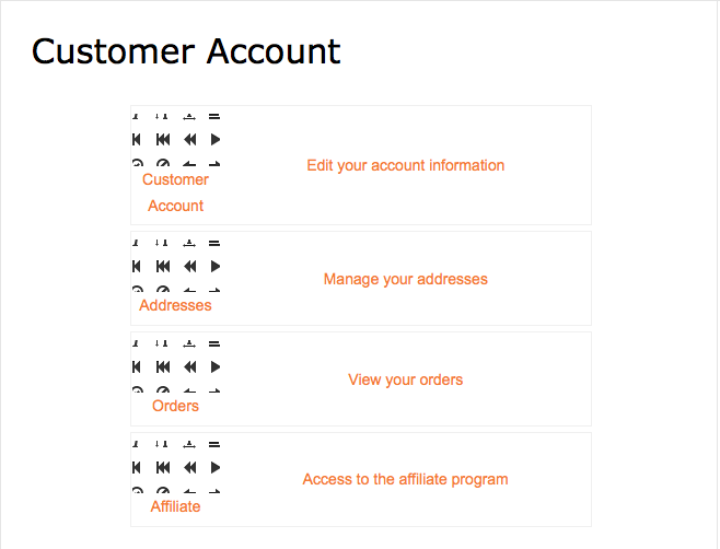

After upgrading from Joomla 2.5.17 to Joomla 3.2.1
My user control panel icons went funny. see attached.
I am not sure what might have caused this.
I have checked and the images are still in the same location.
Please help.

This comes from your template's CSS. Please follow the instructions here and that will solve the problem:
www.hikashop.com/forum/install-update/86...er-panel.html#141117
