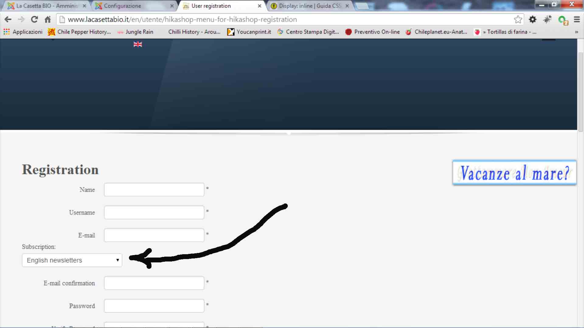

The first one is on the registration user form (screenshot 1):
the Subscription is out position. I use the "AcyMailing : (auto)Subscribe during Joomla registration".
I had no issue like that before bootstrap.

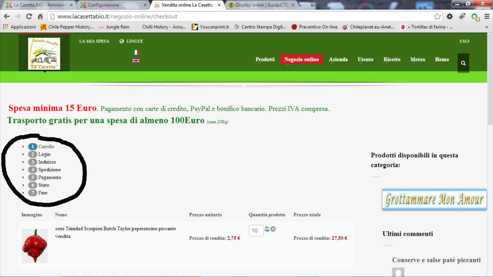

the second one is the breadcrumb. (screenshot 2):
it is vertical and i had it horizontal before bootstrap.

The first point is generated by the Acymailing plugin. You have to active the bootstrap design in Acymailing too :)
For the second point I think that you have a customize CSS file. Our CSS file include the rules to display the new checkout bar.
If you use a custom CSS before the HikaShop update, you don't have the new CSS rules so you don't have the part for this.
You can look at "hikashop_wizardbar" in the original CSS file.

second point: yes i have a custom css file. I tried copying all the code "Hikashop_wizardbar"
[from the original to custom.
Now it seems to work.

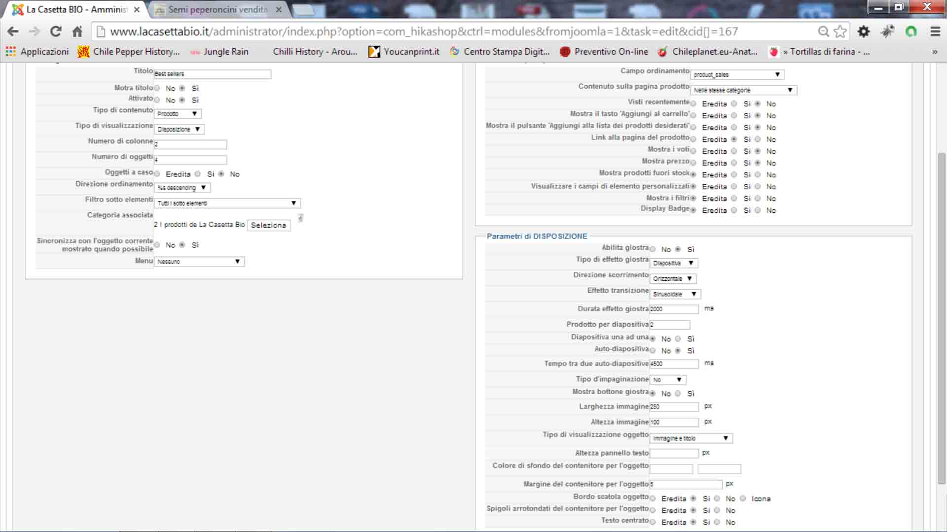

Now the issue is the Bestseller carousel.
You can see the bestseller issue here:
www.lacasettabio.it/en/negozio-online/salse-e-conserve-piccanti

Interesting!
Could you give us a screenshot of your module configuration so we can visualize what it should look like?
Also, does it work with bootstrap disabled?

From what I can see the carousel is ok. What's messed up is the page navigation with the page numbers.
You can fix it with this css:
.pagenav:before, .pagenav:after {
    display: inline;
We'll look at it on our side.

Then try:
    display: inline !important;

now it is horizontal.
but what is that pagination?
I did not have it before

12 years 6 months ago #142710
It's the pagination of the product listing, it has nothing to do with the carousel.
You can disable it in System>Configuration>Display.

done!
It wasn't on the module.
It was on system>configuration>display>general display option
So
