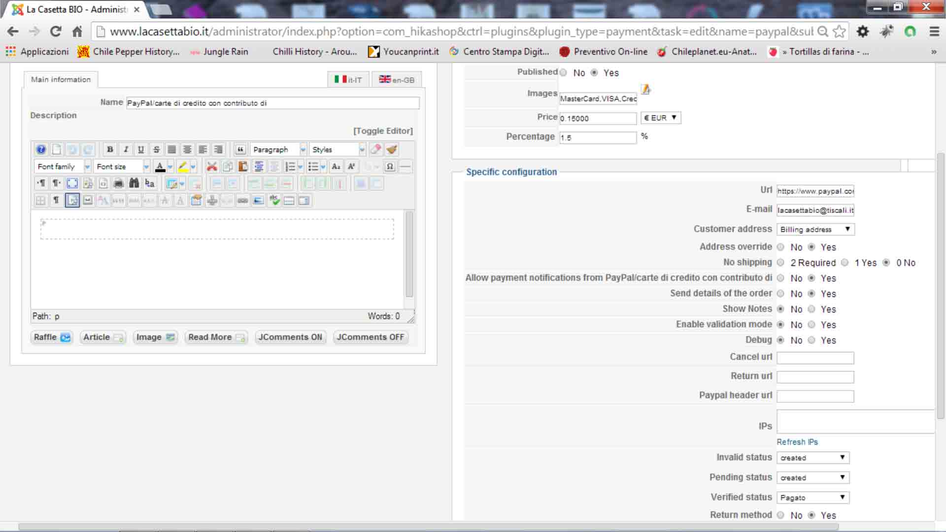

12 years 6 months ago #142871
You should probably set the "Send details of the order" option of your Paypal payment method to YES.
  • Posts: 719

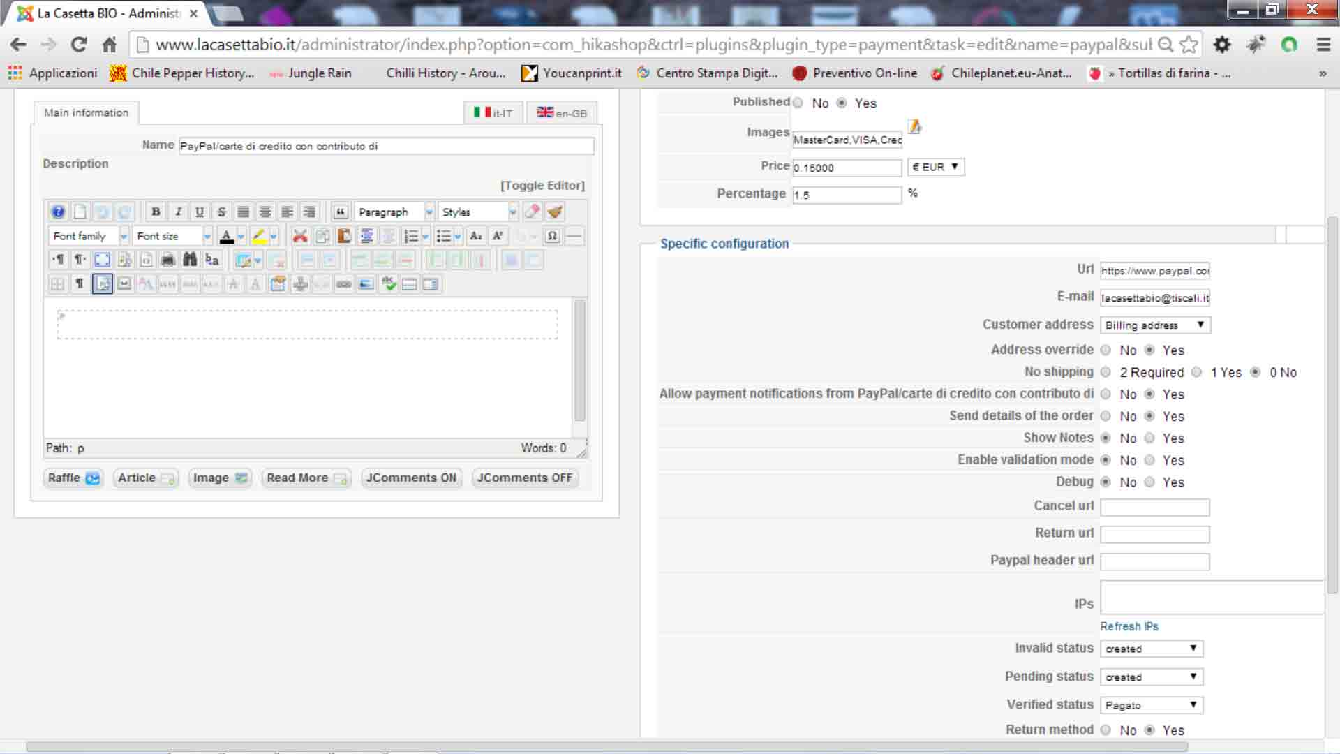

12 years 6 months ago #142891
no, it is correct.
Here my configuration
my site with Hikashop
www.lacasettabio.it
Last edit: 12 years 6 months ago by lacasetta.

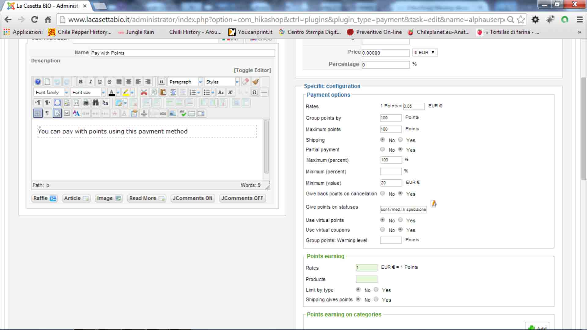

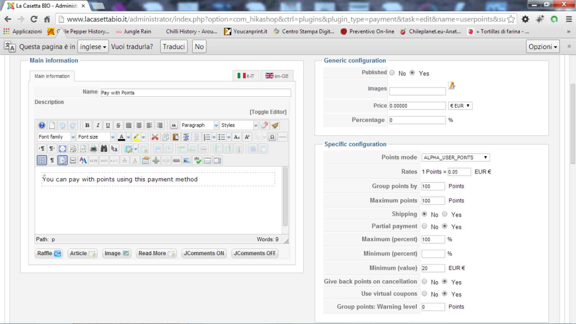

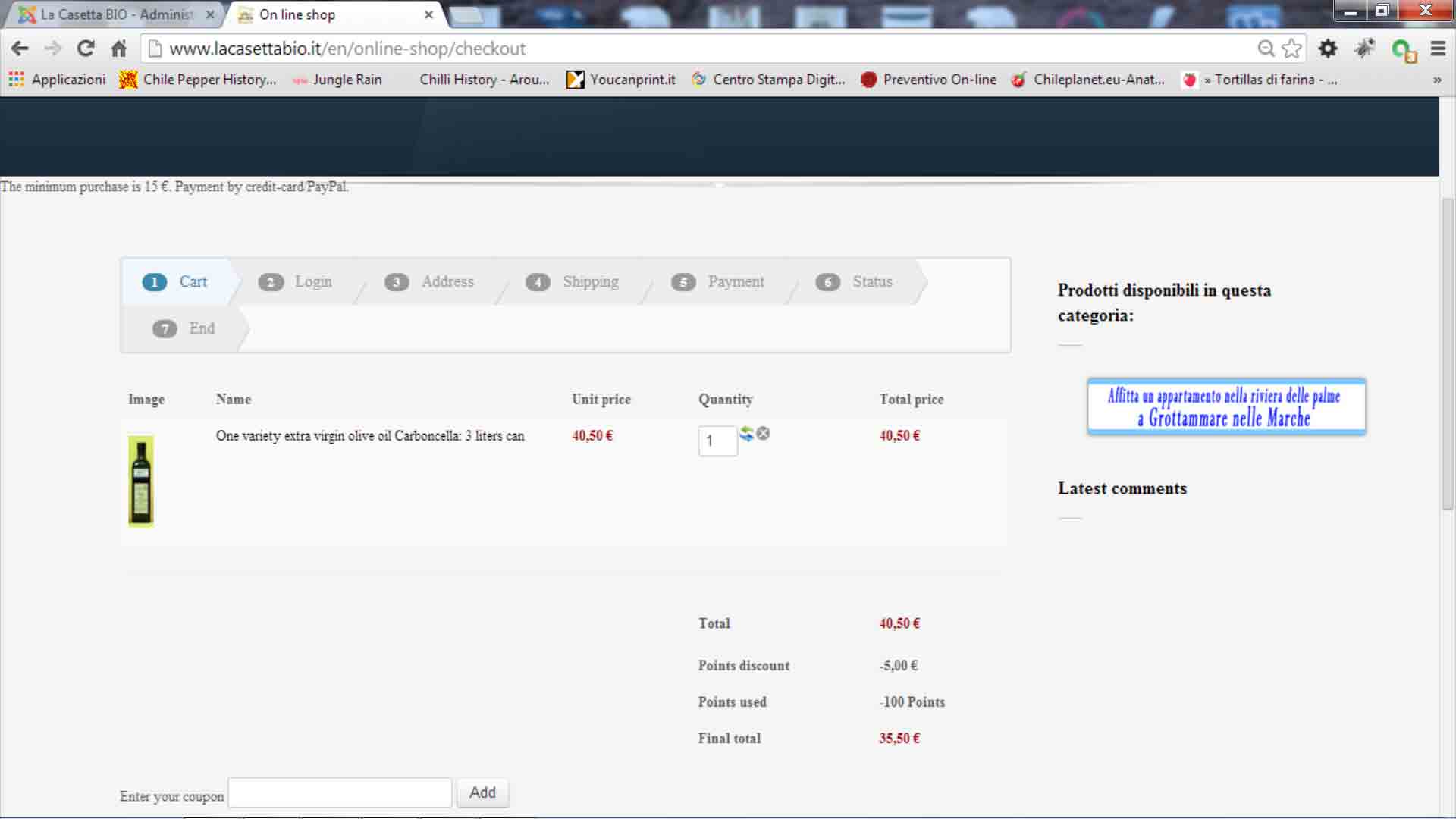

  • Posts: 719
12 years 6 months ago #142951
i use the plugin type " Hikashop AlphaUserPoints Plugin" called "Pay with points".
You can see it on my screenshot1
On the checkout cart it is like on screenshot2
For a good shop it is very important manage the real amount with the PayPal payment; otherwise the customer give up the order and the onlineshop for ever.
So, how can we fix that?
www.lacasettabio.it

  • Posts: 719
12 years 6 months ago #143021
Obviously i can not disable the AUP plugin.
What happen if i turn off the "send order details"?
I mean what the customer will see on Paypal?
www.lacasettabio.it
  • Posts: 86095
  • Thank you received: 14199
12 years 6 months ago #143024
I'm not saying that you should disable the AUP plugin. I'm saying that you could turn off the "virtual coupon" of the AUP plugin. That doesn't means that you won't get the points to work, it just mean that it will display differently.
If you turn off the send order details option of the paypal plugin, you won't get the details of the order sent to PayPal, just the total of the order, so the customer will see the total of the order on PayPal.

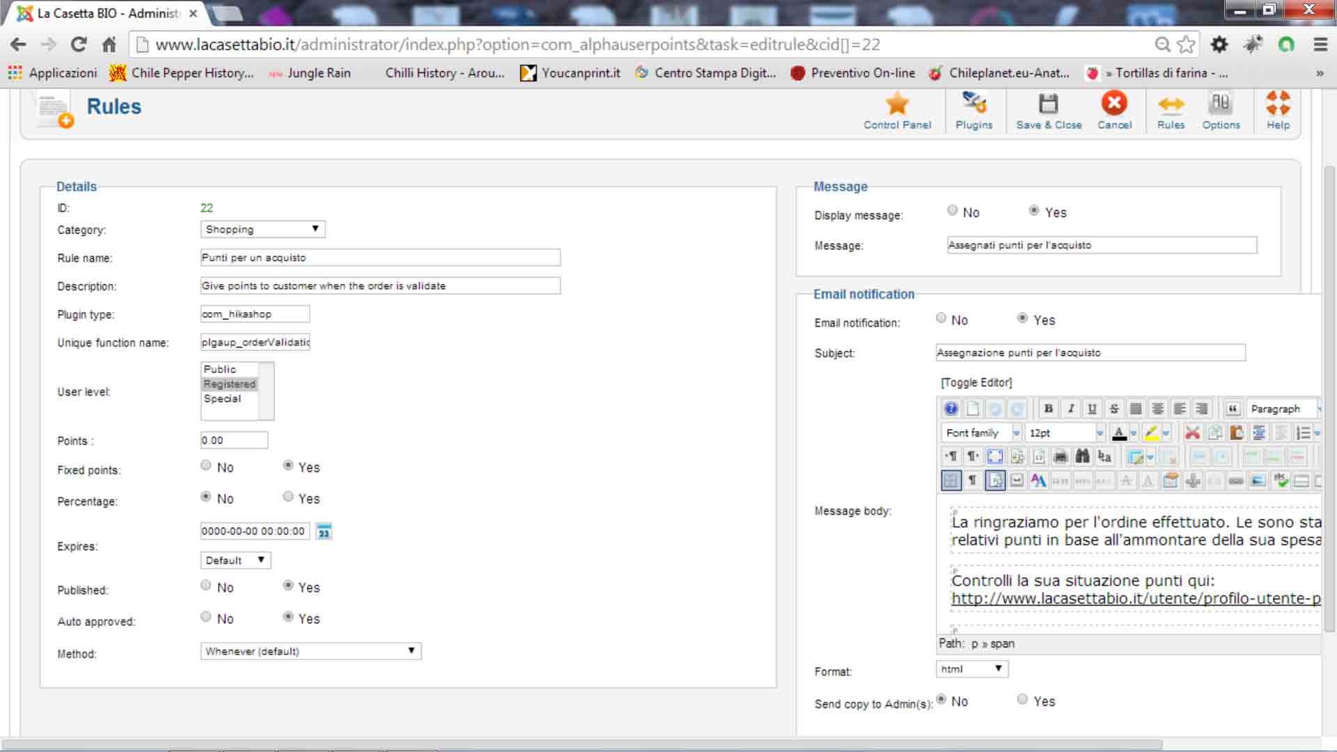

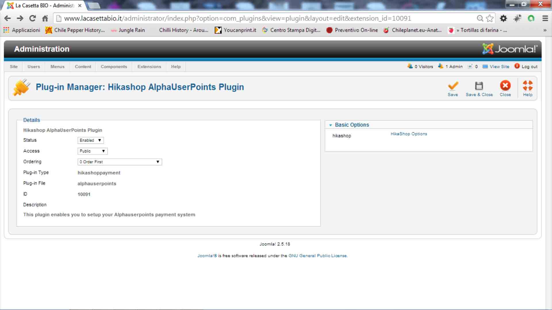

  • Posts: 719
12 years 6 months ago #143374
I'm sorry but I do not understand anything anymore.
so i have:
the rule on AUP (screenshot1)
the pay with points plugin (screenshot2)
the AUP plugin (screenshot3)
Then i have all the 3 enable.
Is there another one plugin?
If not which one is deprecate and i have to disable?
www.lacasettabio.it
  • Posts: 86095
12 years 6 months ago #143527
The "pay with points" and AUP plugin screenshots are the same plugin which is deprecated.
Instead of that plugin, there are two new plugins called "hikashop user points" and "hikashop user points payment plugin". The first one is to give points to the users, the second is to have them use their points.
The first one can be configured in the joomla plugins manager and the second via the menu System>Payment methods.

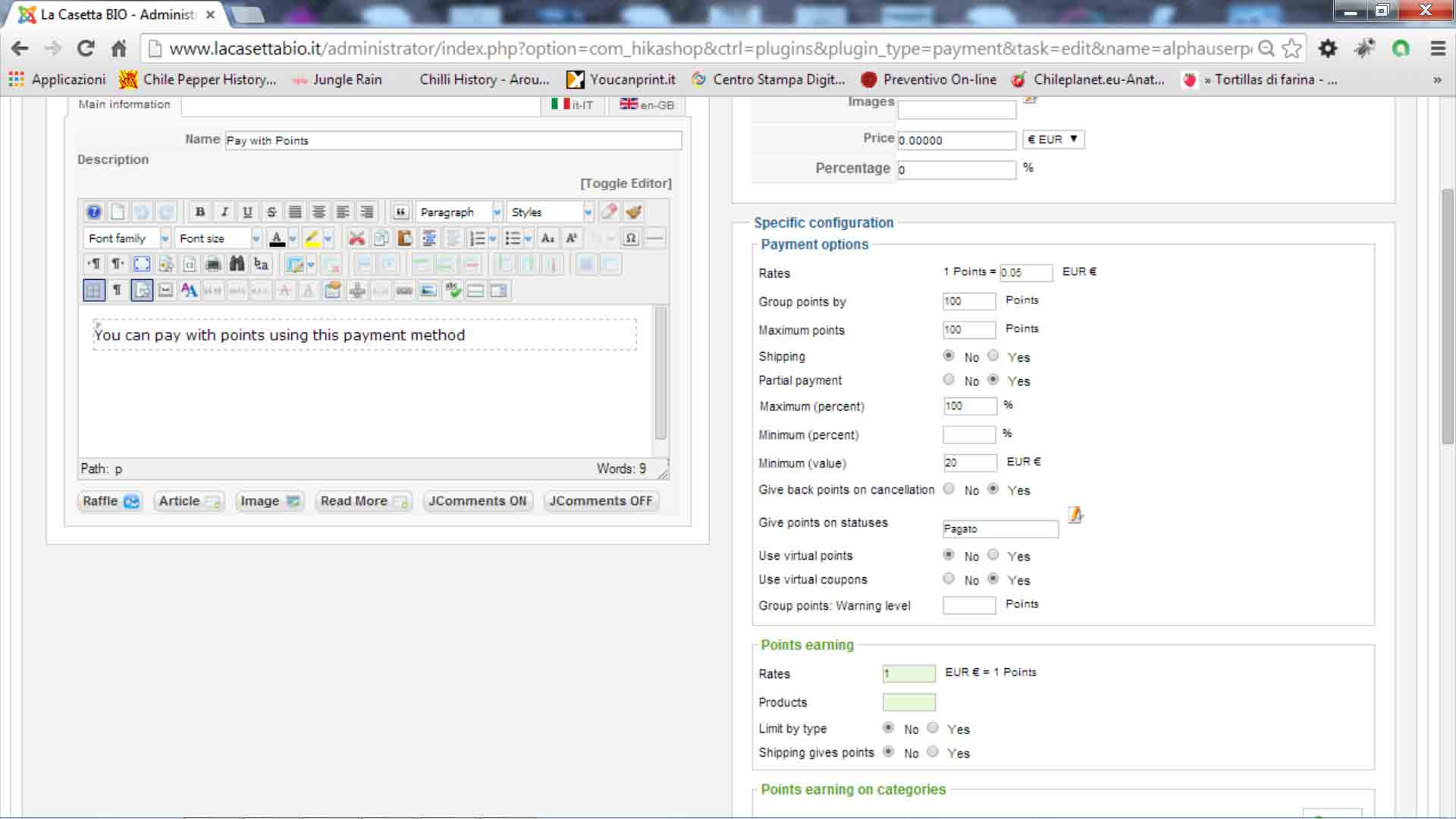

  • Posts: 719
12 years 6 months ago #143787
1 to have a virtual discout of 5 Euro every 100 points i set group points by=100 and maximum points=100. It works. But every value i set on G.P. Waring level i have always the same warning message. So i don't understand what is its use.
2 here you are the screenshot. It the same for issue n.1
www.lacasettabio.it
