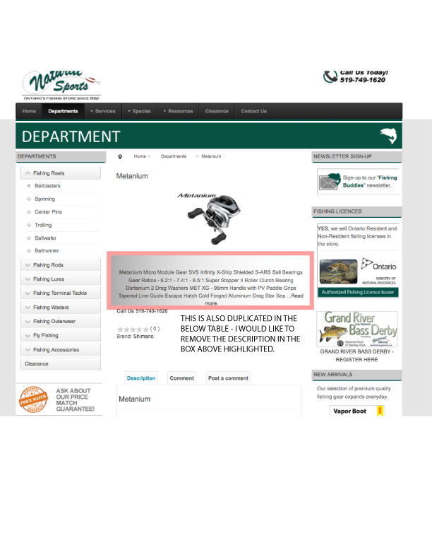

Hello Hikashop! Hope all is well.
I searched the topics on how to remove the description but it appears what I want is slightly different.
How do I remove the short "product description and read more"; when displaying in tables. This description is already in the tabs below.

You can add that CSS on your pages:
.hikashop_product_description_main_mini{display:none;}

Okay so the page is naturalsports.ca/natural-sports-fishing-...ct/184-metanium.html
the attached shows the description I would like removed. It is duplicated in the table below the product image and I prefer only have the description in the table - not directly under the product picture.
thanks

I just tested the CSS code that Nicolas gave you, and it's working fine, so you should follow that tutorial to add this CSS code :
.hikashop_product_description_main_mini {
display: none;
