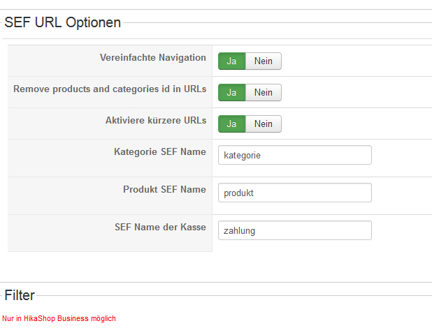

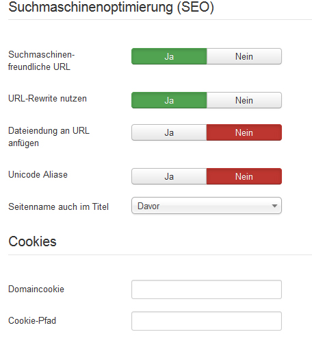

12 years 6 months ago #144283
I don't know why your tests were ok but I can assure you that it doesn't work here. It's enough to have it in the title, if it was in the alias i could understand it yet. I tried it again and immediately after I use an ä,ö,ü the page is empty and a message "Product not found" is displayed.
But you can convince yourself at link
Attached are also the two screens from the settings.

12 years 6 months ago #144432
I see that you turned on the option to remove the ids in the URLs. That's why you get that error and not because of the update.
The SEF system of Joomla doesn't store the correspondence between the non SEF and the SEFed URLs when it generates the SEFed URL. Because of that, it has to dynamically recalculate the non SEF URL based on the SEFed URL.
If you remove the ids, the system bases itself on the name of the product/category in the URL.
But if the name in the URL is different from the name in the product, which is the case with special characters as they are transliterated by joomla's SEF, it's not possible anymore to retrieve the product from the name in the URL and that's why you get that error.
  • Posts: 86095
  • Thank you received: 14199
12 years 6 months ago #144433
A simple alternative is to fill the alias field with the exact name that you want in the URLs, without special characters and that will allow the system to recalculate the non SEF URL.
An alternative is to use something like sh404SEF which stores the correspondence of the URLs.
And finally the simplest solution is to keep the ids in the URLs.

Ok, I know what you mean but why is it working in 2.2.3? In 2.2.3 I use Joomla's Seo friendly url and in Hikashop only the option "simple navigation". Then after updating to 2.3.0 the product view (not the view with all different products) is completely empty. If I turn of Joomla's SEO friendly URL or enable all SEF options in Hikashop, the product view is displayed but in the latter case it doesn't work with special characters.
P.S Thanks for the hint and I turned off removing the ID's and it's working now.
