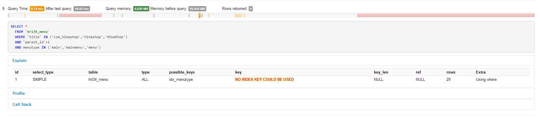

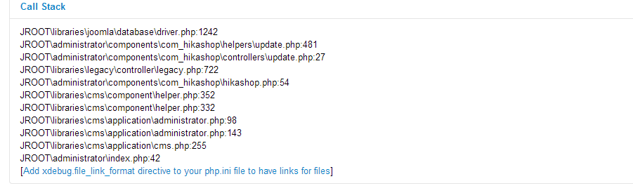

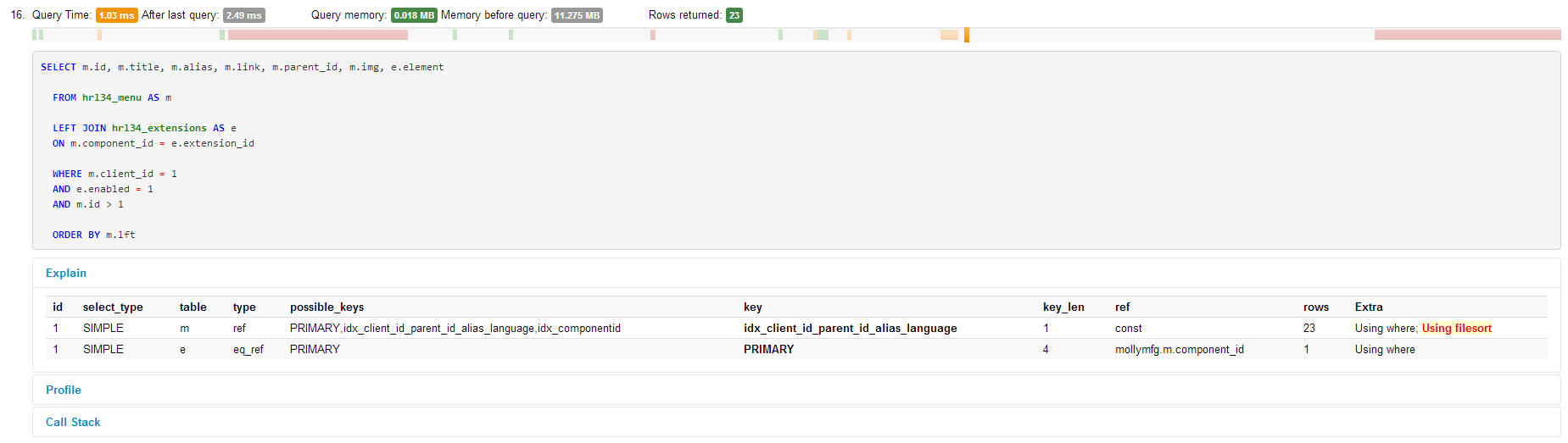

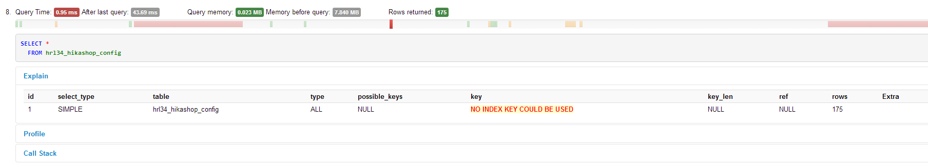

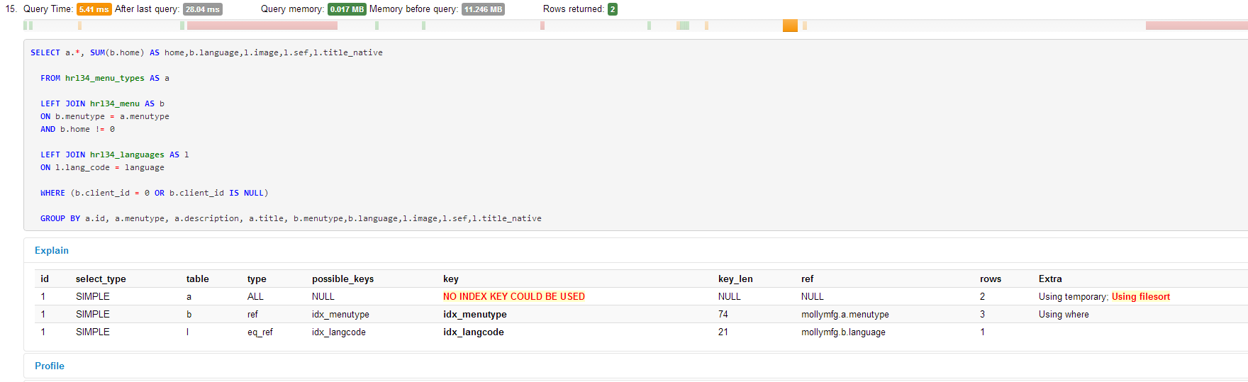

-- url of the page with the problem -- : localhost- Using WAAMP server- Apache 2.4.2- Mysql 5.5.24
-- Joomla version -- : 3.2.3
-- PHP version -- : 5.4.3
-- Browser(s) name and version -- : chrome, IE and Firefox
-- Error-message(debug-mod must be tuned on) -- : 1064 You have an error in your SQL syntax; check the manual that corresponds to your MySQL server version for the right syntax to use near '' at line 1 SQL=UPDATE `hrl34_menu` SET `rgt`=`rgt`-0 WHERE `rgt`>=
I have tried all installation options. i.e. Zip and tar with extension manager, temp directory and also "install from web".
Initially I was getting generic failure to install, but I changed php.ini settings to:
post_max_size = 750M
upload_max_filesize = 750M
max_execution_time = 300
and then I started getting the MySQL error.
Any help would be very much appreciated.

Your Joomla menu is currently broken.
Please use the "rebuilt tree" to rebuilt your Joomla menu.
This request might be executed by Joomla itself during the installation.
And I am sorry but, any of your screenshot help to understand the problem.
None of them are the query which creates the error so... It does not help us to help you.
