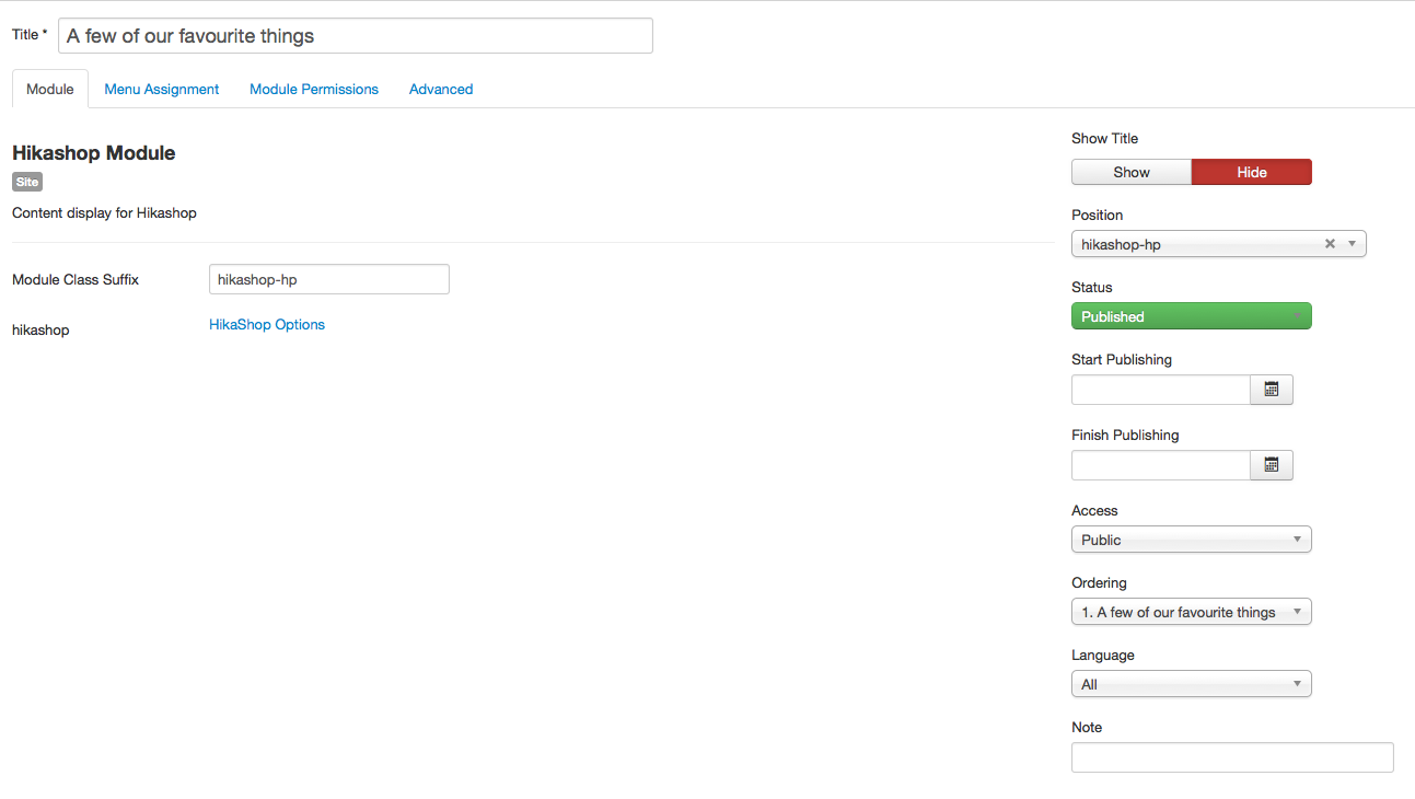

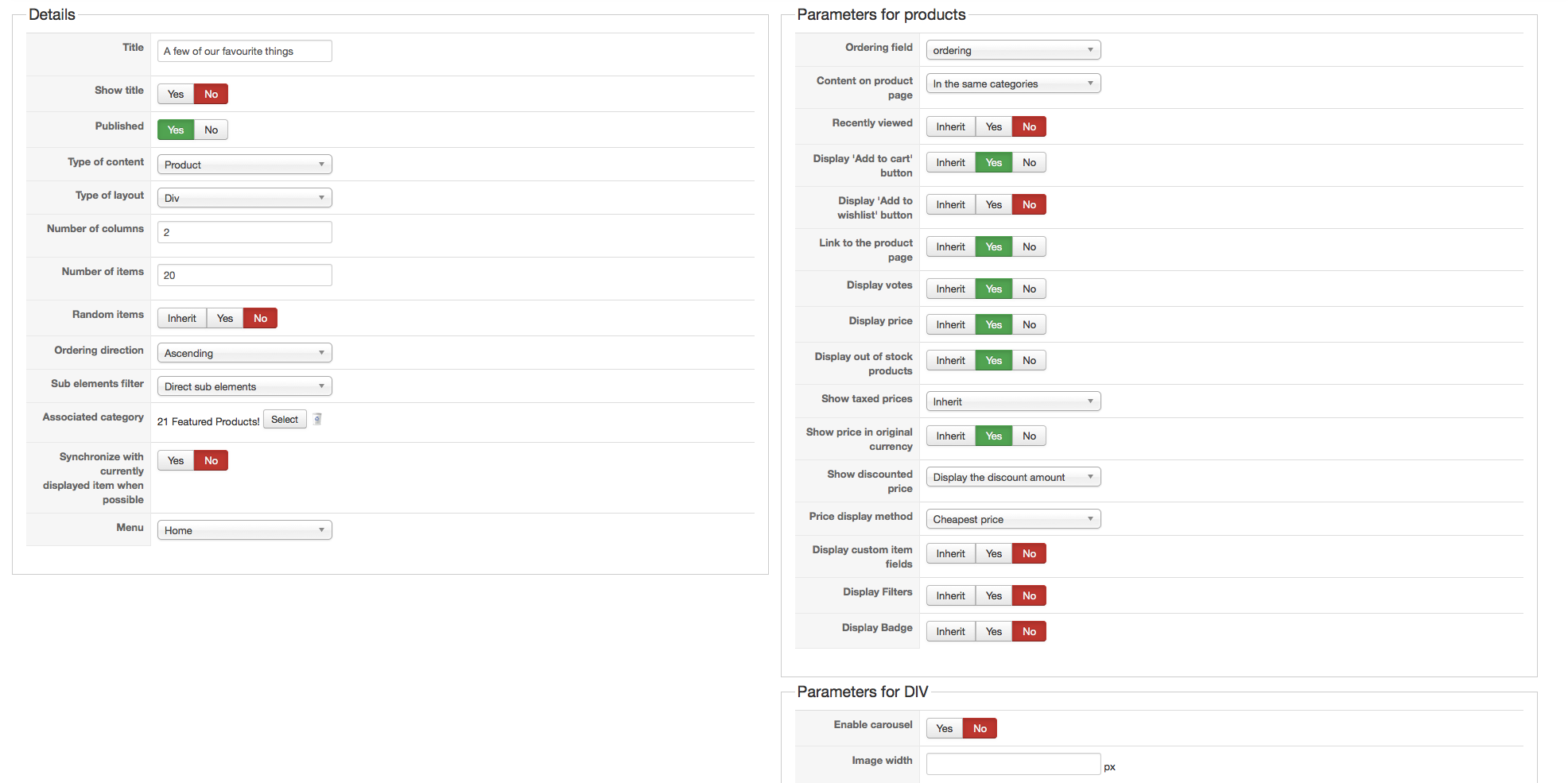

Thanks for a quick reply but I'm afraid I don't follow you, I don't seem to have the display options you described, please have a look at the below screen grabs with the joomla and hikashop settings of my module, any suggestions?

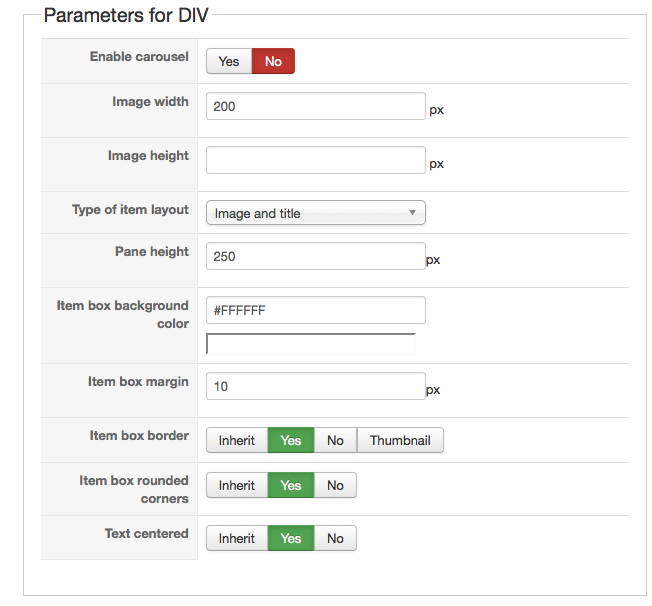

You'll just have to change the value of the "Type of item layout" option through the "Parameters for DIV" tab of your product listing content module configuration page.

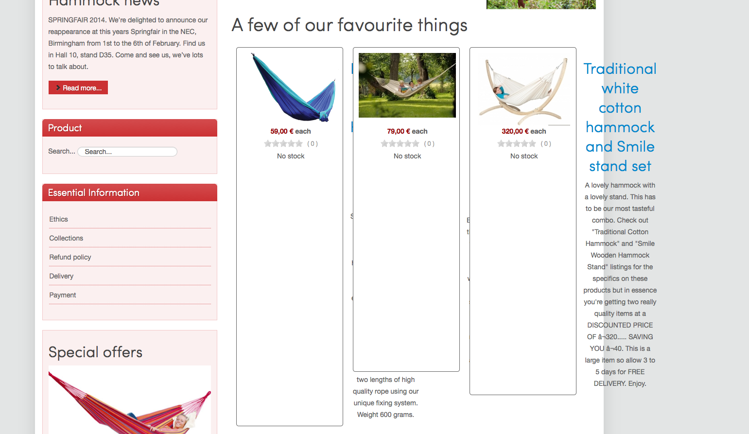

Actually not really because when I set it to display image and title it's still showing the short description too? If I change it to show the image and description the layout is completely broken, any ideas? See the grabscreen?

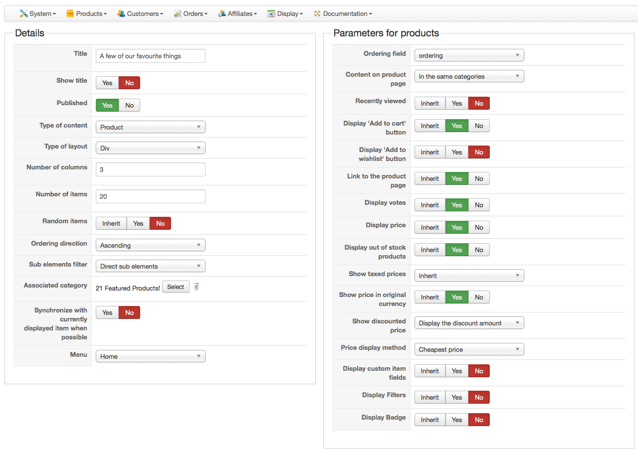

I didn't fix my issue, the layout you saw was set up to display the image only, and that worked fine, but I want to display the image plus the title, I changed it now for your information so you can see that it still displays the short description. I attached the screen grabs with the settings.

Just to let you know I changed the layout on one of the listing pages to show you additional problem:
hammocks.ie/hammocksUAT/index.php/hammocks layout "image & description"
layout is completely interrupted
hammocks.ie/hammocksUAT/ "image & title"
displaying description too
Thanks,
Kashka
