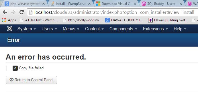

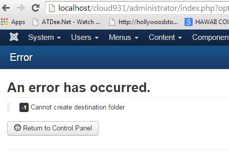

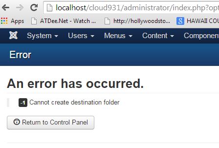

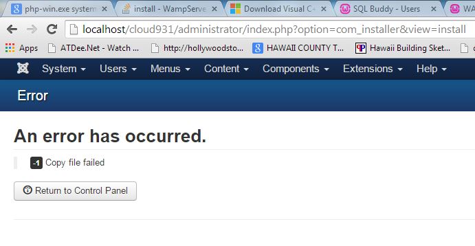

I have attempted to install the HikaShop 2.3.4 upgrade now to my website, after first moving it from GoDaddy to endurance International where I have more PHP error logging, there were no errors in the PHP log with timestamps associated to the failure.
I have then Migrated my website to a local host on WAMP, and attempted the upgrade on my own server, and still can't get it to work. However I can get more detail now that its on my own dedicated server, and still no errors in the PHP error log, or the Apache error log, and a different error in Joomla now visible when it crashes, see the attached. T

Please go in the Joomla "System" menu (just near the Joomla logo in your screenshot) and select.
System > System Information
In the System information page, you will find a tab called "Directory Permissions".
This directory listing will give you details about the folders which have or have not writable access and should if you want to have the right to install a component.

These errors are not related to HikaShop or Joomla or the extensions installed on Joomla, or your web server restrictions.
These errors mean that the Joomla installer is not able to move the files of the package to their destination because it doesn't have the rights to do it.
It's a common issue when the permissions of the folders are not correct or if you configured your FTP layer of the Joomla configuration incorrectly:
crosstec.de/en/forums/11-installation/95...tination-folder.html
www.rsjoomla.com/support/view-article/10...rs.html#erroroccured
As you're on windows, I doubt that it comes from folder permissions, however there is a good chance that it comes from the FTP settings of the Joomla configuration.
When you move your website to a local server, you absolutely have to turn off the FTP layer options of the Joomla configuration so that Joomla can access the files and folders directly on the computer instead of trying to connect to a FTP server which either doesn't exist or isn't for the same website copy.
So I would recommend to check on that.
The second link I gave has code modifications that you can add to your Joomla in order to add to the error messages the path of the folders/files which create the problem so you can possibly do these changes and that will allow you to understand which folder/file is causing the problem on your web server and then fix its permissions but that shouldn't be a problem on a windows machine unless you configured your computer in a strange way.
HikaShop can be installed easily on any web server; local or not, as long as the server is configured properly (not too restrictive upload limit, not too restrictive maximum execution time, not too restrictive maximum memory, and folders permissions allowing joomla to write in them).
