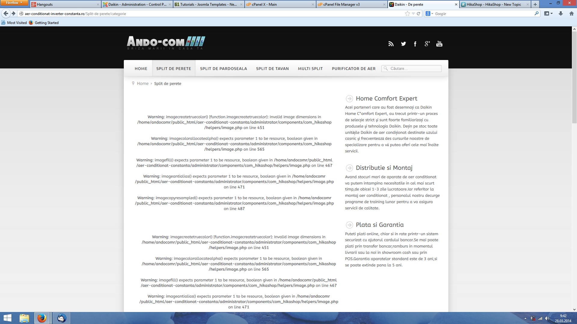

  • Posts: 15
12 years 5 months ago #150278
This error persists tho ...it is where categories listing should be,i created a image for every category,and now it wont display any of them. Please help
Thisare the errors.
Warning: imagecreatetruecolor() [function.imagecreatetruecolor]: Invalid image dimensions in /home/andocomr/public_html/aer-conditionat-constanta/administrator/components/com_hikashop/helpers/image.php on line 451
Warning: imagecolorallocatealpha() expects parameter 1 to be resource, boolean given in /home/andocomr/public_html/aer-conditionat-constanta/administrator/components/com_hikashop/helpers/image.php on line 565
Warning: imagefill() expects parameter 1 to be resource, boolean given in /home/andocomr/public_html/aer-conditionat-constanta/administrator/components/com_hikashop/helpers/image.php on line 467
Warning: imageantialias() expects parameter 1 to be resource, boolean given in /home/andocomr/public_html/aer-conditionat-constanta/administrator/components/com_hikashop/helpers/image.php on line 471
Warning: imagecopyresampled() expects parameter 1 to be resource, boolean given in /home/andocomr/public_html/aer-conditionat-constanta/administrator/components/com_hikashop/helpers/image.php on line 487

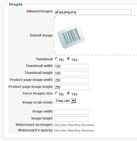

  • Posts: 86094
  • Thank you received: 14197
12 years 5 months ago #150447
Please go in the menu Display->Content menus and do a screenshot of the options there.
Also, please do a screenshot of the Images section of the configuration.
Because we're not able to reproduce the error on our end.
  • Posts: 15
12 years 5 months ago #150454
Hey nicolas i fixed it , after the update ,the image sizes and pane height were showing different numbers than i previously had set.
Thank you
