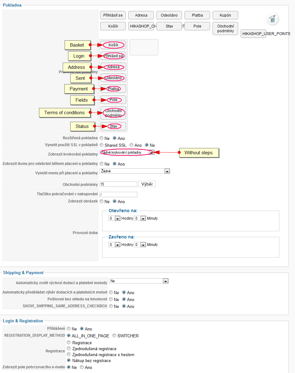

Can you show me what are the different URLs that you are having through the last step of your checkout process, and also some screenshots of how you configured your "checkout workflow" through "Hikashop->System->Configuration->Checkout" ?

as I mentiond as last url is the
domain.xx/categoryname//checkout/step/step-1
the categoryname=the name of category in structure resp. the url of category
At the end is always step/step-1
or step-id-something
In attachement you can see how is configuration of checkout set up.
12 years 5 months ago #150666
I think that checking that thread will probably help you :
You can set the option "Force a menu on checkout" in the tab "Checkout" of the configuration and the URL will always be the same.
