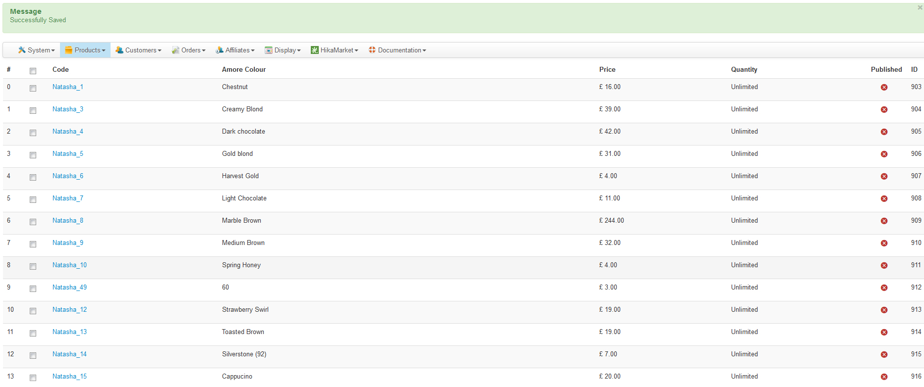

Thanks I run this query on the database then went back into a product and added a variant then clicked on manage variants, the prices were then generated as follows (attached)
I don't know where these figures come from they appear completely random. The main products price is 207 with tax.... I can manually update it however i am confused as to why it does this.

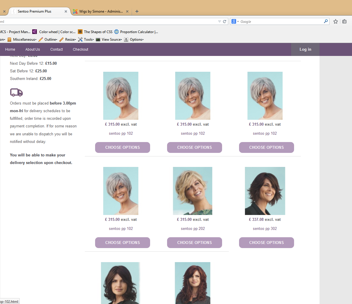

As you can see in untitled 1.png I have duplicated my product sentoo pp 102 3 times and the display at this level is fine.

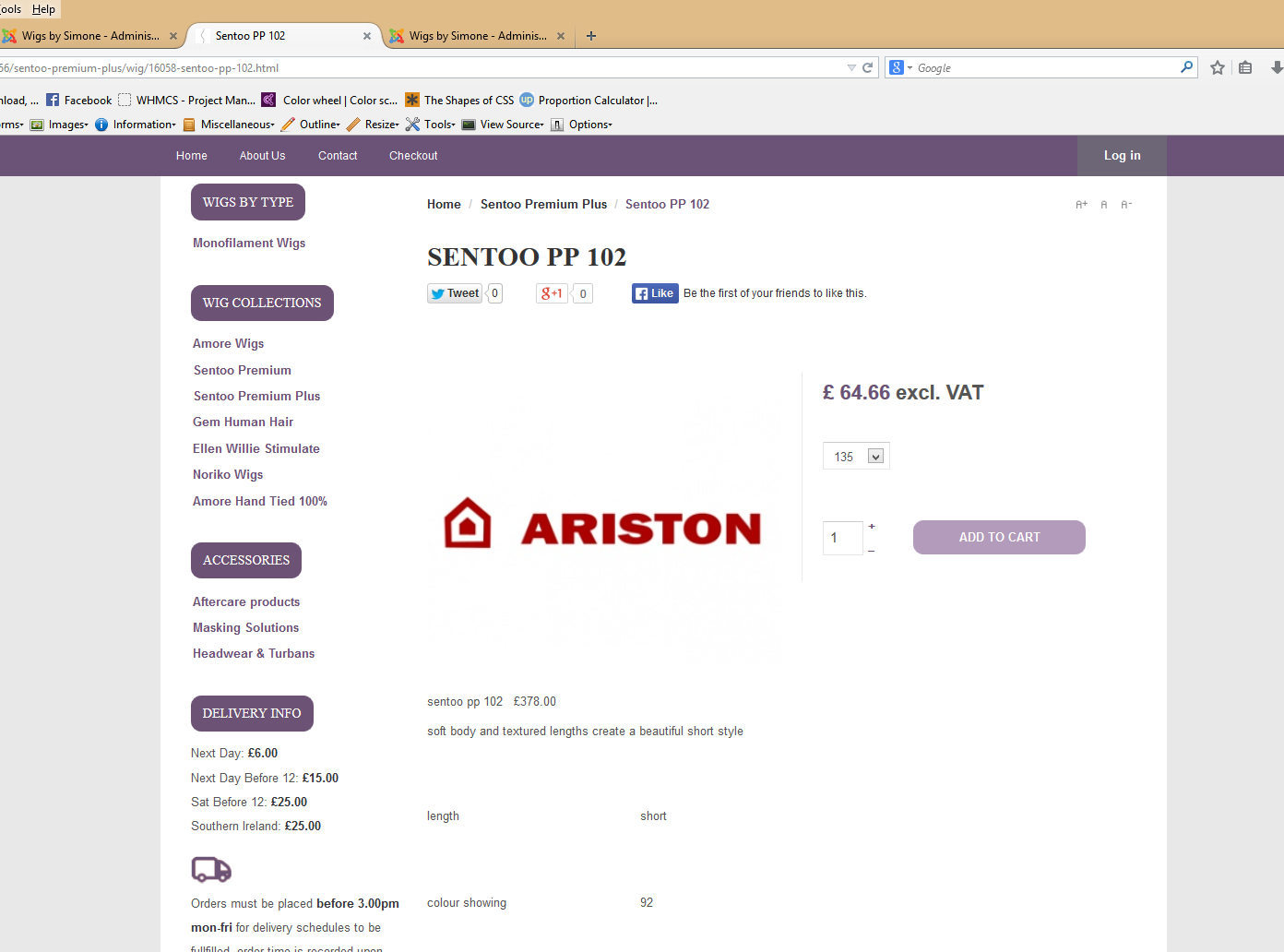

When I click through to the product I am given an image that is not the product image and a random variant price (see untitled2.png)
When I click through all the variants after this I am given different prices (see untitled 3.png)

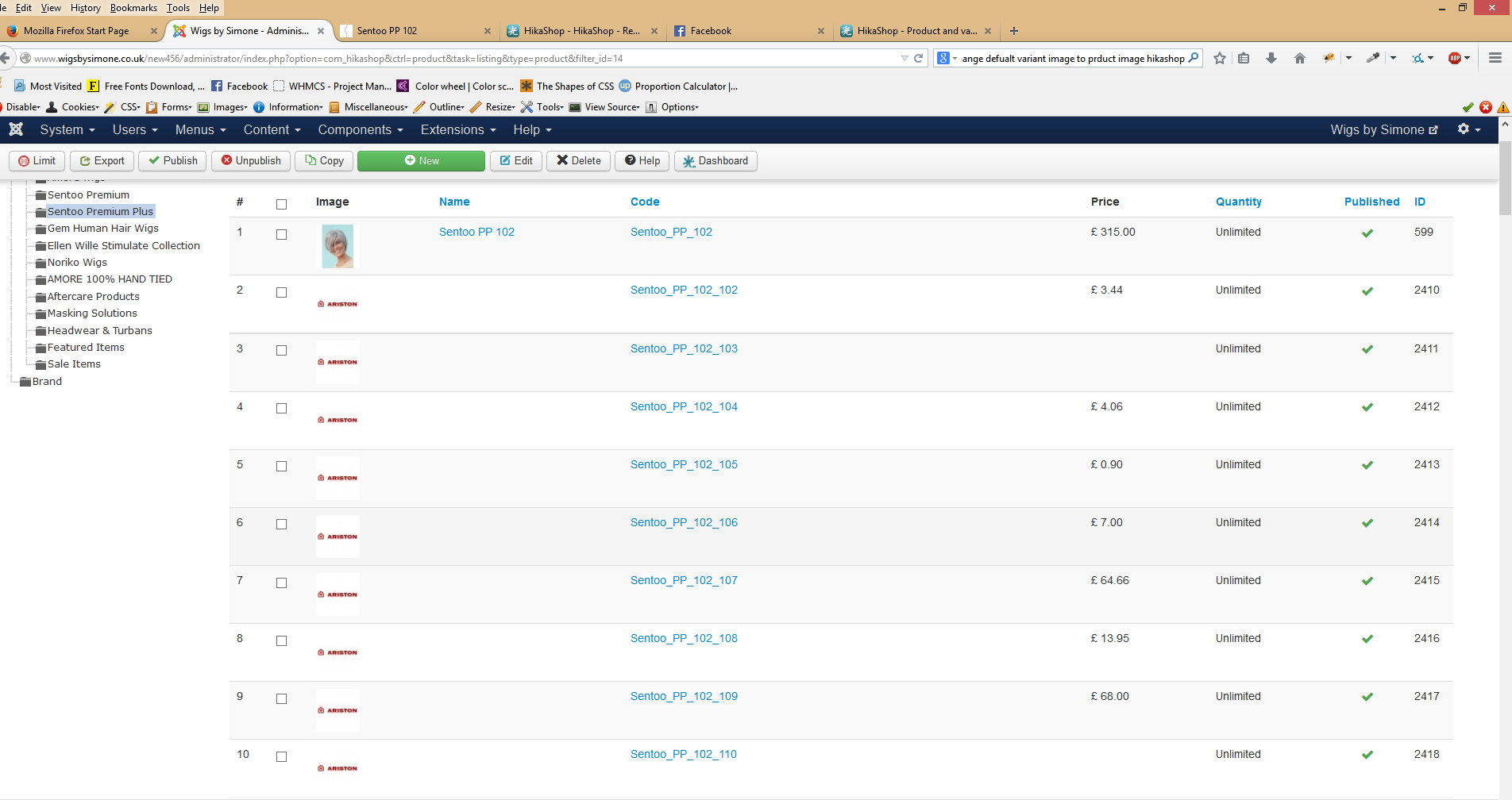

In the back end in untitled 4.png you can see the generated variants and prices along with the image (this is the same for all products that I have published variants for that have been generated automatically)

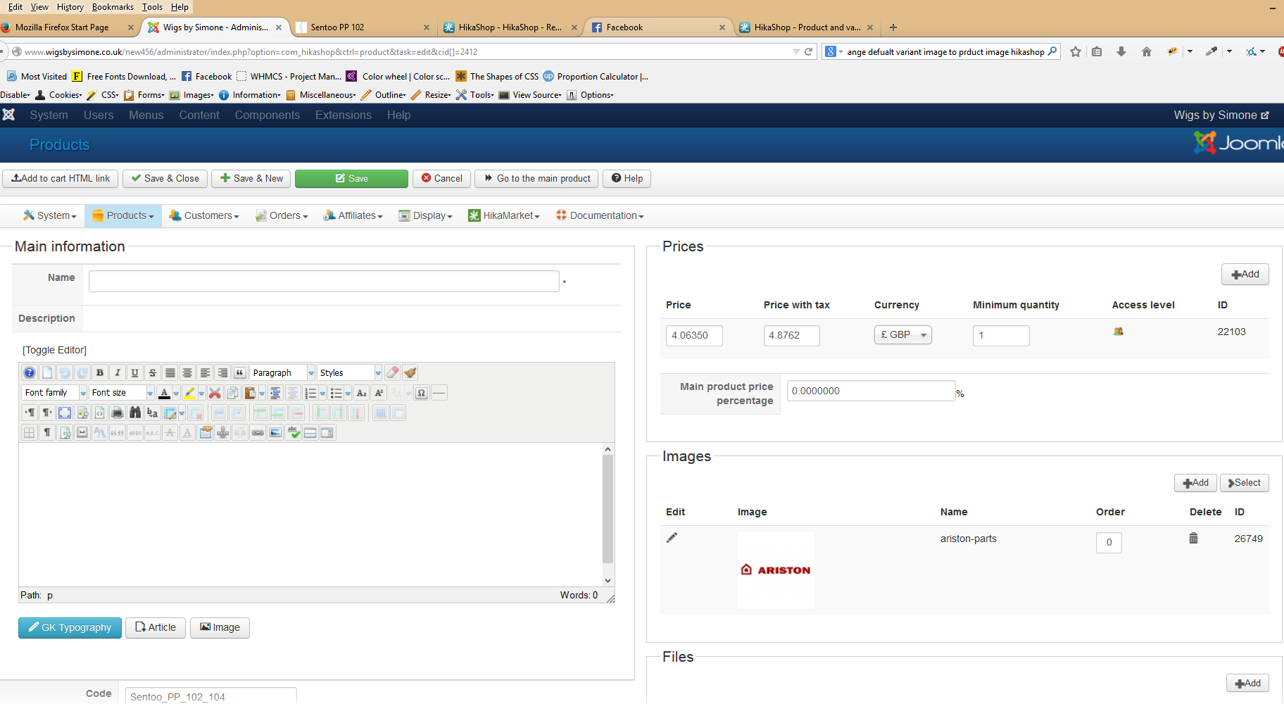

When I then click through to my product I can see the generated variant price and image which I did not include when adding the variants to the original product. (see untitled 5.png)
The variant prices change on product and variant when automatically generated but when inputted manually it does not..... Where exactly are these prices coming from as I do not need any different variant prices.
