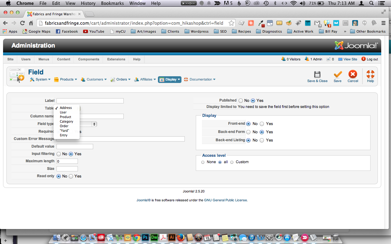

  • Posts: 34
12 years 3 months ago #155860
Yes, we have the business edition. I do not have a table "item" please see attached screen shot of my choices. I don't know if the table names were changed due to a custom bridge for the client's POS system.
12 years 3 months ago #155873
"Yard" is not a default type, that's maybe the item one which has been renamed.
Thanks to try this type.

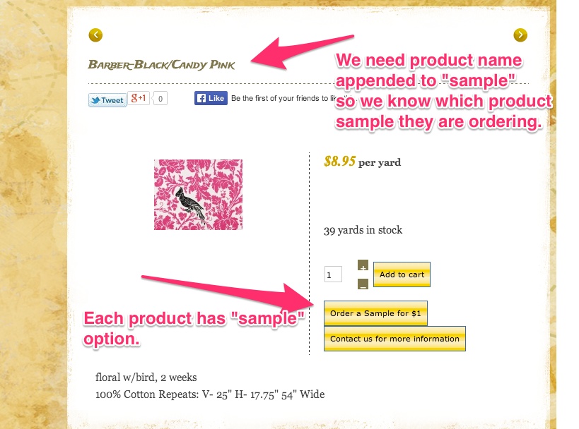

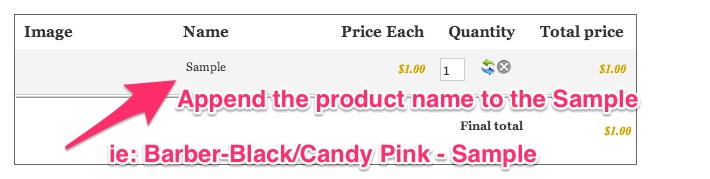

  • Posts: 34
12 years 3 months ago #157003
Sure,
Each product can have a sample. When the customer orders, we must know which product they want to sample to be from.
So on the product page, (attachment 1), when the customer adds the sample to their cart, we would like to return to product category, instead of "sample" category.
When the sample is placed in the cart, we need the product name appended to the Sample name (see attachment 2) so both the customer and the client knows what product to cut the sample from.
Thanks again for your help. I will be installing yet another Hikashop cart shortly. It is my cart of choice :kiss:
12 years 3 months ago #157052
Ok so to understand correctly, you have only one product named "sample" and you need to specify the product from where the customer added the sample.
I think that this will require a plugin based on the function "onBeforeCartUpdate()", add a parameter in the url which will be the id of the current product, and then you can manage things to change the product name from "sample" to "sample of XXX" for example.
