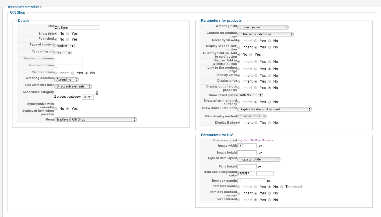

Hi Maybe, I have misunderstood where I should make the suggested changes.
I went to hikashop > display > content menu > I select the relevant menu as the setting as attached and tried to make the changes.
I have also disabled the associated modules in the display > content modules section.
None of the above have had any effect and the duplicate products still apeear on the front end.
Happy to supply login details via PM...

11 years 10 months ago #156347
You unpublished the associated products listing module, but you didn't unassigned it from the associated modules option of your menu.
Above your screenshot, there is an "associated modules" option with a "select" button. If you click on it, you'll get a popup and you'll be able to turn off the "enable" option of your menu's associated module there. Then, save the popup and the menu and it will work like you want.

11 years 10 months ago #156494
That worked. Thanks for your help.
