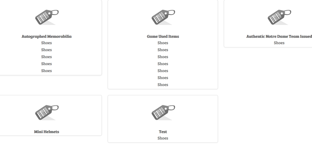

When using menu item Categories Listings with Show sub categories = All direct sub categories worked fine until I upgraded from Starter 2.3.0 to Business 2.3.1. I tried this on two different sites to make sure I wasn't doing something to break it. I am just now learning some things with Hikashop.
I updated one of the installations to Joomla 3.3.0 on the off chance that it would fix the issue. It did not. I have an Akeeba backup of the url not mentioned that I will revert to and try again to see if it breaks.
This is what it looks like now

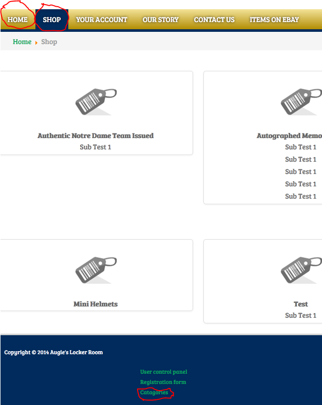

Here is what the sub categories should look like on one of them. It has the number of sub categories correct but they all point to one.
I even turned on the default Hikashop menu to try it out. I have circled the three menu items I created to see if I was doing a setting wrong. They all have the same issue, but some are linking to a different sub category. The red circles are the Category List menu items.
After having no luck there I went to another site of mine that still had starter 2.3.0 and made some sub categories and it looked fine. I decided to try updating to Business 2.3.1 and it has the same issue as mentioned above.

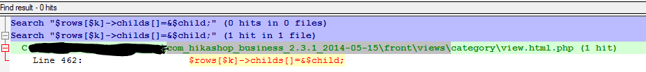

Replace the line:
$rows[$k]->childs[]=&$child;
to:
$rows[$k]->childs[]=$child;
in the file administrator/components/com_hikashop/views/category/view.html.php and that should fix the problem.

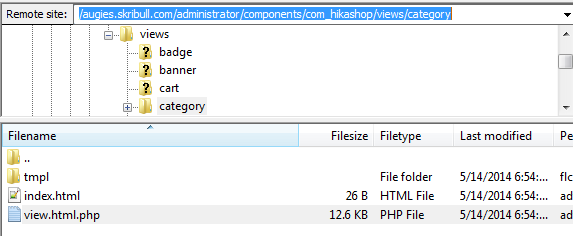

I don't know if I am just missing it or it isn't there. I used search function in Notepad++ and couldn't find that string, so I used smaller portions of the code and could not find anything that looked similar. Now I don't know php, but I could not find anything close.
I have attached my view.html.php file from the above path. Also is all of the code from that file in code view here. I don't know which you prefer.

12 years 3 months ago #156133
I did a quick search in all of the files from the business zip and it found that line there. I then downloaded com_hikashop folder from administrator on my server and searched that. No files have that line.
If I change that line and then rezip the package, can install hikashop with my new zip to fix it?
Last edit: 12 years 3 months ago by blbeta.
  • Posts: 86094
  • Thank you received: 14198
12 years 3 months ago #156129
I'm sorry, I gave you the wrong file path. It should be in components/com_hikashop/views/category/view.html.php
