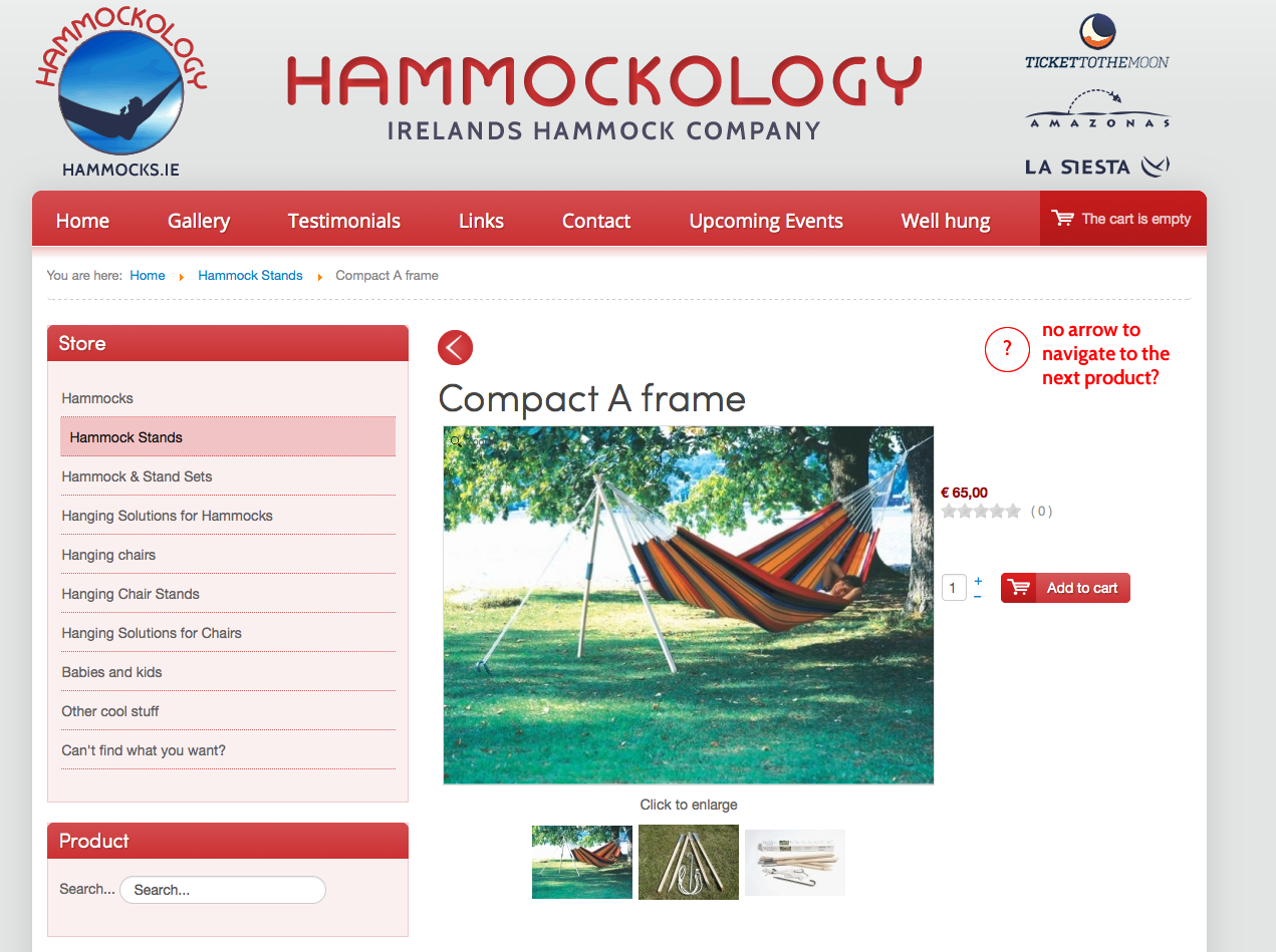

The buttons navigating to next, previous product on the category page don't display the products in the right order, the order is quite random, is there any settings to change to correct it? Any ideas?
hammockology.ie/hammocks/i
Thanks,
Kashka

Please go to the second product from the hammock stands category:
hammockology.ie/hammocks/index.php/hammo...t/23-compact-a-frame
There is no navigation to the next product, back arrow only, but in the category there are several more items:
hammockology.ie/hammocks/index.php/hammock-stands
Thanks,
Kashka
  • Posts: 85393
  • Thank you received: 13962
11 years 10 months ago #156856
This means that the previous/next system only sees these two products.
Can you go in the menu Products, and make sure that each product of that category has an ordering which is unique from the others of the same category ? If several products have the same ordering, it could create such problem.

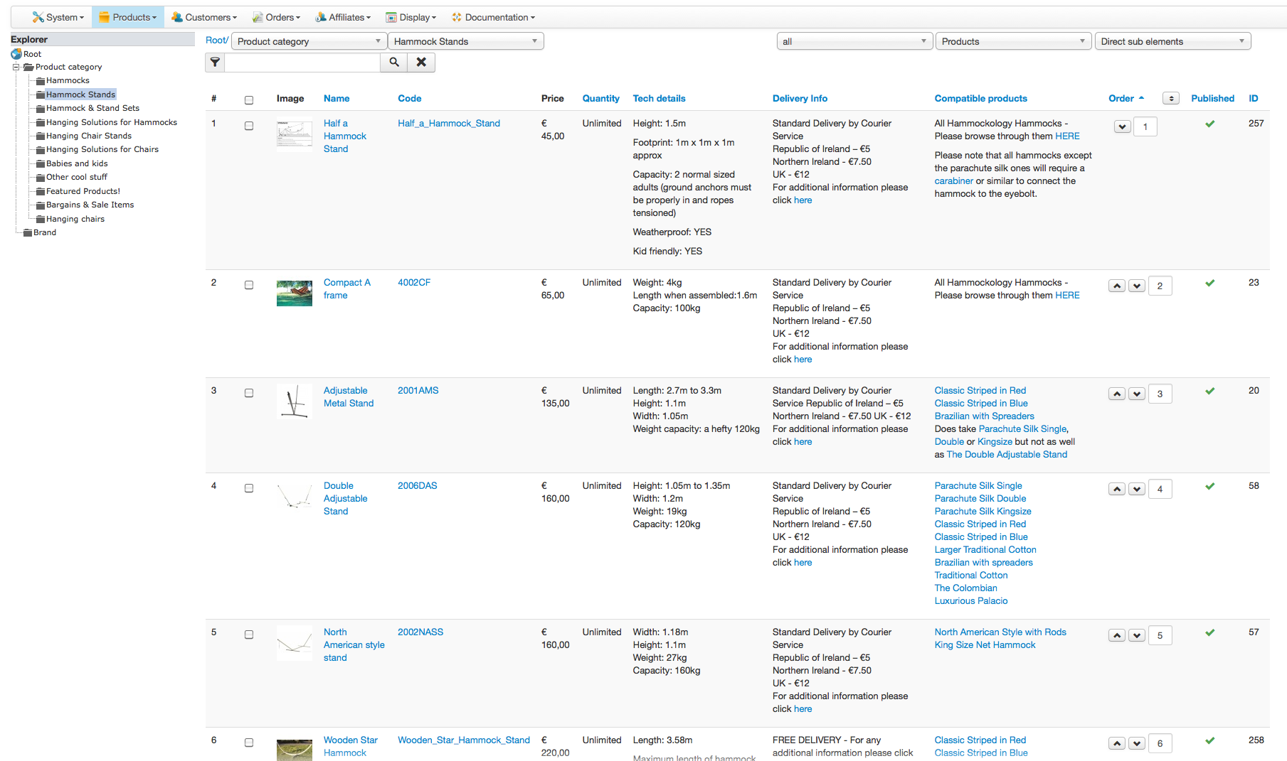

11 years 10 months ago #157014
The ordering is unique as per screen grab.
Thanks,
Kashka
11 years 10 months ago #157048
I just checked the request to get the products, we have an ordering on the "ordering" column.
Are the products in many categories ? That could be the origin of the problem.
If it is, thanks to change the categories order in the product page.

  • Posts: 85393
11 years 10 months ago #157417
Your screenshot is from the listing of the products. That's not what I asked you to check. Edit these products and check that the categories in the "Categories" area of each of the products are in the correct order (the main one that you want to be used for the next/previous buttons needs to be the first one in the list).
