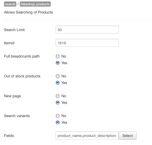

Hello Mohamed,
Thank you for your reply. I checked the plugin and both "product_name" and "product_description" are in the fields for searching? Any other thoughts on what is causing the issue? here is a screenshot of the settings for the plugin.
Thank you for your time!

11 years 2 months ago #156602
I just tried again, and it seems that the search is working fine now.

Hi there,
I checked your issue and it seems there was indeed a problem as the plugin was searching for the exact phrase in the name AND description. Which is quite rare. I fixed it so it search for the exact phrase in the name OR the description. Which should fix your issue.
To update the search plugin just install the two attached file as a classic plugin.
Do not hesitate to give us any feedback ;)
