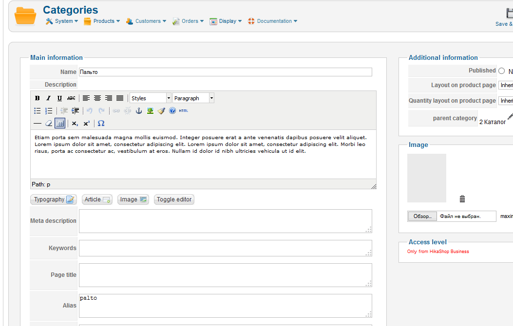

However I don't get the categories to work without the id. When clicking on the link to a category or a child category the sysyem can't load listing of child categories or the associated module. I have put aliases for every product.
Can you help me?

You should also put aliases for your categories and make sure that they don't start with a number and are different from the product aliases. Then it should work properly.

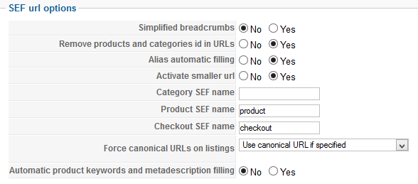

Hi!
Sorry, just a couple of days using Joomla and HikaShop.
Have same issue as a topic starter.
Joomla! 2.5.24
HikaShop Starter 2.3.2

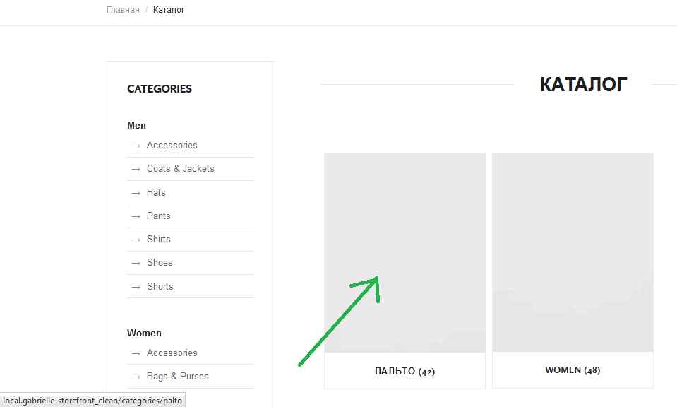

If i'm make "Category SEF name" empty and than switch ON "Remove products and categories id in URLs" than I cannot get access to categories from view by URL, just if i add category ID before alias of it.
For example: with this config (like at screen shoot in attachments) i can get access by link:
http://local/categories/14-palto
but not by this:
http://local/categories/palto
"categories" - alias of menu link (or how it calls)
Any ideas?
Thanks in advance.
UPD:
all works correct if use hikaShop menu, but not Main Menu.
Also found that I can't make "Category SEF name" and "Product SEF name" both empty
because system tell me: "you can't have the same SEF name for product and category".
Maybe need use exclude from checking when "SEF name " equal to "".
Last edit: 11 years 10 months ago by NickCool. Reason: UPD

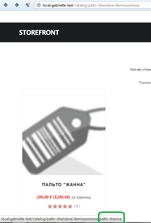

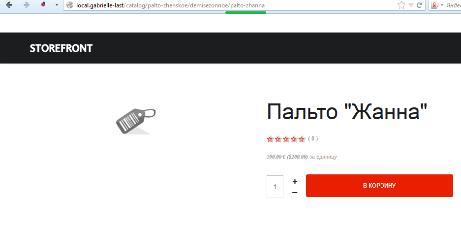

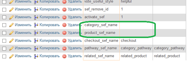

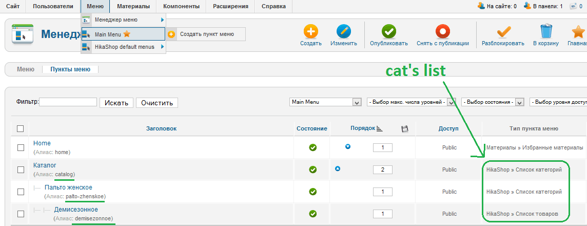

11 years 10 months ago #168577
nicolas wrote: Yes, you need to use a HikaShop menu. Otherwise, it's joomla which tries to display the categories and that is not possible.
And yes, you can't have both SEF names empty.

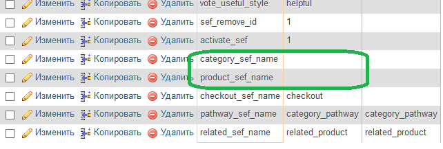

But look - it will work with menu if i make categories and products SEF empty by correcting in table '_hikashop_config' rows where attribute `config_namekey` = 'product_sef_name' and 'category_sef_name':

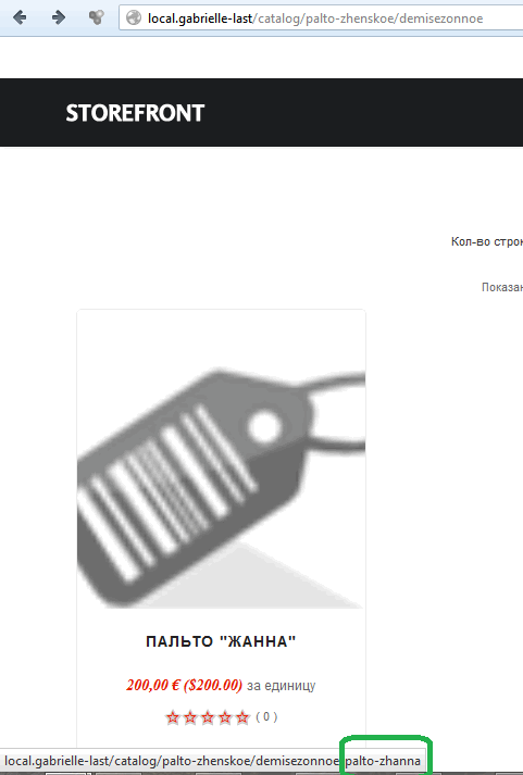

subcategory page:
product page:

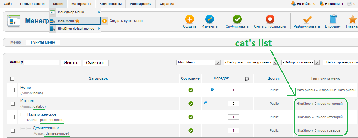

menu structure:
How about this?
I'm need just this structure for SEO, but I need to add menus manually, but we don't have a lot yet.
UPD: maybe exists more comfortable and safer way to do that?
Thanks in advance.
