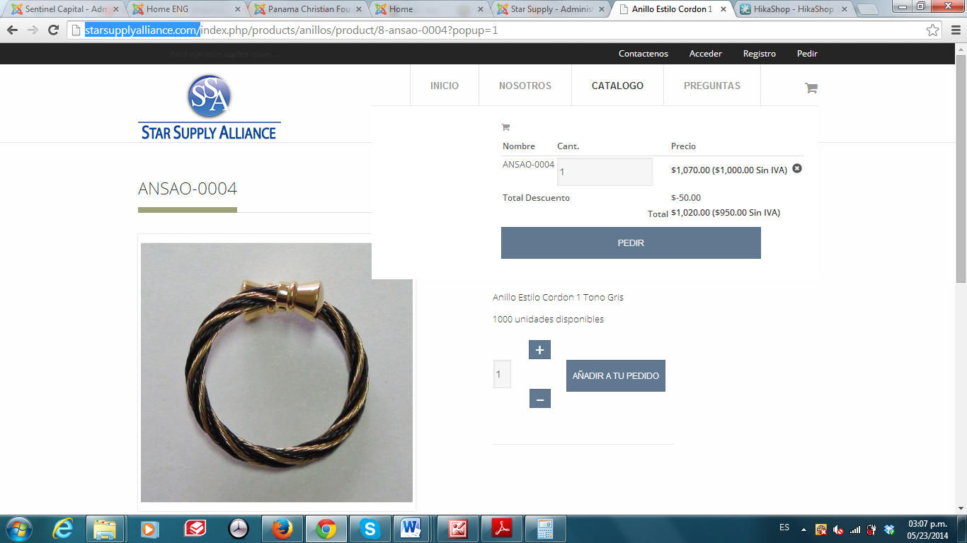

We need the tax calculated on the discounted amount. So in the attached example,
Pre discount price $1000
Post discount price $950
So we need the tax of 7% to be applied to the Post discount price of $950 but it is being calculated on the Pre discount price of $1000 = $70
How can we remedy this situation?
Thanks,
Mike

In the backend, under -> System -> Configuration -> Main tab -> "Taxes" section, there's the parameter "Apply discounts". What is it set to in your configuration? Seems it's "Before taxes", but unless I'm completely wrong you want it to be "After taxes". Try that?
  • Posts: 122
12 years 3 months ago #157181
Hi, I switched over that parameter and it had the desired affect.
Also in the cart module I have Display price set to Yes but it does not appear. (same screenshot as before)
Do you have any idea why this is?
Thanks very much,

Maybe it's me, but I don't know what you mean. Can you describe what you want to achieve? Sorry.
  • Posts: 122
12 years 3 months ago #157183
Currently in the cart module we can see a price which is unit price x quantity.
Can we display unit price as well in the module?
  • Posts: 2143
  • Thank you received: 747
12 years 3 months ago #157184
Oh ok, you want the unit price and the line item total in the small cart module. I don't see that being possible out of the box. Under "Parameters for products" in "Price display method", you have a few options (where "Unit price only" and "all" don't do anything for me), but that's it.
Of course, it's still possible to do with a view modification which shouldn't be too difficult. For as long as you don't run out of space... particularly regarding module width... ;)
