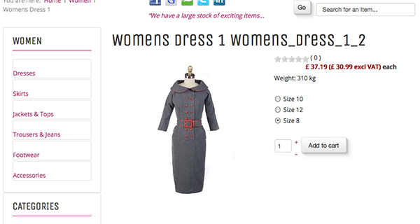

Hi I am desperate to adjust my product heading size and then possibly adjust the pricing and options to make more attractive..
I have been told this is simple and have been through all my Display Views files and also template files and am tearing my hair out.
Attached is a screenshot of what I mean.
Firebug tells me the following:
<div id="hikashop_product_top_part" class="hikashop_product_top_part">
<h1>
<span id="hikashop_product_name_main" class="hikashop_product_name_main"> Womens Dress 1 </span>
<span id="hikashop_product_code_main" class="hikashop_product_code_main"> Womens_Dress_1_2 </span>
</h1>
</div>
<div id="hikashop_product_Mens_Shirts_1_page" class="hikashop_product_page">
*All i want to do to begin with is simply adjust the <H1> to <H3> put for the life of me I cannot find the file to adjust!
PLEASE HELP...and thanks in advance..

Now, since you're done with CSS (yes?), let me tell you where you find the <h1> tag you're looking for.
Assuming that you're using the "default" view for the product page, the view is indeed "show_default" under "product". In the views listing, make sure you choose HikaShop, frontend, and the frontend template you're using, then you should find the view fairly quickly and be able to edit it.
You're using a relatively old HikaShop version, so I can't tell which exact line the <h1> header is, but it's early in the file, and you have the class and ID's from Firebug.
Good luck!

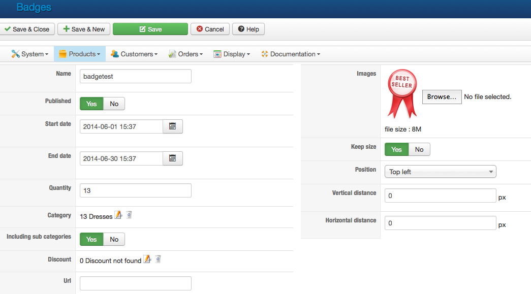

  • Posts: 15
12 years 3 months ago #158463
hi again - badge screenshot settings attached.... thanks

Ok, doesn't look too bad. Should work.
But:
(1) Not that it's preventing all badges from showing, but why did you set "Qty" in the badge settings to "13"? "Qty" is not the same as "Category ID" - so much should be clear. Just wondering because strangely you put there the same quantity as the category ID happens to be. Despite the fact that you presently have 8 products in the category. In brief: leave the field "Qty" empty unless you want only a limited number of products to have badges.

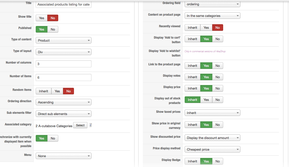

(2) Did you enable badges in the menu/module settings? In the backend under Display, double-check if for at least the relevant menus and modules the parameter "Display badge" is set to "Yes". Particularly the menu with ID 156 and the module with ID 147... these are the ones for category "Dresses"...

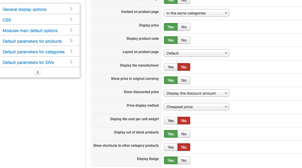

12 years 3 months ago #158614
Can you tell me where do you exactly want to display your badges ?
- If it's on your product listing content menu/module you'll just have to set the "Display Badge" option to YES through your product listing content menu/module configuration page
- If it's on your product page you'll just have set the "Display Badge" option to "YES" through "Hikashop->System->Configuration->Display"
  • Posts: 15
12 years 3 months ago #158731
Thanks mohamed - attachments to show settings
12 years 2 months ago #158773
The quantity field in the badge settings restrict the display of the badge on the products where the quantity in stock is equal to the value set in the option.
So I think that removing "13" in your settings of the badge quantity will solve your issue.
