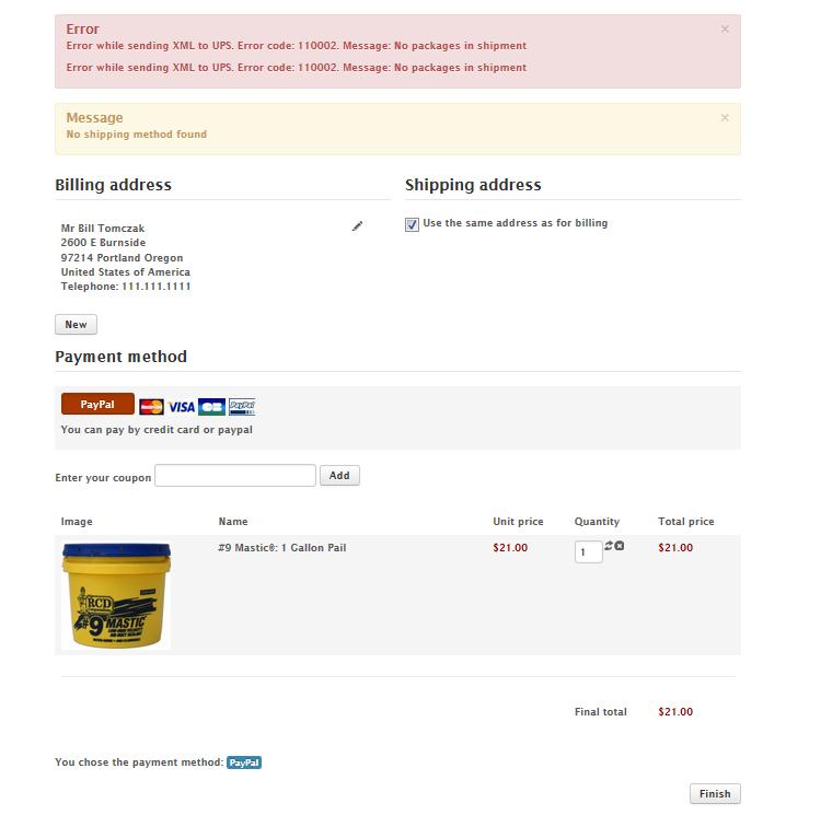

-- Error-message(debug-mod must be tuned on) -- : Error while sending XML to UPS. Error code: 110002. Message: No packages in shipment
This occurs when trying to purchase a product with variants. I've fixed it with the patch described below. But I can't be sure something else might be wrong. But if I've read the code correctly, without this change no package will be determined when purchasing a specific product variant.

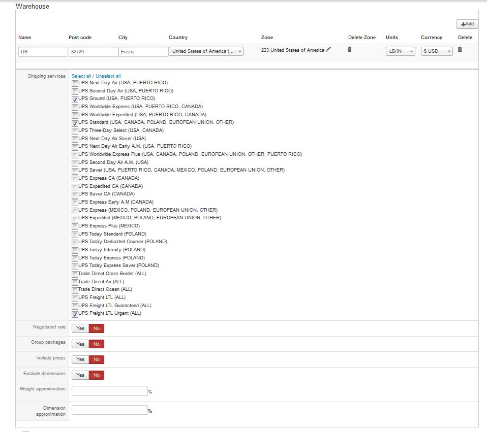

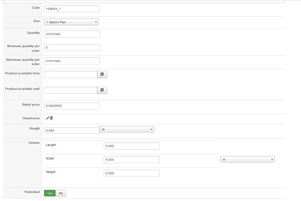

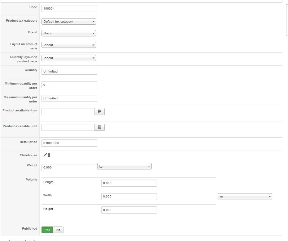

12 years 2 months ago #158799

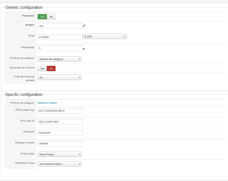

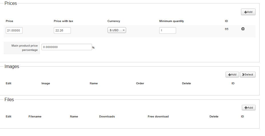

I just tested it on my end and it seems to be working fine with varients, can you show me through some screenshots how did you configured your :
- UPS shipping method.
- Product that you are adding to your cart, and its variant.

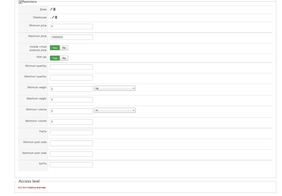

  • Posts: 6

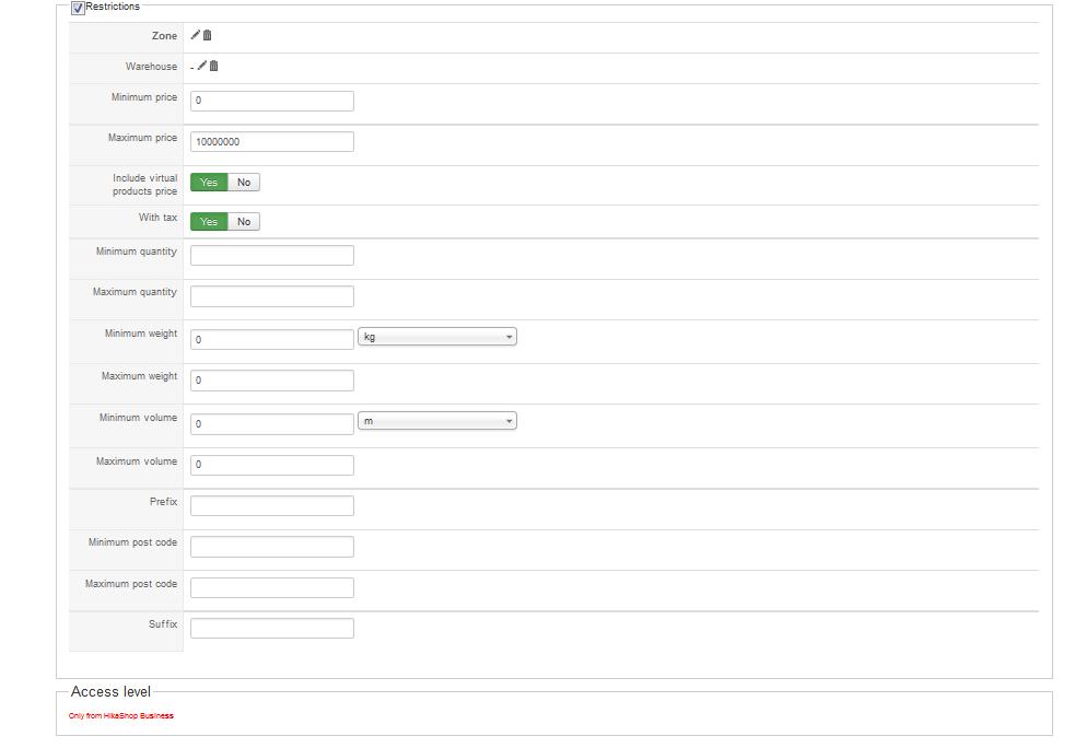

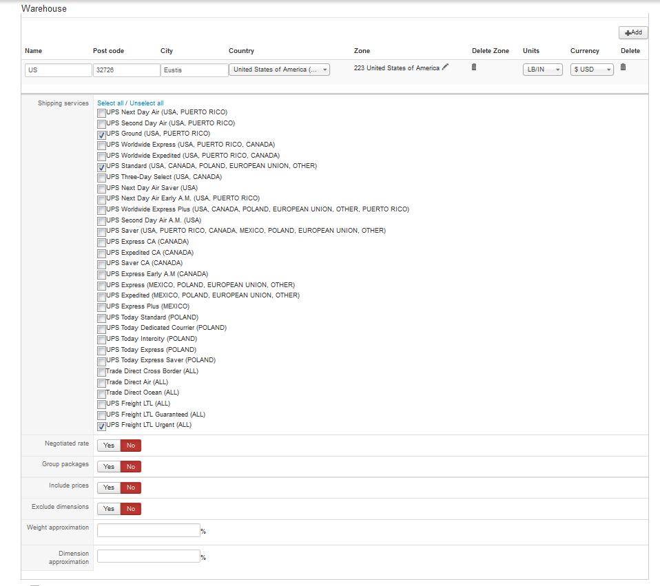

12 years 2 months ago #158821

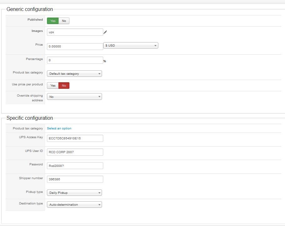

UPS/Warehouse config

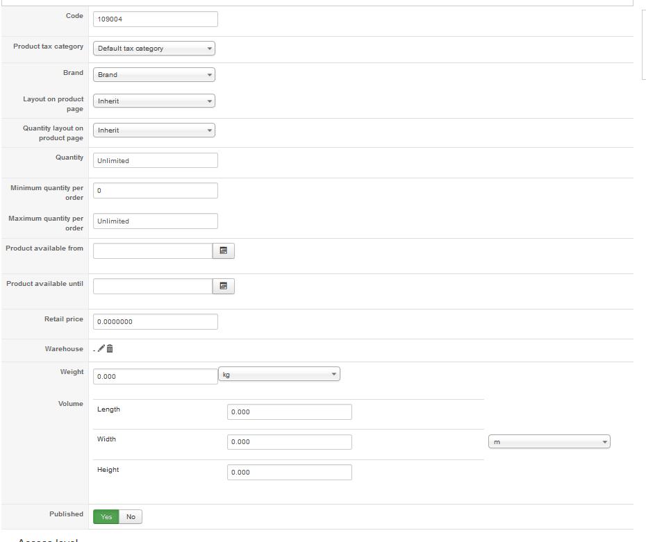

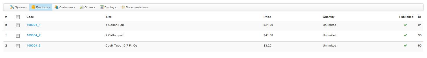

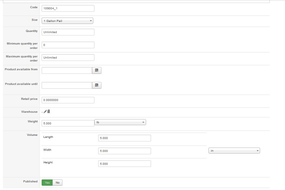

  • Posts: 6

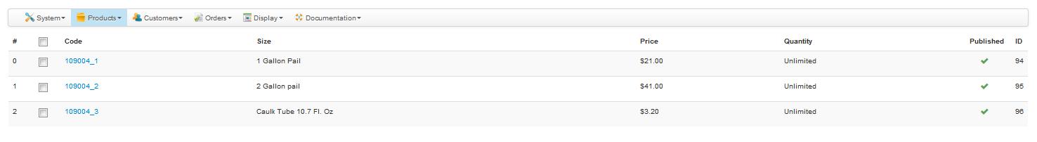

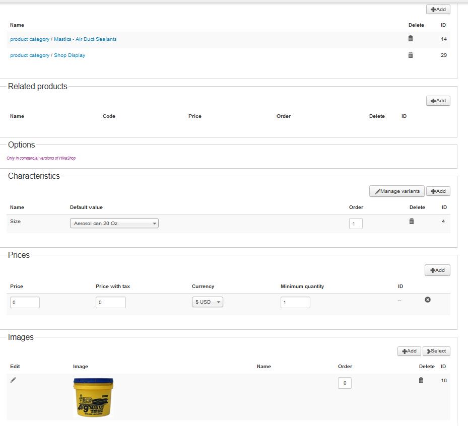

12 years 2 months ago #158823

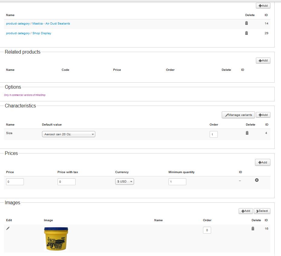

Product and variant setup

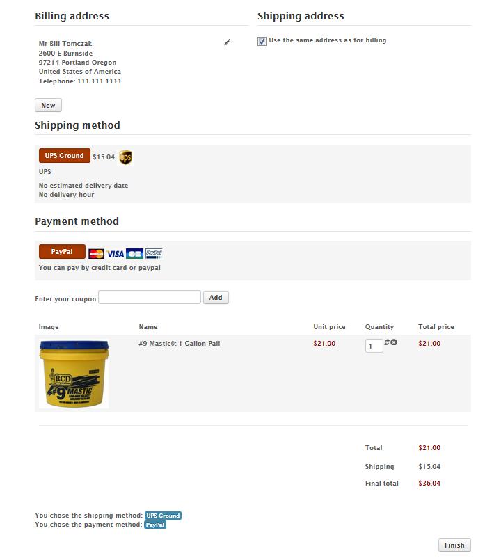

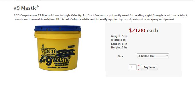

  • Posts: 6
12 years 2 months ago #158824

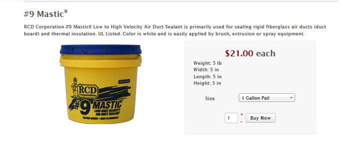

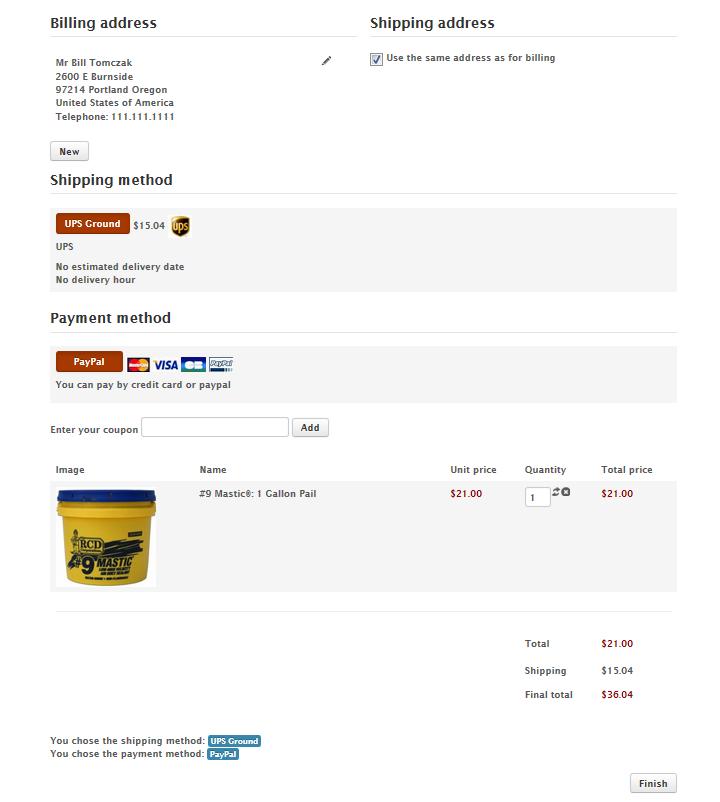

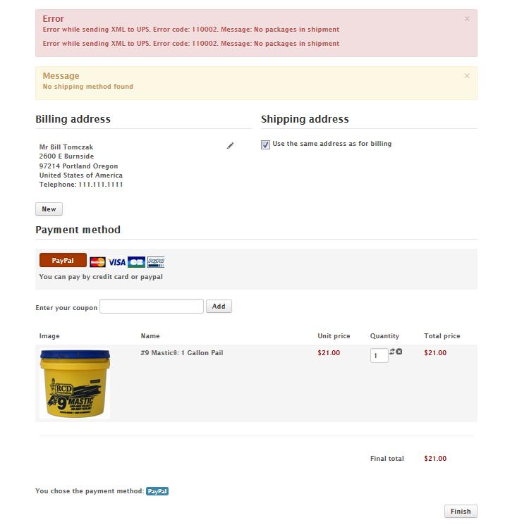

Purchase and cart pages
The cart pages show the result without my patch and with my patch
Let me know if there's anything else you need
