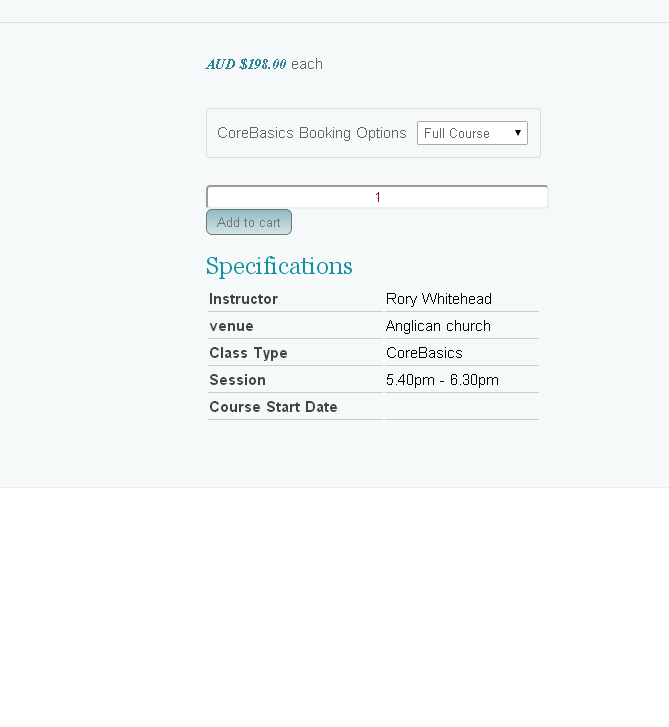

I have a main product with 1 characteristic showing in a drop down. I would like the drop down to show the "variant name" instead of the "characteristic" value.
Could you advise which file i would edit for this.
Patrick

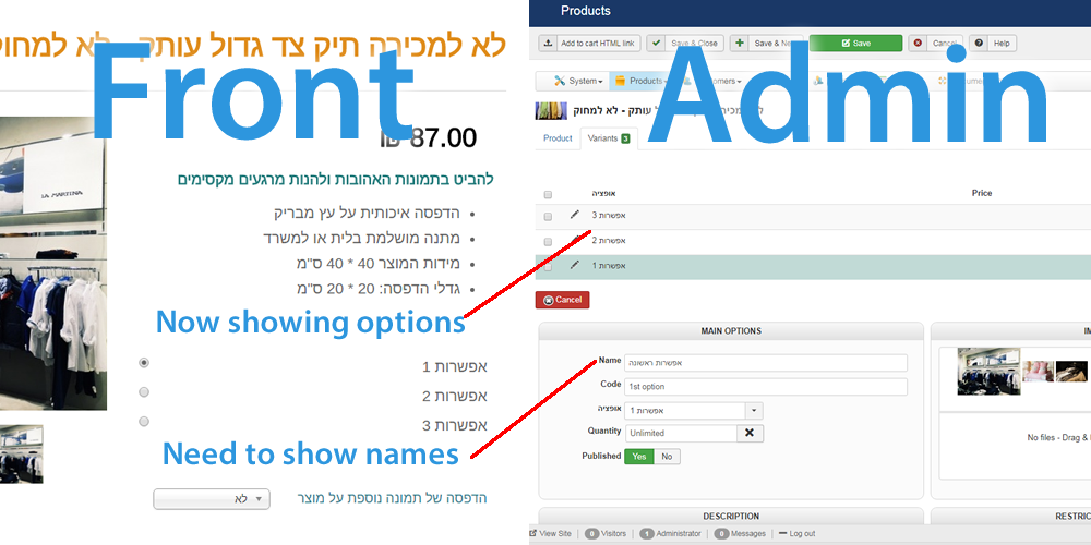

Please provide screenshots of what you want to do so that we can better understand your situation and what you want to change where.
Also, the change I was talking about was in the PHP part of that file, so the javascript code in that file was not concerned. Even now, you can ignore it.

Now its showing options, I need to show names of the options.
Also it's need to appear in order, not just product page.
