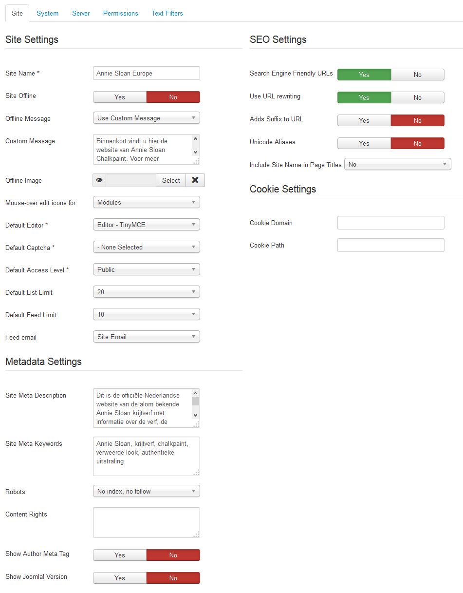

When I turned off the setting "Use URL rewriting" in the Global Configuration the problem is over.
We like to use the URL rewriting and we also have the .htaccess in use with the standaard Joomla settings.

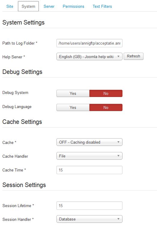

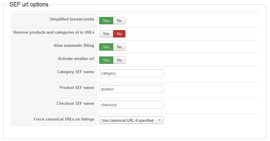

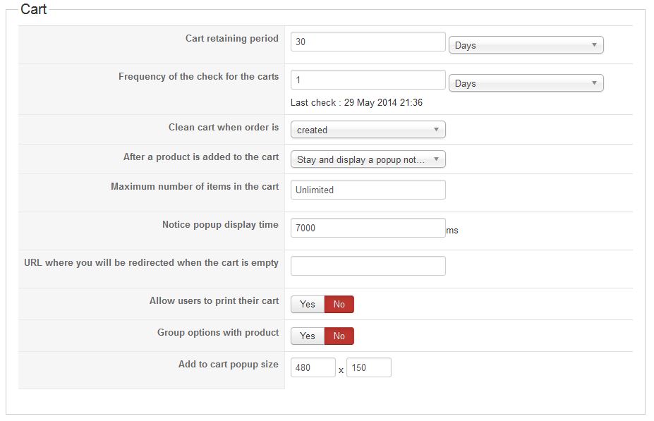

Attached our configuration of Joomla and Hikashop

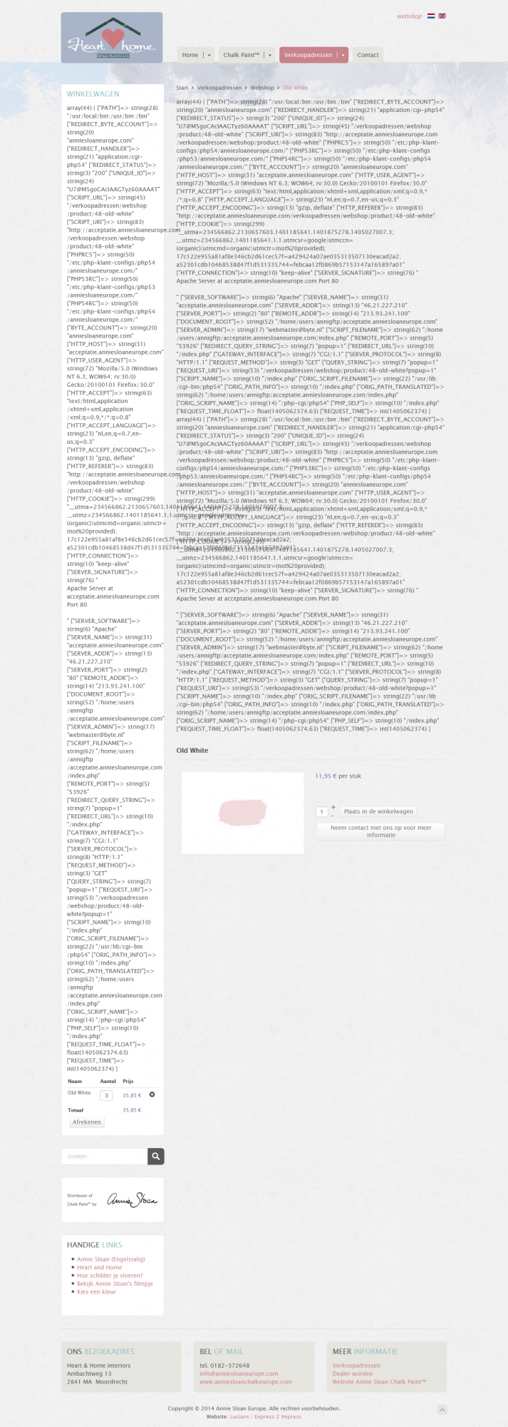

Here the dump of the $_SERVER variable from inside that hikashop_currentURL function on the page with the ?popup=1 page.

Change the whole hikashop_currentURL function code to the code below in administrator/components/com_hikashop/helpers/helper.php and that should fix the problem:
