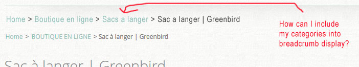

  • Posts: 272
  • Thank you received: 7
11 years 11 months ago #161372
Hi again,
Actually if I can get the 'product category' to display in the breadcrumb then that would be best solution. The product category has never displayed in the breadcrumbs, only the product (image attached).
Do you know how I can get the product category to display in the breadcrumb?
Thanks again
  • Posts: 85761
  • Thank you received: 14068
11 years 11 months ago #161411
Turn off the "simplified breadcrumb" option of the configuration and that will add a cateogry_pathway parameter to the product URLs which will allow the system to add the category in the breadcrumb.

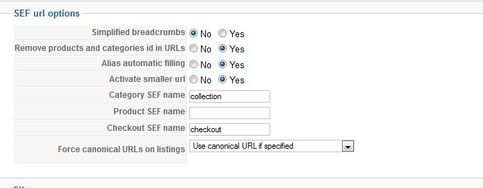

  • Posts: 272
11 years 11 months ago #161571
Thanks. I did turn off the simplified breadcrumbs (image attached) but it still does not show the categories. I've deleted all cache etc but I must be missing something. Any ideas? I will send you a link to my site by PM, as I do not want it on the public forum.
Cheers
  • Posts: 85761
11 years 11 months ago #161635
Then It might means that you set a canonical URL in your product. Because of that, the canonical URL is used instead of the dynamically generated URL. Try to remove the canonical URL for a product and see how it goes.
