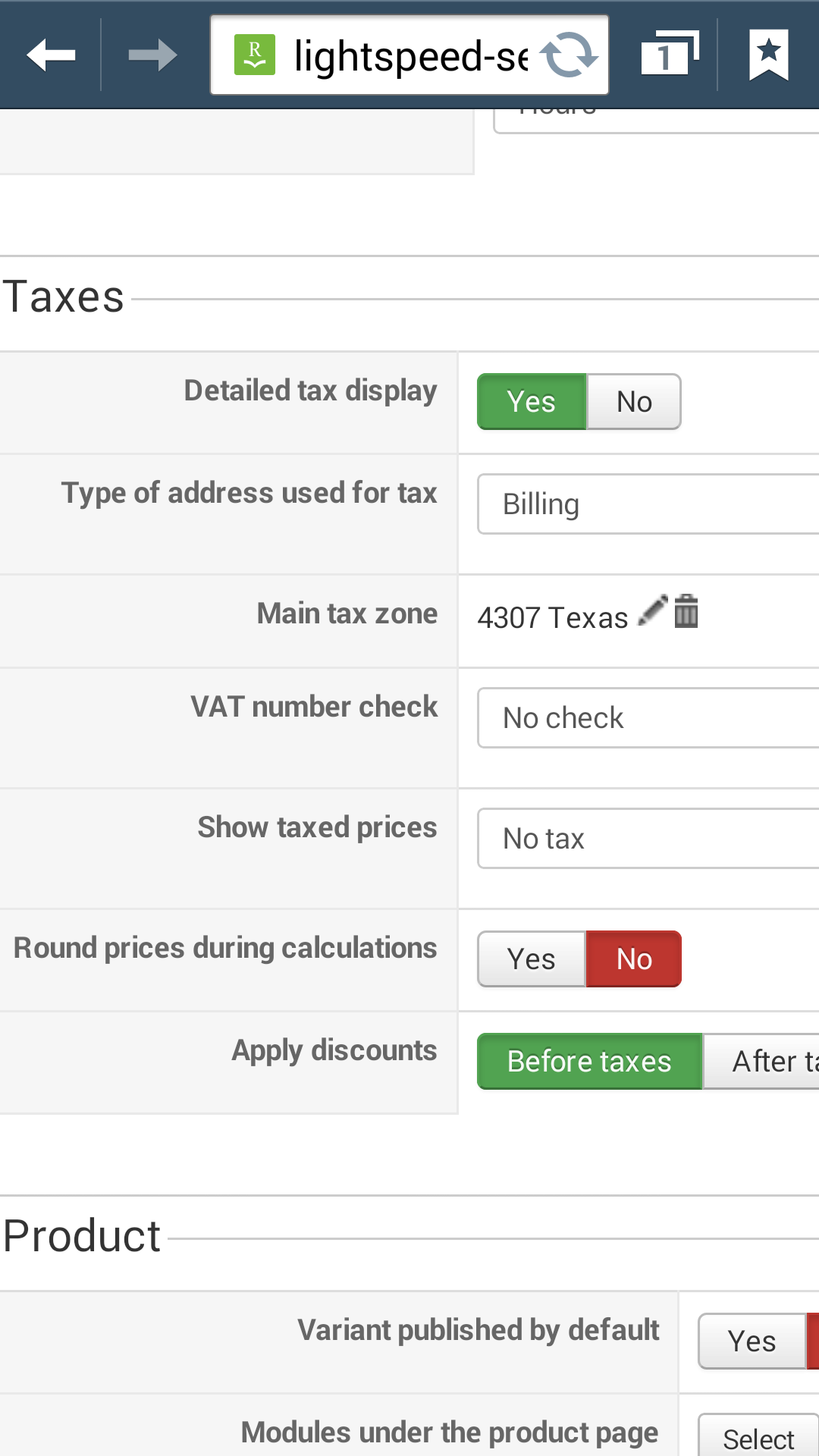

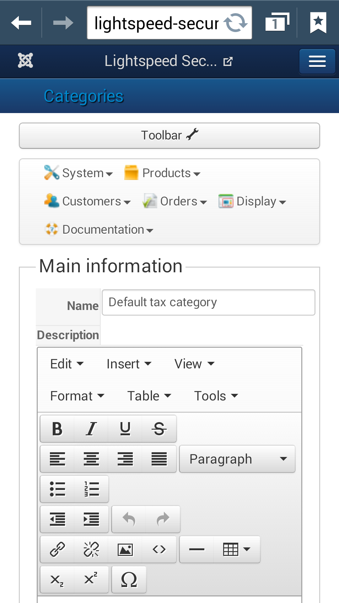

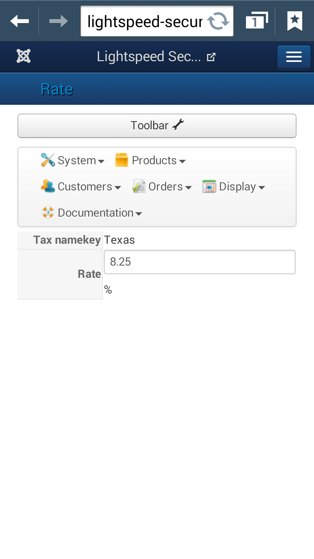

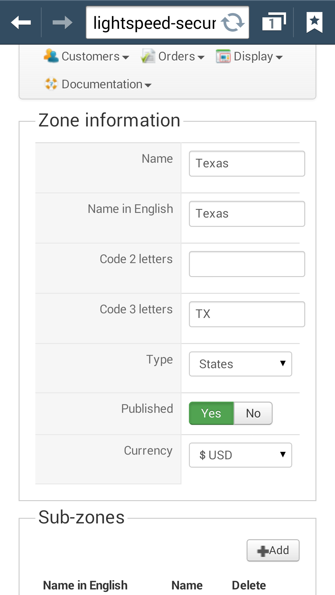

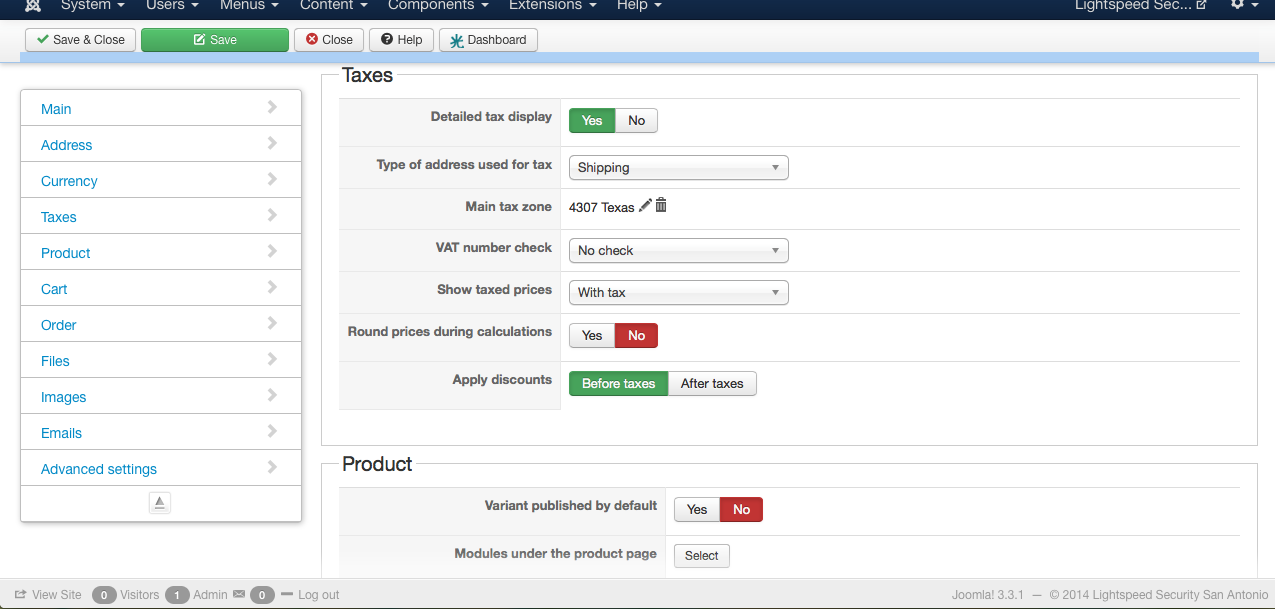

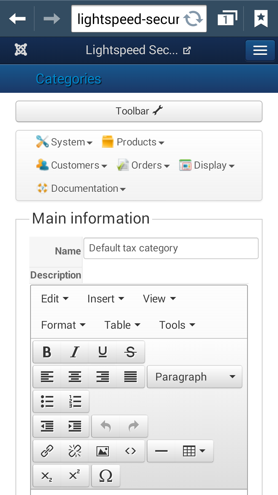

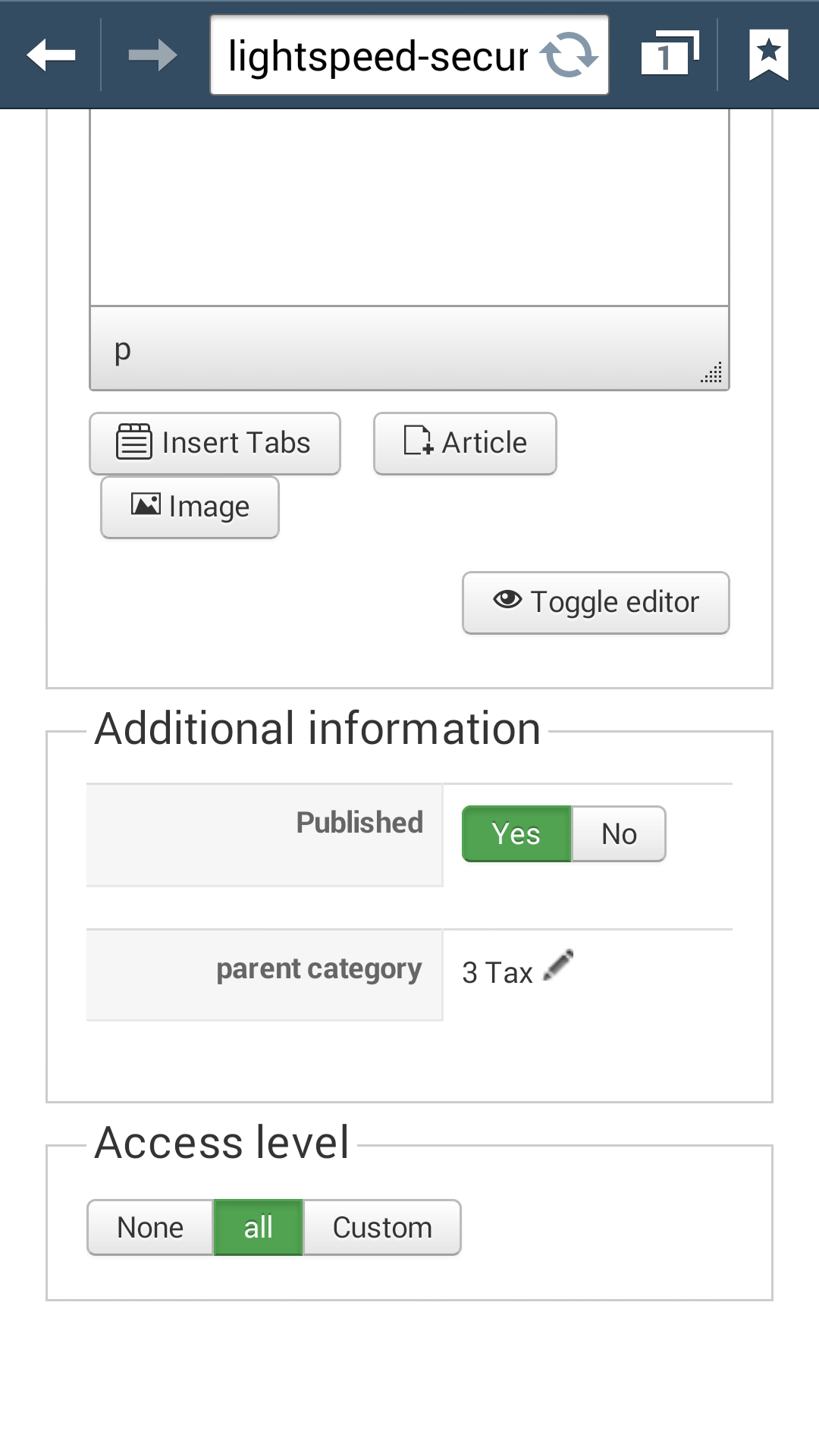

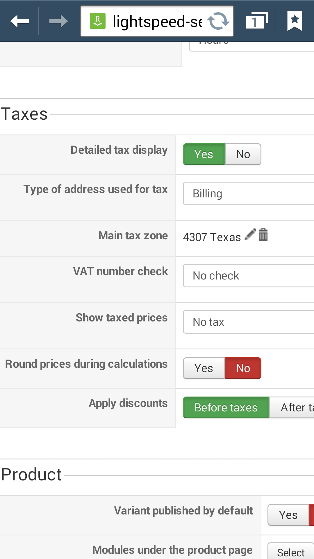

  • Posts: 26
11 years 11 months ago #163001
Hello Xavier,

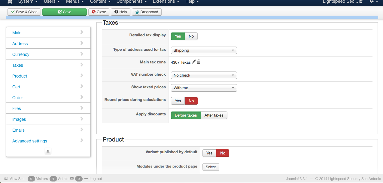

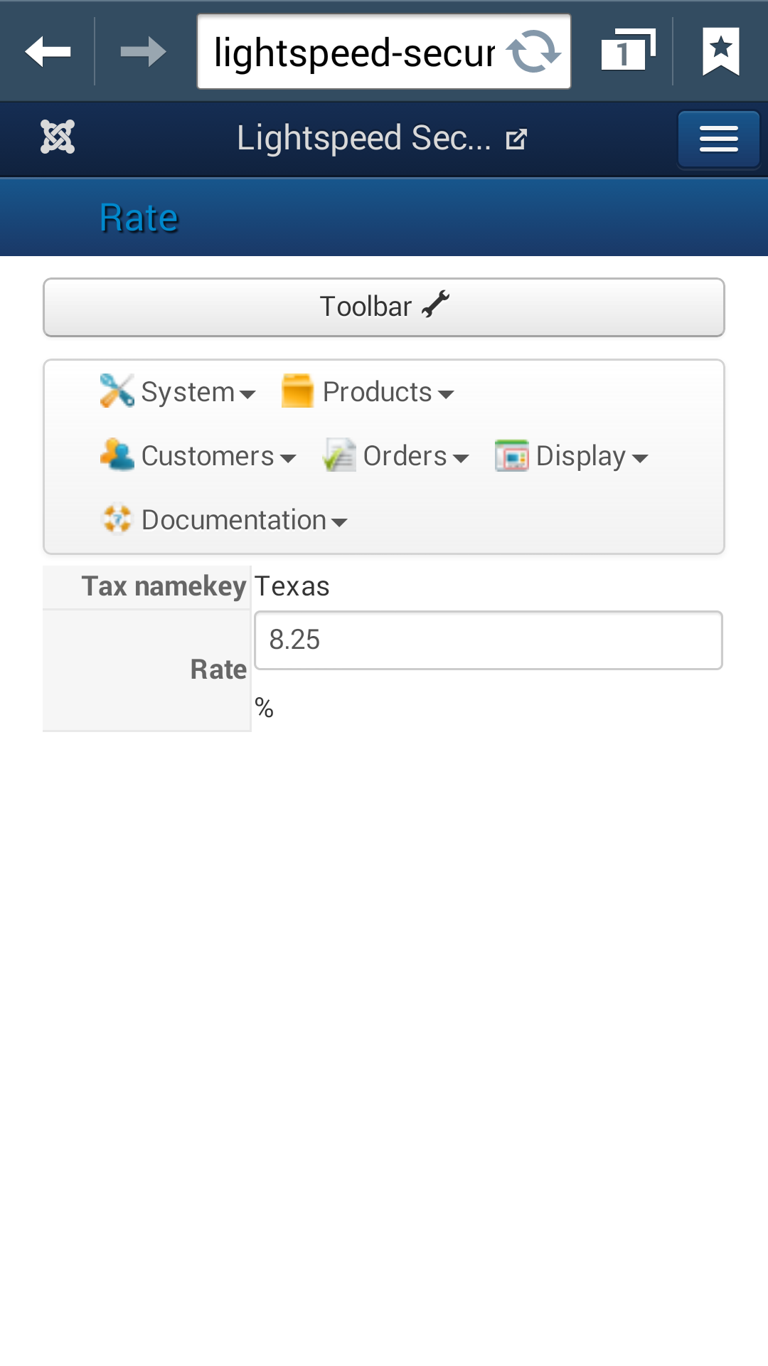

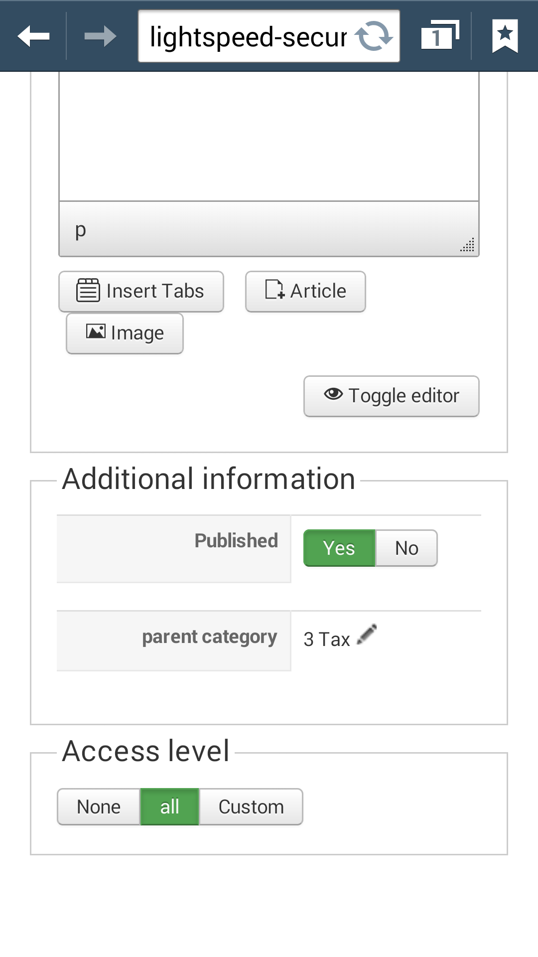

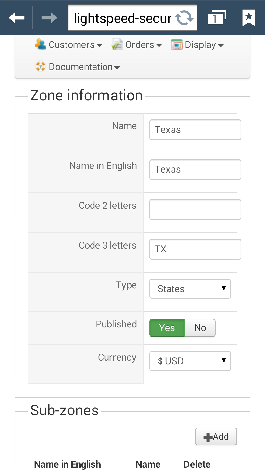

As per your request, I am attaching screenshots of the Tax General Config Set up, Category, Tax Rule, Tax Rate and Zone.
I hope this is enough info for you to be able to let me know what I need to do to get it working.
Thank you,
Rudy
  • Posts: 85761
  • Thank you received: 14068
11 years 11 months ago #163003
I don't see any screenshot of your tax rule.
Go in the menu System>Taxes. There, you have a listing of all the tax rules on your website.
Tax rules are what link zones, tax categories and tax rate together on your website.
If you don't have a tax rule, it's normal that it doesn't work and you should created one with your zone selected, the tax rate you created selected and the tax category selected and enable that tax rule.

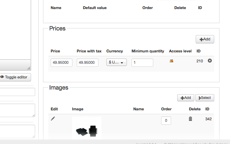

11 years 11 months ago #163087
Hello Xavier,

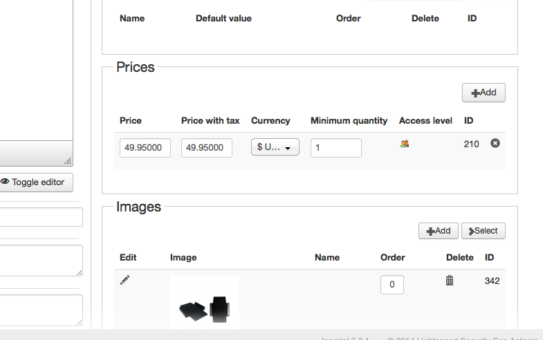

I found out the problem, I did not set a Tax Category for my products.
Is there a way to set the Tax category for all the products I already have (175) in one step, or do I have to add the Tax Category one by One???
Another thinng I need help with is not having the VAT appear in the shopping cart.
Thank you,
Rudy

11 years 11 months ago #163117
Yes, you can use the mass actions system (menu System>Mass actions) for that.
Create a new mass action on products, and set an action "update the value" with the column "product_tax_id" and in the input field, enter the id of the tax category and that should do it once you press the "process" button.

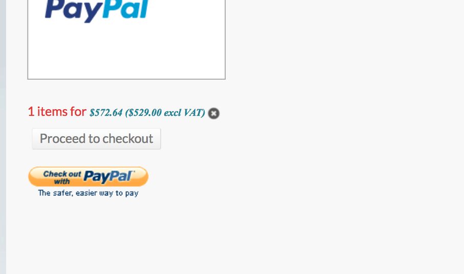

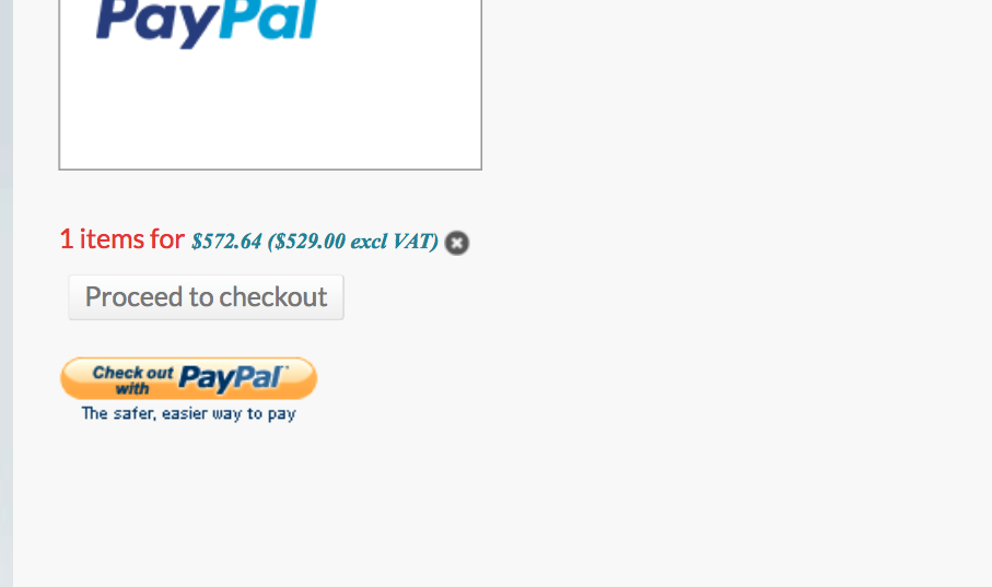

  • Posts: 26
11 years 11 months ago #163258
Hello Xavier
Here is the screenshot, When you add a product to the cart, this is the way it shows in the side bar.
In the US we do not use VAT. Worst case scenario it should say without TAX instead of excluded VAT
11 years 11 months ago #163269
That's probably coming from a wrong tax rule. You seem to have a tax rule set for the US. (VAT just mean Tax).
So if you don't have tax rule for the US, but see this tax in the cart that's maybe because if you are logged in, the address used is out of the US, if you are not logged in, the default shop zone is out of the US.
Time to create page: 0.192 seconds
