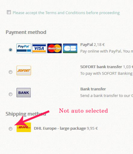

I will send you a URL by PM to our French site (both French and UK site have this issue). I would prefer to keep the URL out of the public forum. I have found out where the issue lies and I believe it is nothing to do with the overrides I have on several checkout files (I have checked all these files).
When you register for first time there is no issue, and the shipping option is automatically selected. However when you go through checkout a second time (say for returning customers) then the shipping is not auto-selected.
If you register on the site and go through to the first checkout step you will see the shipping option is automatically selected. But then clear your shopping cart, logout then add something to your cart again and go to first stage of checkout (using same login details as you registered with). You will now see that the shipping option is not automatically selected.

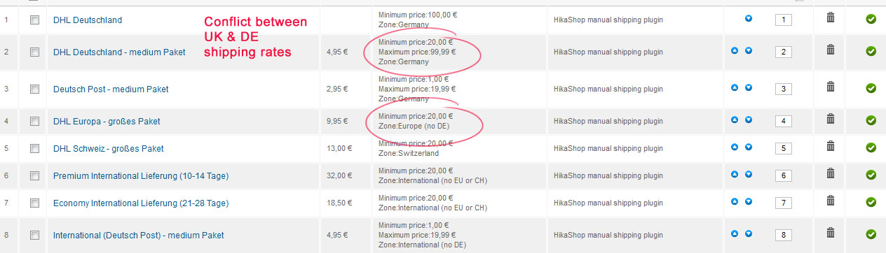

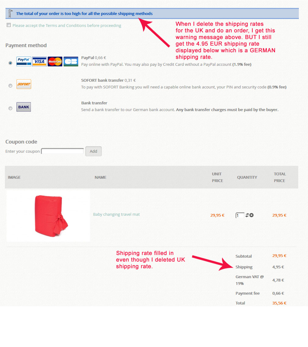

PROBLEM
There is a conflict in my shipping methods. The system always wants to give preference to shipping methods setup for Germany (on a UK and French website), even though the customer address is not in Germany. If for example I delete all shipping methods for the UK, the system will still offer shipping at 4.95 (German shipping rate). Please see image attached. I have changed the order of the shipping methods and this does nothing to help.
If I disable the German shipping rate, customers do not have a problem. However this is not a long term solution, as some users want to send products to Germany but order on the UK site. Please help.

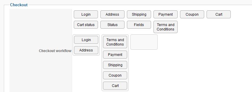

As you know I have quite a big problem where Hikashop will not auto-select a shipping rate and displays no warning messages when users try to move to the next checkout step (some users give up on their order here and occasionally orders are processed with wrong shipping values)
These problems are the combined result of my checkout work-flow, having multiple shipping methods (world wide delivery) and an issue with your system not saving the 'shipping address' to push this info through to the next step of checkout.
I will explain more:
- If a user registers for the first time and goes through checkout there is NO PROBLEM.
- If a user is already registered (repeat customer), then logs in, THERE IS A PROBLEM.
Both these above points are the result of hikashop not pushing through the address information to the next stage of checkout. Therefore, the system cannot auto-select shipping. I can however force the system to push my shipping details through to Step2 by switching between two shipping addresses on the 'Address' section of the work-flow. If I do this then there is no problem. But if I simply do a page refresh this will not work.
So the problem lies with hikashop not forcing the shipping info through to Step2 of my work flow. I like my 2 step work flow and have tried pretty much every other work flow unsuccessfully.

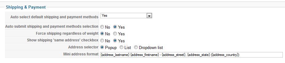

The shipping will be calculated automatically based on the "main zone" that you configured in your HikaShop configuration if the option "auto-select shipping and payment methods" of the configuration is turned on.
So an easily solution is to set the "main zone" to a place which is not a shipping/country zone or which doesn't have any shipping methods.
Another one is to turn off the "auto-select shipping and payment methods" of the configuration. Note that in that case, you won't see the change as the shipping will already have preselected in your user session. So you would have to reset your user session/try on another browser in order to see the new behavior.
