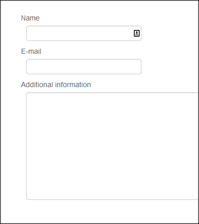

If I enable the "Contact us for more information" button in a product page, how can we make the fields of the form required?

Of which fields are you talking about exactly ?
  • Posts: 95
11 years 11 months ago #164213
I attached a printscreen. If you have enabled the "Contact us for more information" in a product , a contact form will be displayed. About that fields.
Thanks in advance
11 years 11 months ago #164222
If you have the latest version of HikaShop, these fields should be required.
