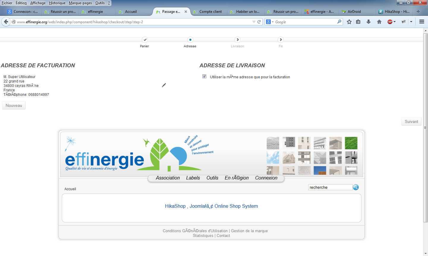

Hi!
I have a problem : when I buy something on my website without loggin before, when I log or create a user during the buying process, Hikashop display out of the template.
you can reproduce the phoblem here : try to buy something
www.effinergie.org/web/index.php/compone...-renovation?Itemid=0
thax
11 years 10 months ago #165309
Could you try to turn off the option "Use bootstrap" in Configuration > Display ?
  • Posts: 4
11 years 10 months ago #165385
Hi, and thank you for your answer, but "use bootstrap" was already turned off.
I found the origin of my problem : it is because i use the plugin "jfusion" which logs me on 2 Joomla website at the same time. if I deactivate its "user" extension, the problem disappear.
Do you think there is a hack i can use to solve my problem, cause I need jfusion?
thank you.
  • Posts: 85761
  • Thank you received: 14068
11 years 10 months ago #165440
It looks like an issue with output buffering where an extension is clearing too much or now enough the buffers it opens. It's hard to track down.
I don't see why JFusion would do that and I don't know the code of JFusion at all. The best would be to ask them.
