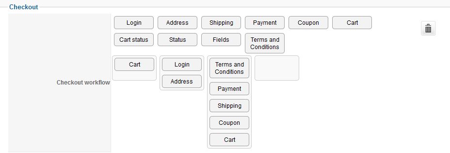

10 years 2 months ago #235001
Hi folks,
I'm running into a same sort of problem / question.
We have 2 options for shipping.
1. Ensured shipping (€20,95) based on a warehouse
2. Delivery with installation service (price is based on state / province)
The 2nd option gets visible after a customer has filled in all of the information.
Isn't it possible to show the field by default and gets calculated / changed when the State / province field is changed? Or a separate button to calculate?
10 years 2 months ago #235011
Your second option seems to be available only if you have filled all your customer informations (shipping address), so a solution can just be to add an "Address" step before your "Shipping" step, so that your 2nd shipping method will always be displayed with the correct price.

  • Posts: 44
10 years 2 months ago #235250
Ok, I figured it out :)
But, I don't want customers to fill in the complete address form, before they see the shipping option.
That's not a solution :( The shipping method is based on 1 thing, the Province. A customer needs to know the shipping costs before registering. Otherwise we lose customers.

  • Posts: 44
10 years 1 month ago #238119
I think I figured out a sort of work/around, but missing something :P
When I use the advanced workflow edition, I'd like to place only the Zip / Post code field before the other fields,
so a customer needs a short time of effort to fill in the post code, afterwards, the system should show / log
this field and the custom field would be calculated.
So, the main question here is, how can I place a custom field (not the complete address package) in
the advanced workflow edition? I really think many customers could use such a thing (there are many things to
calculate / check before the actual checkout)
Hielke
