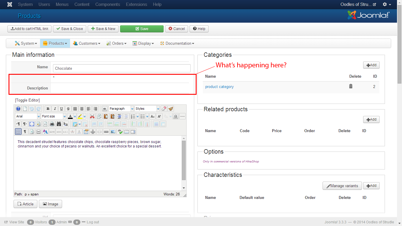

-- url of the page with the problem -- : oodlesofstrudel.com/administrator/index....roduct&task=edit&cid []=2
-- Joomla version -- : 3.3.3
-- PHP version -- : 5.3
Please see this image:
There is no box to enter Description.
Last edit: 11 years 10 months ago by mindspyder.
  • Posts: 26355
  • Thank you received: 4068
11 years 10 months ago #166058
The description box is just below, with the content "This decadent strudel...".
  • Posts: 14
11 years 10 months ago #166091
Ahh... that's a tad confusing. What if I want a short description for the product listing page and a longer description for the product detail page?
11 years 10 months ago #166096
You need to use the readmore button, a plugin needs to be enabled, the plugin "Button - Readmore" of the type "editors-xtd".
Then in the description, put your cursor at the desired place, and press the button "Readmore" this way the text will have a short part for the listings and a long part for the product detail page.
