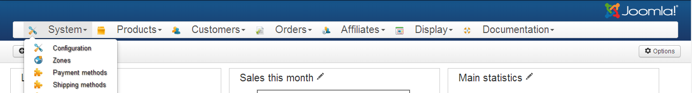

Hi there,
I recently copied my configuration from a 1.5 site running the latest version of Hika to another one, upon installation I discovered the layout of Hikashop was wrong. I tried uninstalling and re-installing the component but this didn't help.

11 years 10 months ago #167452
www.hikashop.com/support/support/documen...html#display_general
