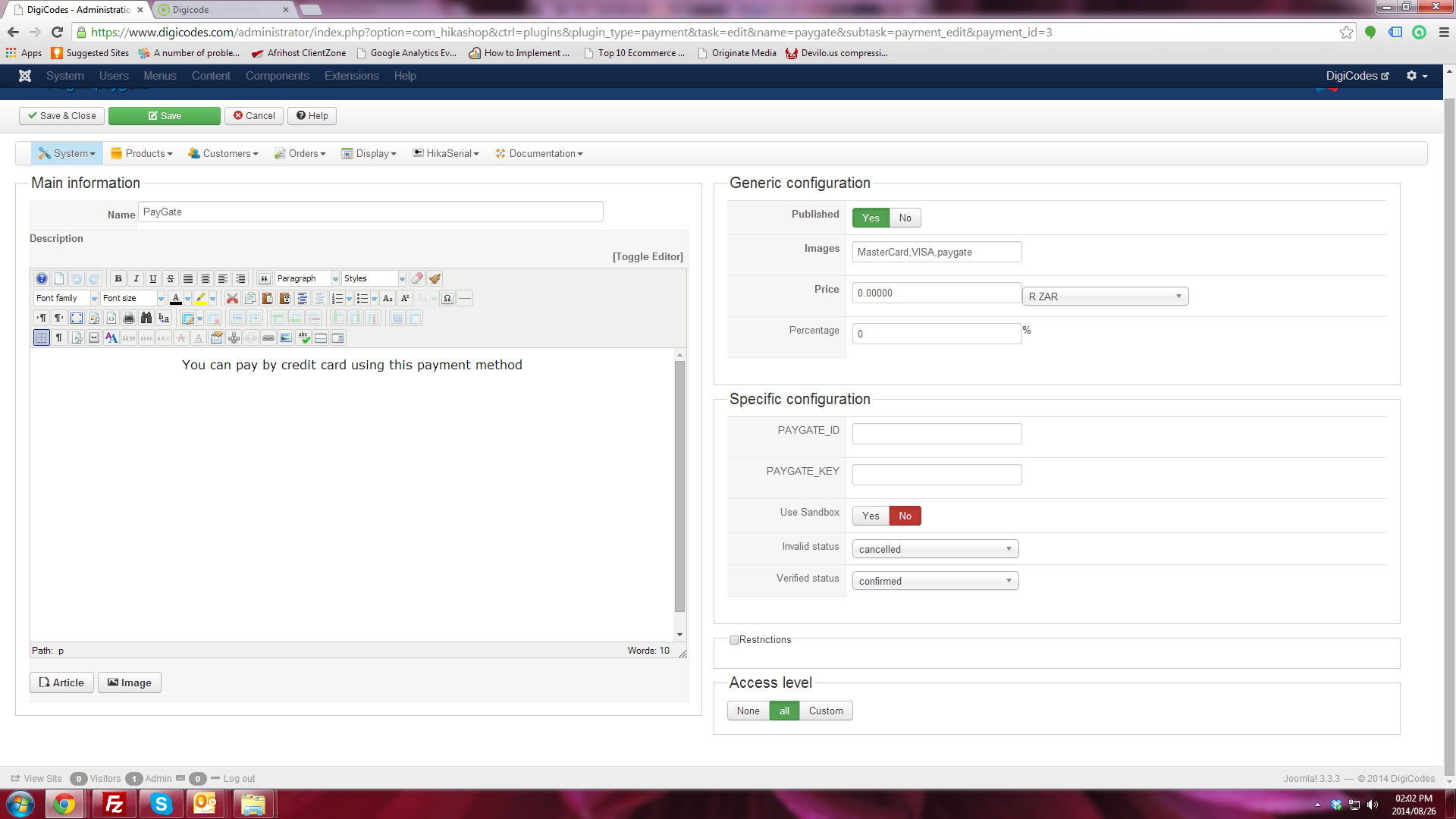

11 years 10 months ago #168349
Can you give us a screenshot of this payment method settings ?
  • Posts: 152
  • Hikashop Essential
11 years 9 months ago #168974
Hi Xavier,
I'm upgrading the Hikashop software to the latest version to see if that makes any difference. But at the moment - here is a screenshot of the settings:
Nope still doing the same thing... Its not sending out a confirmation email - from the site with the Hika serial attachment in the HIka HTML
