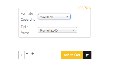

Good Morning,
how can I cambare the words Add To Car? I looked in the files in the language but I have not found it.
thanks

hello,
I had already looked at, but frankly I have not found anything.
I attach my files can you give us a look please?
Thanks so much

It's one of the first lines in your translation files:
ADD_TO_CART="Aggiungi al Carrello"
ADD_TO_CART="Add Aggiungi alla tua configurazione"
So it seems that you already did the change in your main language files. Make sure that you also do the change in the override area of the translation files as explained in the documentation.
