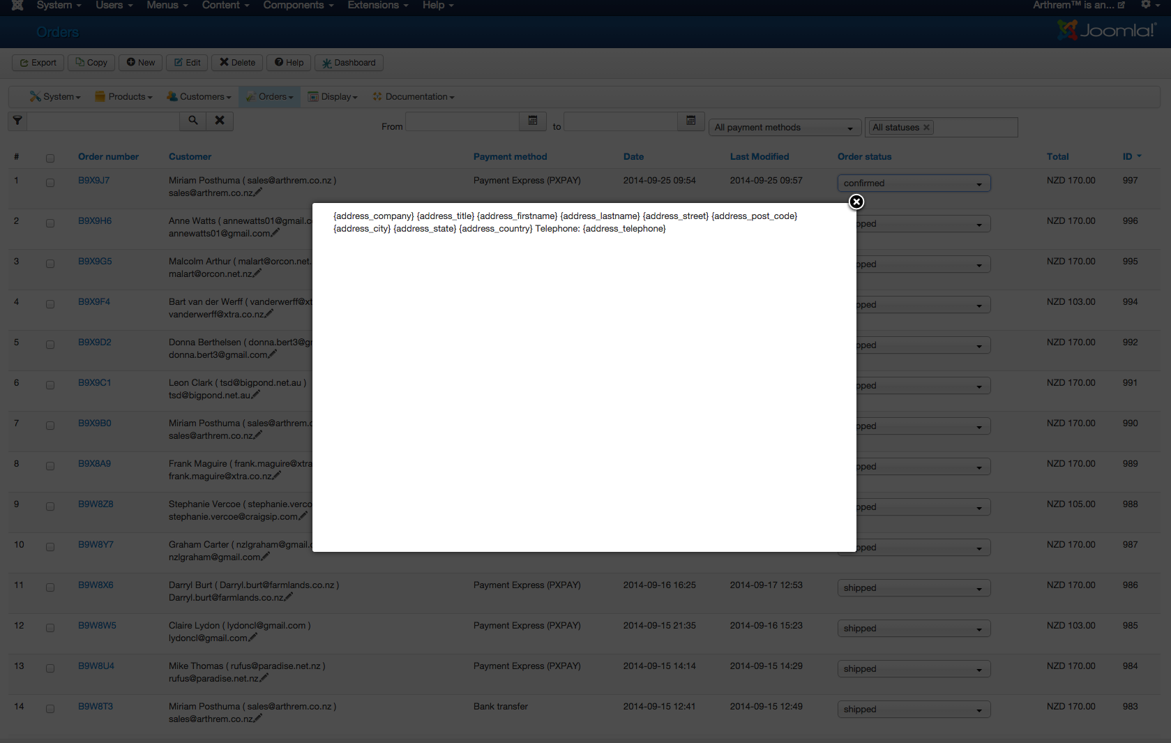

-- Joomla version -- : 3.3.4
-- PHP version -- : 5.4.26
-- Browser(s) name and version -- : n/a

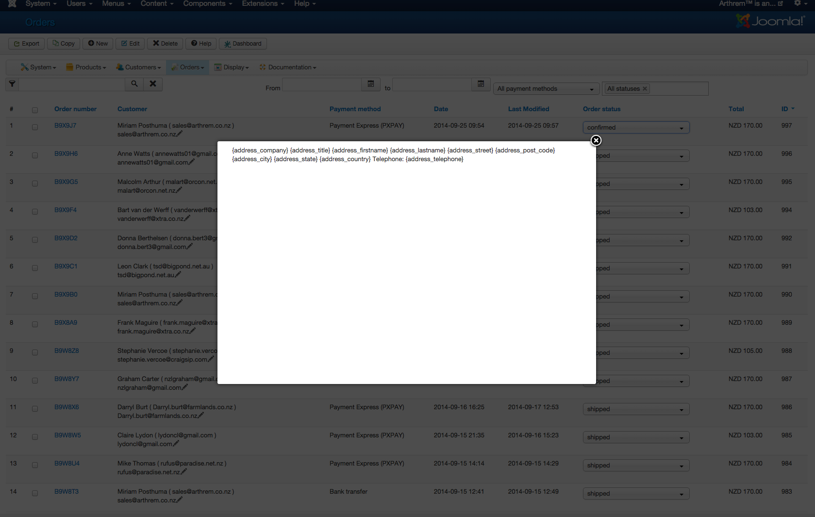

After Update to 2.3.3, Cannot Change the Order Status.
The pop-up window just gives gibberish instead of usual window.
See screenshot.
All caches have been cleared.
Last edit: 11 years 11 months ago by MSTACE.
  • Posts: 26387
  • Thank you received: 4078
11 years 11 months ago #172976
1. See : www.hikashop.com/forum/orders-management...r-update.html#172850
2. Please re-download HikaShop 2.3.3 to get the Joomla 3.3.4 patch.

  • Posts: 293
  • Thank you received: 9
11 years 11 months ago #172983
I did the manual patch as per your post.
That worked fine.
Thanks.

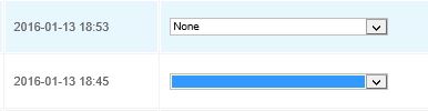

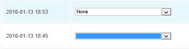

  • Posts: 29
10 years 8 months ago #226525
Hello!
I have updated hikashop to 2.6.1.
I was unable to change the order status.
Refer to the picture to see what it looks like when i change to any of the statuses.
  • Posts: 26387
10 years 8 months ago #226539
You're not in the right topic.
Your issue is related to a Joomla 3.4.4 - 3.4.8 bug.
You should use "vex" popup to fix that issue or patch your Joomla.
www.hikashop.com/support/documentation/3...-hikashop-2-6-1.html
