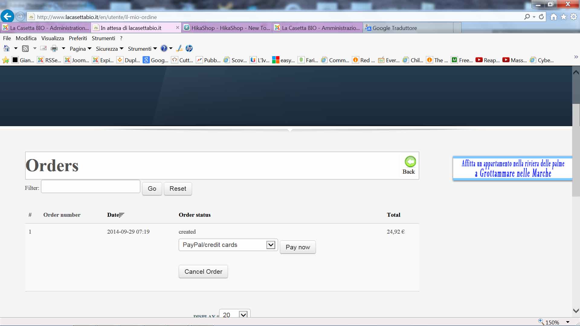

-- url of the page with the problem -- : www.lacasettabio.it
-- Joomla version -- : 2.5.24

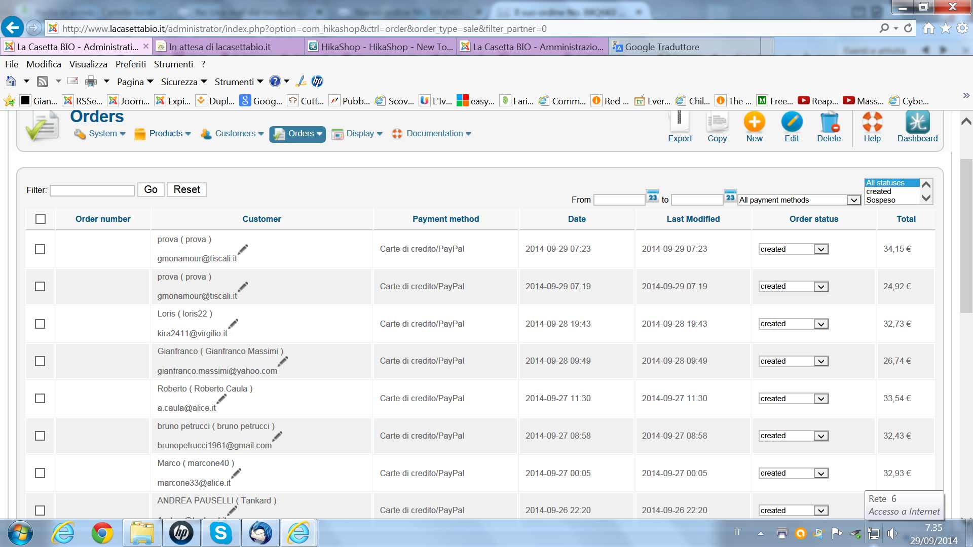

after i updated to new version 2.3.3 i had a serious issue:
on my back-end order management i have all the orders without the number. That block me to manage them.
Also from front-end order management the "cacel order" button does not work.
Also again at the end of the ceck-out, with paypal payment, the site block it and the client can not go to paypal site.
Please, Help me soon!!

11 years 11 months ago #173554
We are already aware of the problem, there iis already a thread which talk about and we already found the solution.
The problem is coming from : Falang 1.4.2
The problem is that HikaShop call a function "lastInsertId" in order to get the order_id just created in the database but for the unknown reason, the function does not return the inserted id anymore ; due to falang.
Please deactivate the "falang driver" system plugin and it will work again.
For more details, please see with the Falang support.

11 years 11 months ago #173692
Yes you can do that via our mass actions, in the "order" data part you can filter on empty order numbers and in the actions "display the results", then check order_id and order_number columns.
Finally in the displayed table you can directly edit the rows in order to fill them with the desired value.
