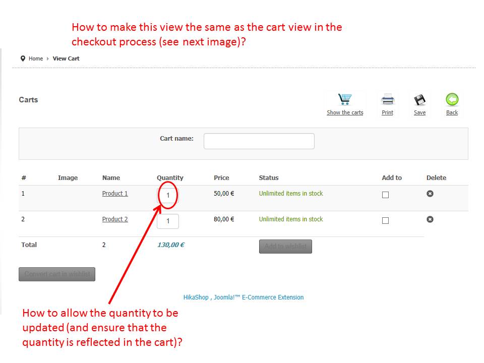

-- Joomla version -- : 3.3.6
Hello, there.
Good evening!

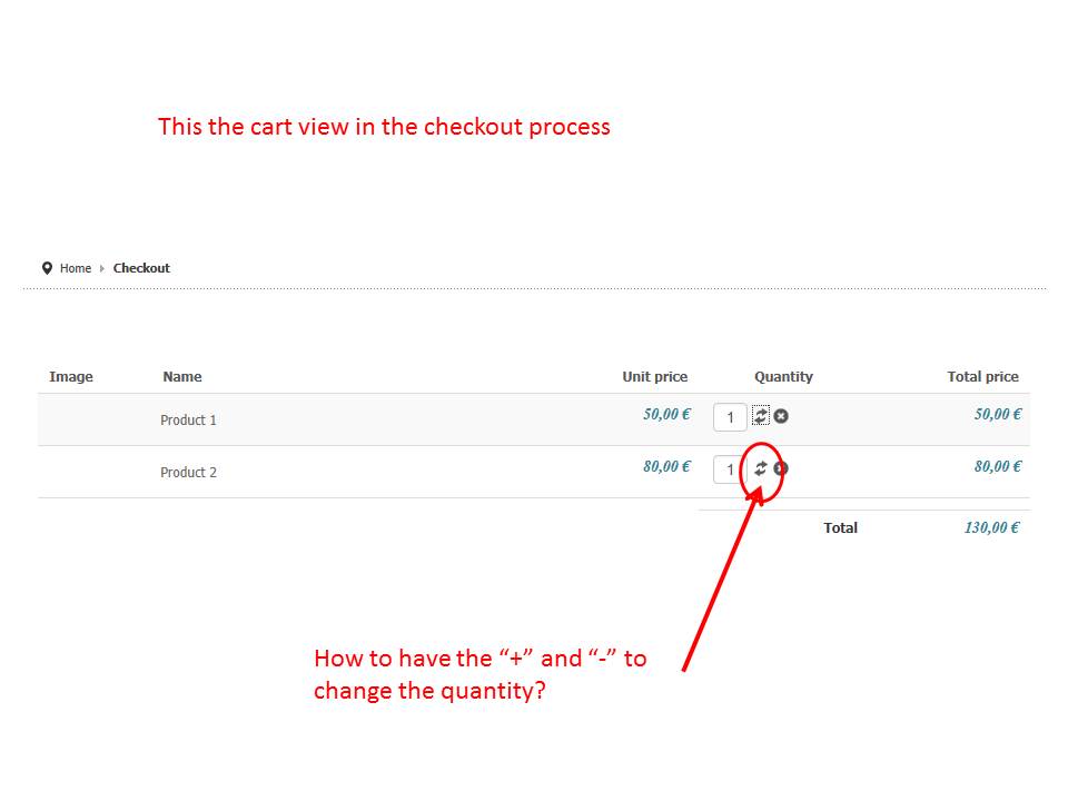

I have 2 questions in the same area:
1) a) please could you let me know how I can customise the "View Cart" display to be identical to the "Cart View" in the Checkout process?
b) in the "View Cart" display, how to allow the customer to update the quantity (by keying it in and by and also having the "+" and "-" symbols - see question 2) below)?
2) in the "Cart View" in the Checkout process, how to have the "+" and "-" to update the quantity?
Thanks.
Take care!
11 years 10 months ago #175478
To edit the layout of the "View Cart" you have to edit the view "cart / showcart" via the menu Display > Views.
For the cart in the checkout, it's the view "checkout / cart".
Here is documentation to customize the display:
hikashop.com/support/support/documentati...ize-the-display.html
To add the "+" "-", it will require html to add the symbols and JavaScript to update and submit the form to save the changes, so Javascript knowledges are required.
  • Posts: 109
  • Thank you received: 5
11 years 10 months ago #175962
Hello, Xavier.
Good evening!
I want the "View Cart" table to look and behave exactly like the Cart in the Checkout view; i.e. have the same columns and the content of the columns to look and behave identically.
What is the quickest way to achieve this? I tried to copy "checkout/cart.php" to "cart/showcart.php" but (obviously) it didn't work.
What needs to be done after copying "checkout/cart.php" to "cart/showcart.php" to make it work?
The reason I am trying to do this is to minimise duplication of work. I had hitherto started moving columns and then discovered that the unit price display in both views are different when multi-currency is involved; i.e. "checkout/cart.php" displays both currencies and "cart/showcart.php" doesn't.
Please could you let me know what needs to be done to after copying checkout/cart.php to cart/showcart.php?
Thanks.
Take care!

  • Posts: 109
11 years 10 months ago #176105
Hello, Mohamed Thelji.
Good evening!
Thanks for your reply. I am not just referring to the problem of the "+", "-" symbols. Those symbols are neither present in the "View Cart" nor the "Cart in the Checkout" display. I will have to add them as Xavier suggested to both of these views.
The main point I was trying to address is that these two views are distinctly different. I wonder why they have to be so different. Not just in terms of the look and feel but also in the underlying code.
So, for the requirements for someone like me who wants the two cart displays to be in sync, one has to duplicate a lot of code (and in doing so, figure out how to do it). I am not strong on php and can just about figure my way around (with a lot of effort).
The points I am raising (in order to sync the "View Cart" and "Cart in the Checkout" views are:
a) moving colums about for these 2 views to be in sync (this I can do)
b) style the contents (e.g. one set of headers are in bold and the other not while some contents are in italics and others not) (these I can do)
c) ensure the column headers have the same text (this I can do)
d) allow the user to update the quantity column in the "View Cart" display (this is allowed in the "Cart in the Checkout" view) - I can't seem to get this to work yet and may need help
e) display the Unit Price and Total Price in default and selected currencies (one view displays this and the other doesn't) - I need help with this
Seeing that there are a few discrepancies between both views, I thought the best way is to be able to copy the "checkout/cart.php" on the "cart/showcart.php" file and make some modifications to get it to work.
If you think this is not the best solution, please could you help me with the code for d) and e) above?
Thanks.
Take care!
  • Posts: 86091
  • Thank you received: 14196
11 years 10 months ago #176125
Thank you for your feedback. We'll take your suggestions into account in order to make both views more consistent.
Copying the code from one view to the other is not a good idea. Both were not made for the same purpose. You'll break the view if you do that. The cart/showcart view file is to display a cart but also a wishlist, so it has extra code to handle both and to add additional fields. It also has to handle the form submission while the checkout/cart view has been made to be used inside the checkout.
Instead, modifying the cart/showcart.php view file so that it behaves more like the checkout/cart.php is what I recommend, like Mohamed said.
Regarding the quantity change not working, this is a bug of the current version. It will be fixed with next version to be released in a few days.
Regarding the price issue, I must say that I'm not familiar with the cart/showcart view so I don't know.
I'll assign this thread to Xavier so that he can answer you at the beginning of the week since he is the specialist of this matter.
The following user(s) said Thank You: Ed_Hika
11 years 10 months ago #176188
I just edited the "cart/showcart" view and added another one for the price in order to have the same display than the cart in the checkout.
Now the columns have the same ordering, there is unit price and total price present, the quantity can be updated by clicking on a refresh button just next to the quantity field and a delete button is present.
So please wait until the next release to have this new version of the view. :)
