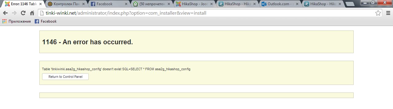

-- Error-message(debug-mod must be tuned on) -- : 1146 - An error has occurred.
Table 'tinkiwinki.asa2g_hikashop_config' doesn't exist SQL=SELECT * FROM asa2g_hikashop_config
I was install and uninstall HikaShop. Now i want to install it again, and here come the error and i can''t install it!
Hy there,

Please check that you have the rights to create tables in your Mysql server.
It looks like the install did not create the SQL tables properly ; so you will have to create them manually using the "tables.sql" file in the HikaShop package (under the "back" folder).
Please note that Joomla is executing the SQL script during the installation and not HikaShop ; same thing for the re-install process where Joomla is not executing the SQL script if the component already exists.
You can read more about installations issues here :
www.hikashop.com/support/support/documen...-install.html#errors
