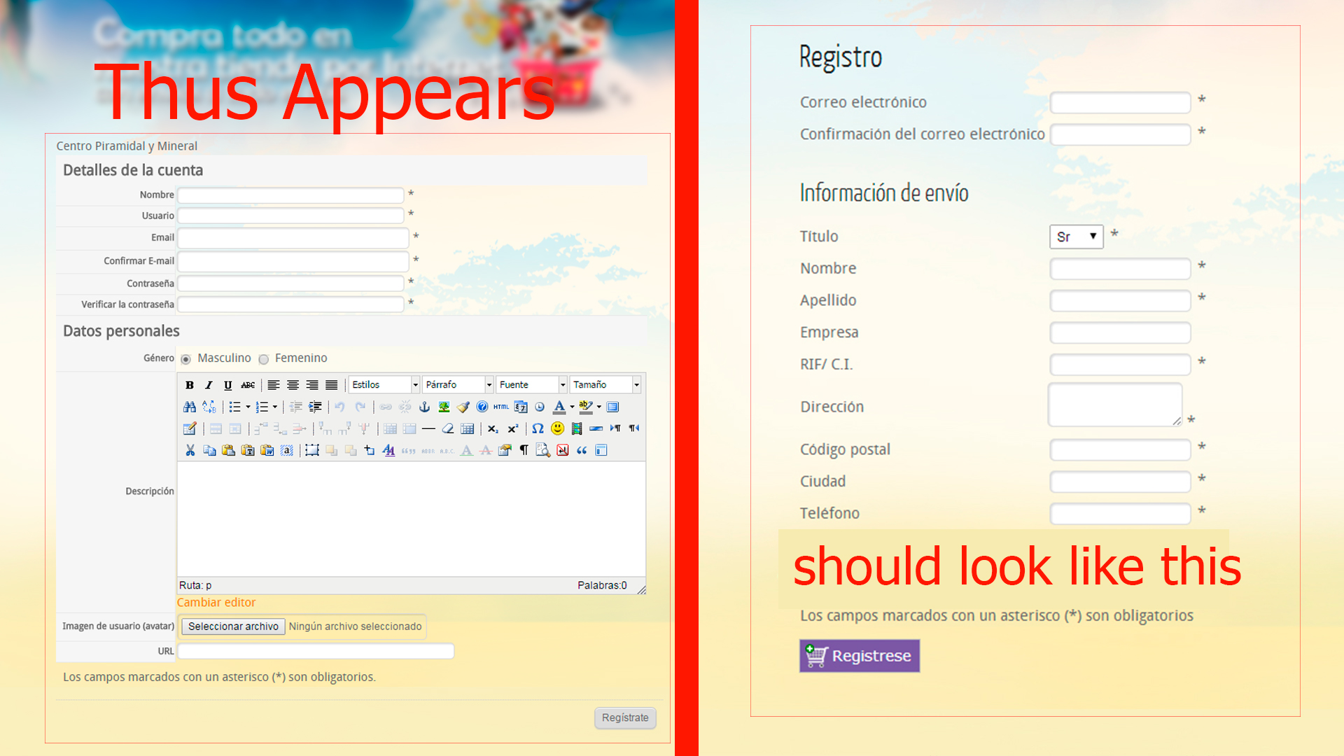

11 years 7 months ago #178022
Now update the system again and is well on the checkout, I no longer have the loop, but for user registration, it appears to me, default template of joomla and not to HikaShop, and reCapchat not appear, not allowing me to registration . :S

  • Posts: 13
11 years 7 months ago #178406
Does not look like should the form and calls for a ReCaptcha who is disabled and who do not use this form for registration
Attached photo of the look and how it should be seen
productosnuevaera.com/
Productos Nueva Era | Un Mundo de Regalos Místico para ti

@nuevaera
The system plugin "hikashop registration" which redirect the Joomla registration page to the HikaShop one got some errors that should be all fixed now.
We updated the package so you can re-download HikaShop 2.3.4 to get the modifications.
