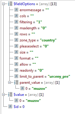

For field types Checkbox and Multiple Dropdown $value is indexed array, therefore $id is 0 and call to
hikashop_secureField() with integer argument results in die().

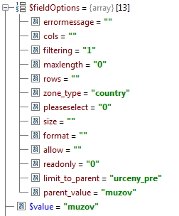

Here is var_dump($fieldOptions) for field type dropdown
and var_dump($fieldOptions, $value) for field type Checkbox.
