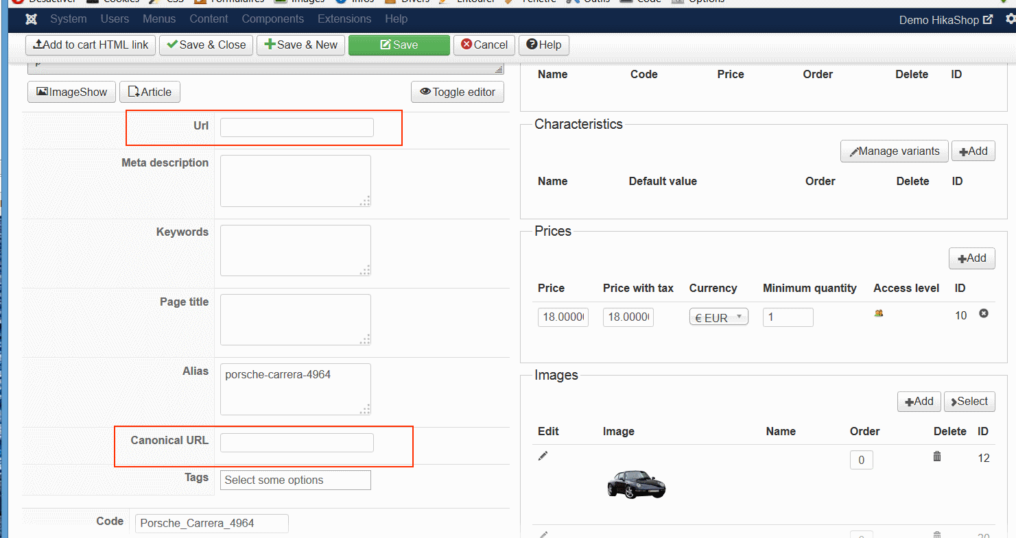

the main URL is the URL you want search engine to index .
search engine (robot) analyze URL and ll see that many differents URL go to the same content .
you ca ncreat many link to the same product ! So among the URL joomla generate for you in the FrontEnd ; you ll need to define which you want to be the main url= canonicalurl ( <link rel="canonicalurl" href=""> in the FrontEnd )
see in HKS demo page
I copy the documentation for URL and caninocal URL from the documentation install with hikashop .
Url : The url of the product is a url to the manufacturer website in order to get more information for your customers. This url, if filled in, will be displayed on the product page.
Canonical URL : You can enter here the main URL of the product which will be declared as the "canonical" URL of the page to Google and other search engines. That will help you avoid duplicate URL issues with several links going to the same product page due to the nature of Joomla. You can enter either the full URL or only the URL starting from the first slash after the website's main URL.
Google don't like url with id=value so best url "format" :
SEF SEO OK static www.somesites.com/forums/the-challenges-of-dynamic-urls.htm
CMS BAD dynamic www.somesites.com/forums/thread.php?threadid=12345&sort=date
CMS can manage many format in diferent location ( core extension component BE )
Even if product is create ; the url of product don't exist if you don't create a web page that show the product and for acces to this page you ll need a link somewhere . Think of a menu that contain many links that goes to the same products . So many url ( hide behind a link name) can be differents but go to the same product content can have differents URL .All search engine after parse all url links compute the information to group the url by content page . Inside this group of url , it must find in one of them one ( only ) canonical url define in html by code <a rel="canonical" href="url1">link name </a> . The others links in the same group don't have rel="canonical" . url1 is the canonical url .
see
demo.hikashop.com/administrator/index.ph...ctrl=config#features
demo.hikashop.com/administrator/index.ph...roduct&task=edit&cid []=10
www.hikashop.com/forum/4-how-to/53780-av...que-product-url.html
Joomla has many problems for manage URL for a point of view of php developpers .... it could be better but lle be resolve in next joomla version (so SEF tool could be usefull now depend of quality of components implementation ) . I think absolute url ll be better than relative url ! .
I think write nothing wrong !!
Last edit: 11 years 8 months ago by lionel75.
