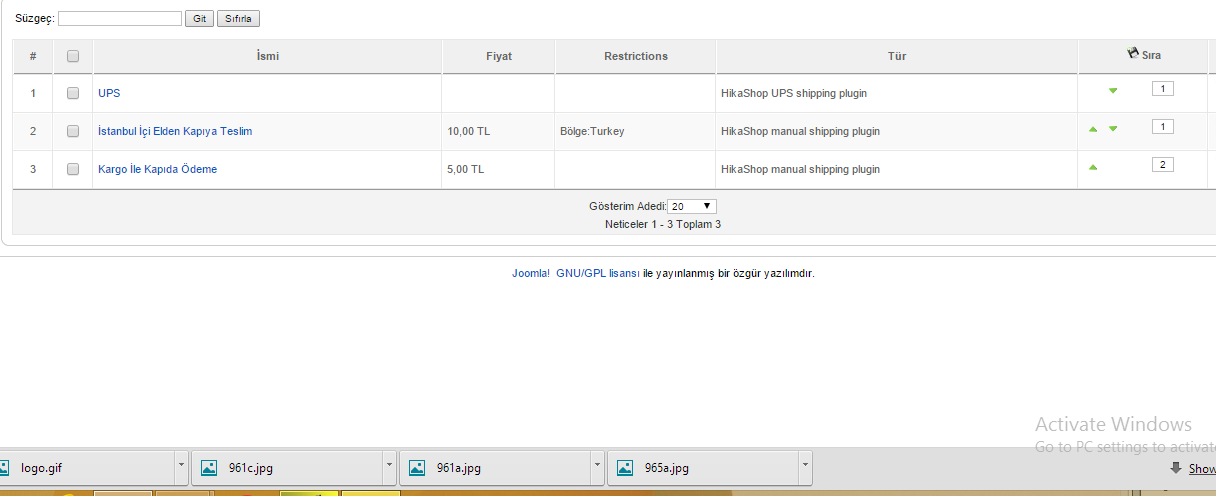

shipping methods not seeking in checkout page? what is the problem?

ok i adjusted munual shipping but there no any shipping methods in frontend

Ok so if you just don't see any of your shipping method through your checkout workflow and face a "shipping method not found" error message, you should firstly follow the "Shipping methods" section of the FAQ : www.hikashop.com/support/faq.html

Your issue is probably coming from the fact that you didn't set any weight/dimensions on your product configuration page.
  • Posts: 182
11 years 6 months ago #190866
i dont need weight/dimensions.. is it requied?
11 years 6 months ago #190869
As it's said on the "Shipping methods" section of the FAQ :
5) Check that your products have a weight, otherwise, the system won't display any shipping methods as it will consider the products as virtual goods.
If you don't want to add any weight, you'll have to set the "Force shipping regardless of weight" option to YES through "Hikashop->System->Configuration->Checkout".
