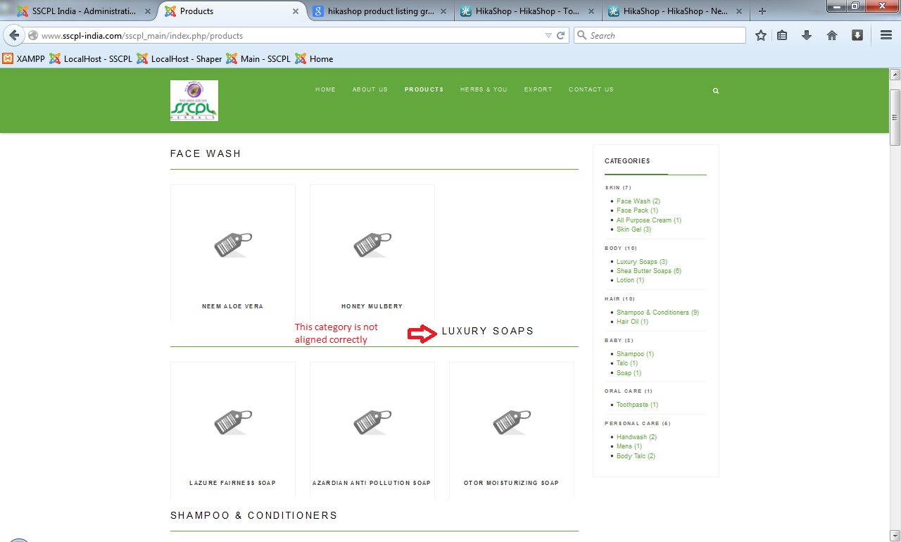

I have a problem with the layout on the product listing page that are grouped by categories
I have attached a screenshot of the problem. As you can seen the category "Luxury Soaps" is not aligned correctly. This happens only when the previous category does not have products that are multiple of 3
How can this be resolved.

Attaching the working link
www.sscpl-india.com/sscpl_main/index.php/products
As you can see category "Luxury Soaps" is not aligned correctly
~Sanket

Add the CSS below on your website and it should help:
.hikashop_category_information h2{clear: both !important; }
