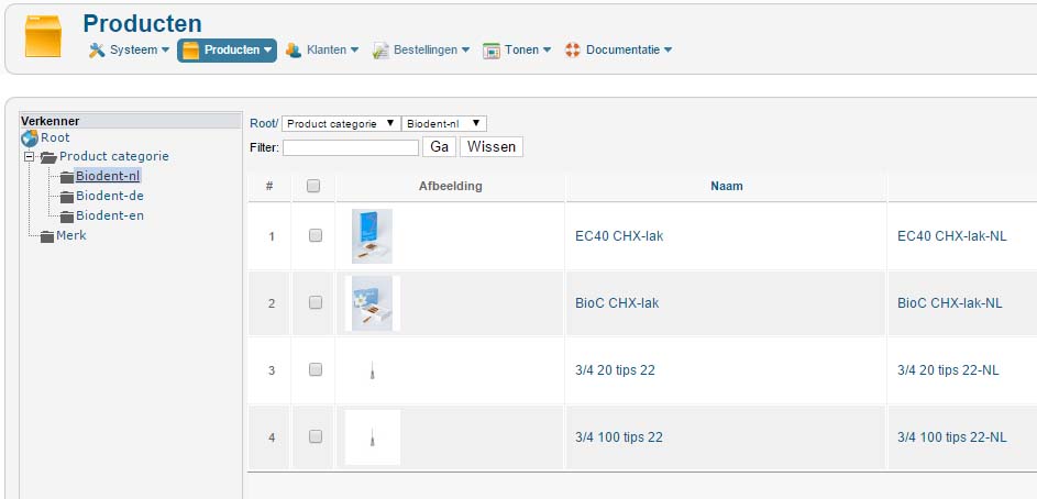

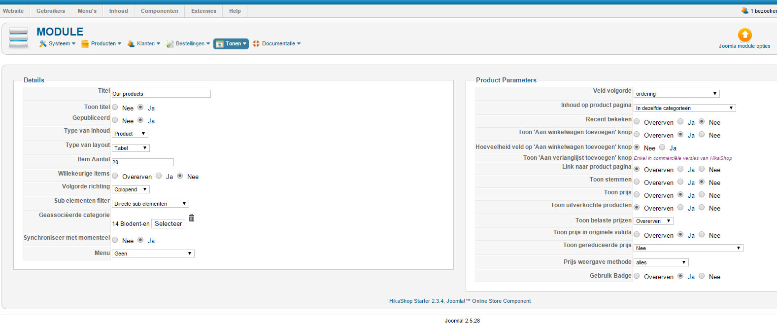

www.biodent.nl is a 3-language site. Products are sold in Holland, the UK and Germany. Main-language is Dutch. I made 3 categories (see attachement 1). Each categorie contains the same 4 (translated) products. Each categorie is linked to the menu-items 'Bestellen' (dutch), 'Bestellung' (German) and 'Order' (English). See attachement 2.
