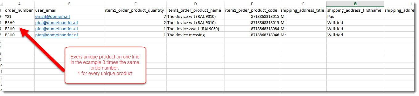

I am wondering if it is possible to have one line per unique ordered product.now all the unique products are on the same line with item1_order_product... as head and the following item1_order_product...
In the new situation you would have item_order_product... and on every line a unique product starting with the same order number. The name, address should also be on every line for that order.
