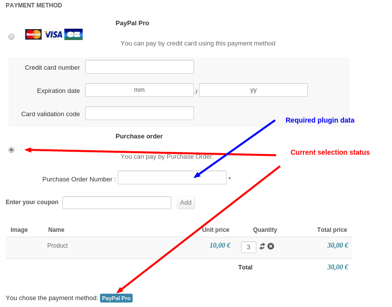

  • Posts: 45
11 years 7 months ago #188157
Dear Jerome,
Your account has been enabled now. Sorry for the inconvenience.
A screenshot showing the plugin data is attached.
Thanks and regards, Paul

  • Posts: 45
11 years 7 months ago #188792
Dear Nicolas,
Thanks you for your reply.
I think I understand your concern that lead to the decision of disabling the auto submit. However, the current behavior is not particularly user friendly.
I play the following story:
  1. I select my product, which brings me to the checkout page.
  2. I log in or register myself
  3. I select Purchase order as payment method. Now, the radio button in front of Purchase order is selected, and the field for the Purchase Order Number appears. Note, that the status at the bottom still shows PayPalPro as payment method.
  4. I enter a Purchase Order Number and press the Finish button. I end up at the same screen (step-1), and the purchase order number is erased. However, the status at the bottom reports now that the payment method is now set to Purchase order.
  5. re-entering the Purchase Order Number allows me to finish the checkout
Is this the expected behavior? What can I do to optimize this story?
