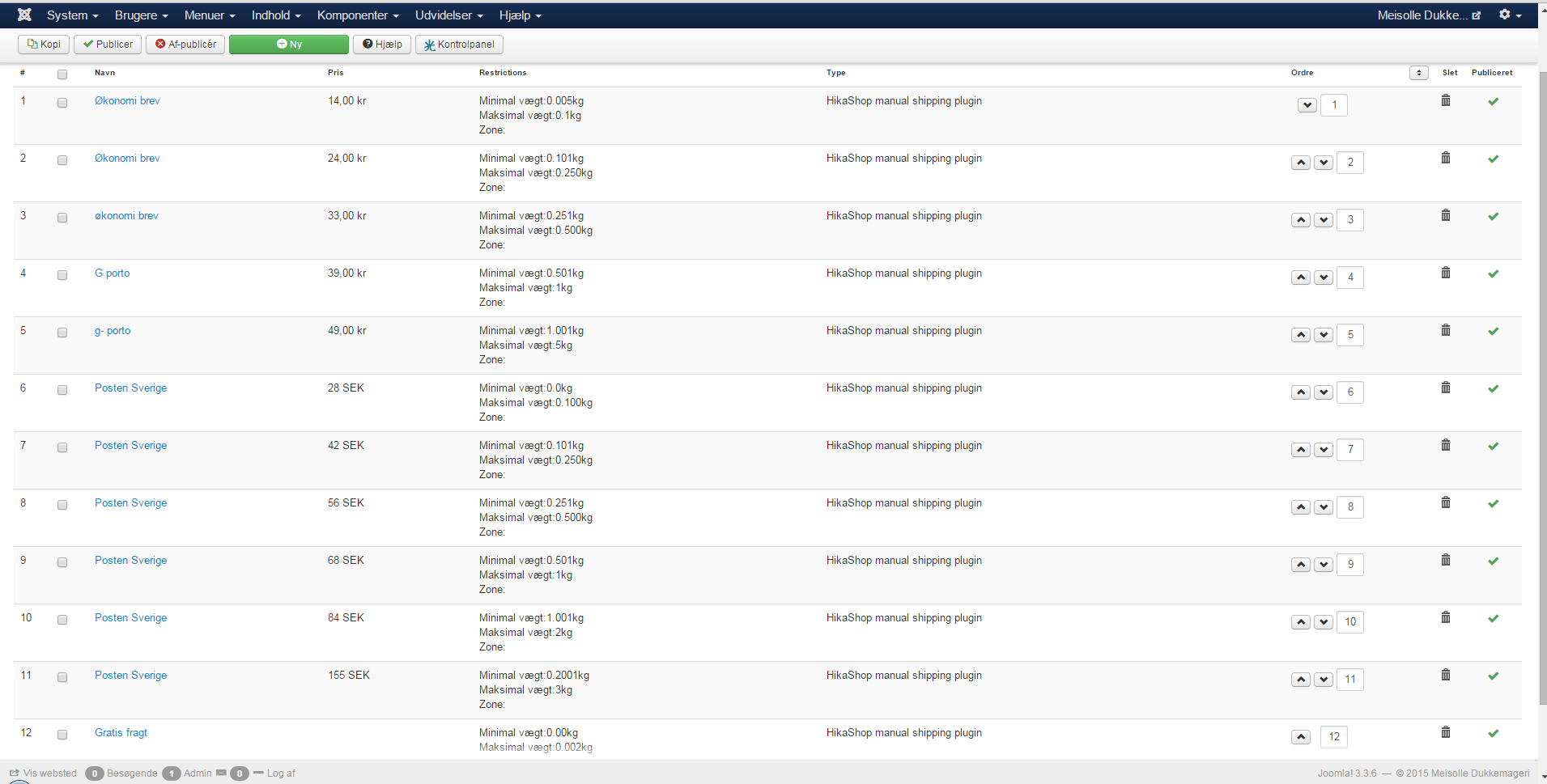

  • Posts: 75
11 years 6 months ago #189453
The problem is back :( so I guess it was never gone, just this time it is when I choose Sweden.
here is a screenshot of all.
/Christina
  • Posts: 75
11 years 6 months ago #189455
I sell to Sweden and Denmark. the first five is shipping in Denmark, you don't see the zone for some reason, but they are threre.
I wonder how the shipping is decited, in checkout? How does Hikashop know the shipping costs before the customer even has wrote his adress?
Every time I put something in the basket it is allways danish shipping that is showing. I am sure I messed up there somehow.
/Christina
  • Posts: 75
11 years 6 months ago #189459
I finally found the solution.
When I first config. Hikashop I had 2 valutas, later I changed it to use only 1. Just I forgot to change the valuta for each shipping metod, it was still set to the one I had upublished.
So now when I changed back to the one that was published, it works jayyy
/Christina
