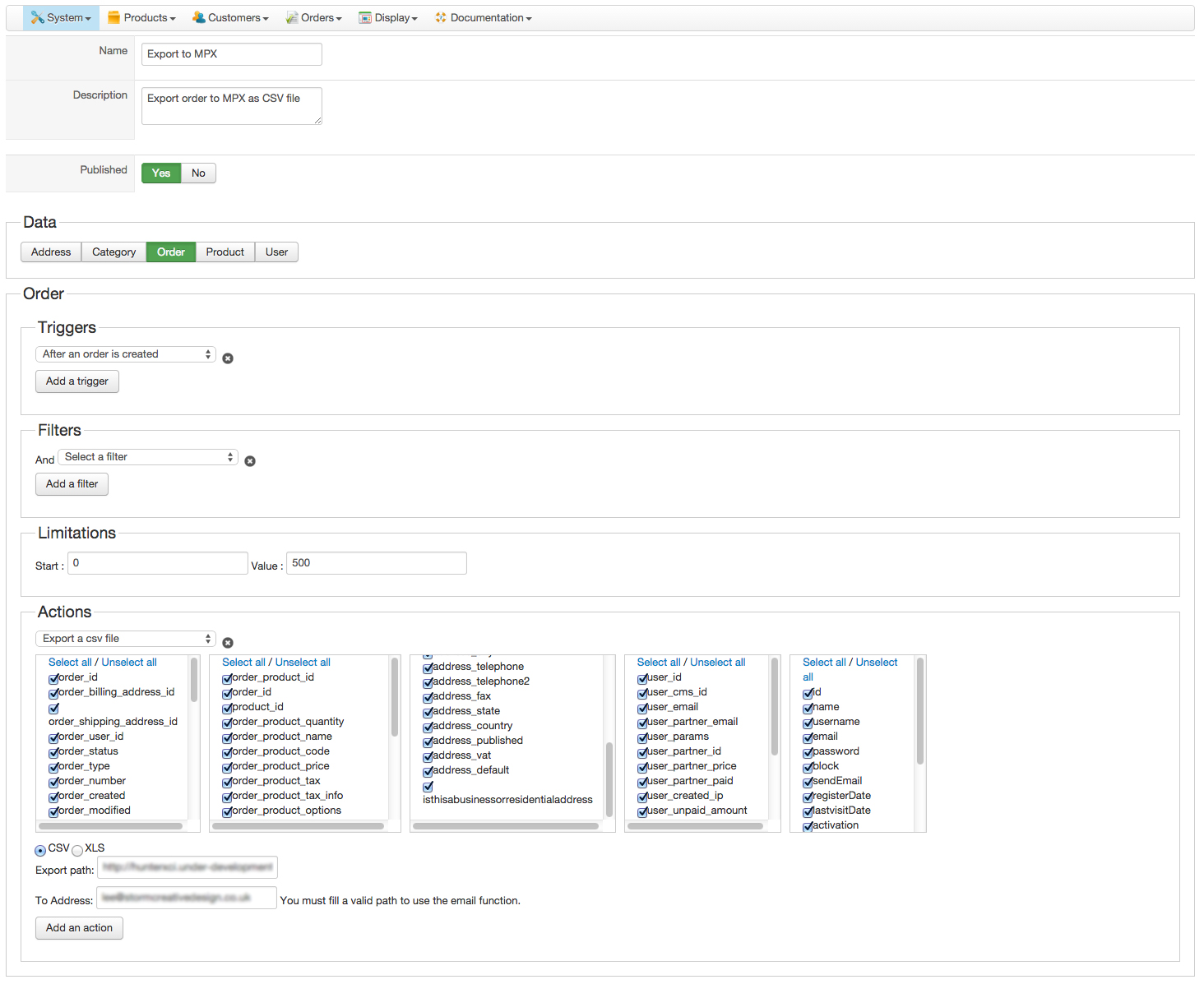

However I have setup a mass action to save a CSV file and email a copy but it does not appear to run when an order is created. Attached is a screenshot of my setup. Can you please review and tell me how I can get this to process everytime an order is placed.
Whats should the folder path look like is it the website url:
www.someurl.com/csv/
or does it need to be a server path?
thank you.
Lee

11 years 7 months ago #188574
This mass action must work every time an order is created.
Please check if there is no other plugin called which could interract, or try to use the "After an order is updated" and filter on the order status.
